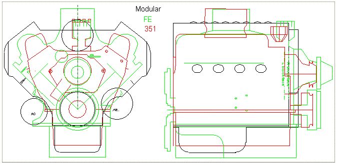

Don, here's a cross section pic which may be helpful for comparison. Yes, that's a big engine dimensionally speaking.

Thanks guys, I have now found that Mark, late of MGD is now doing the very part that I require, but thanks for the input.:laugh:
