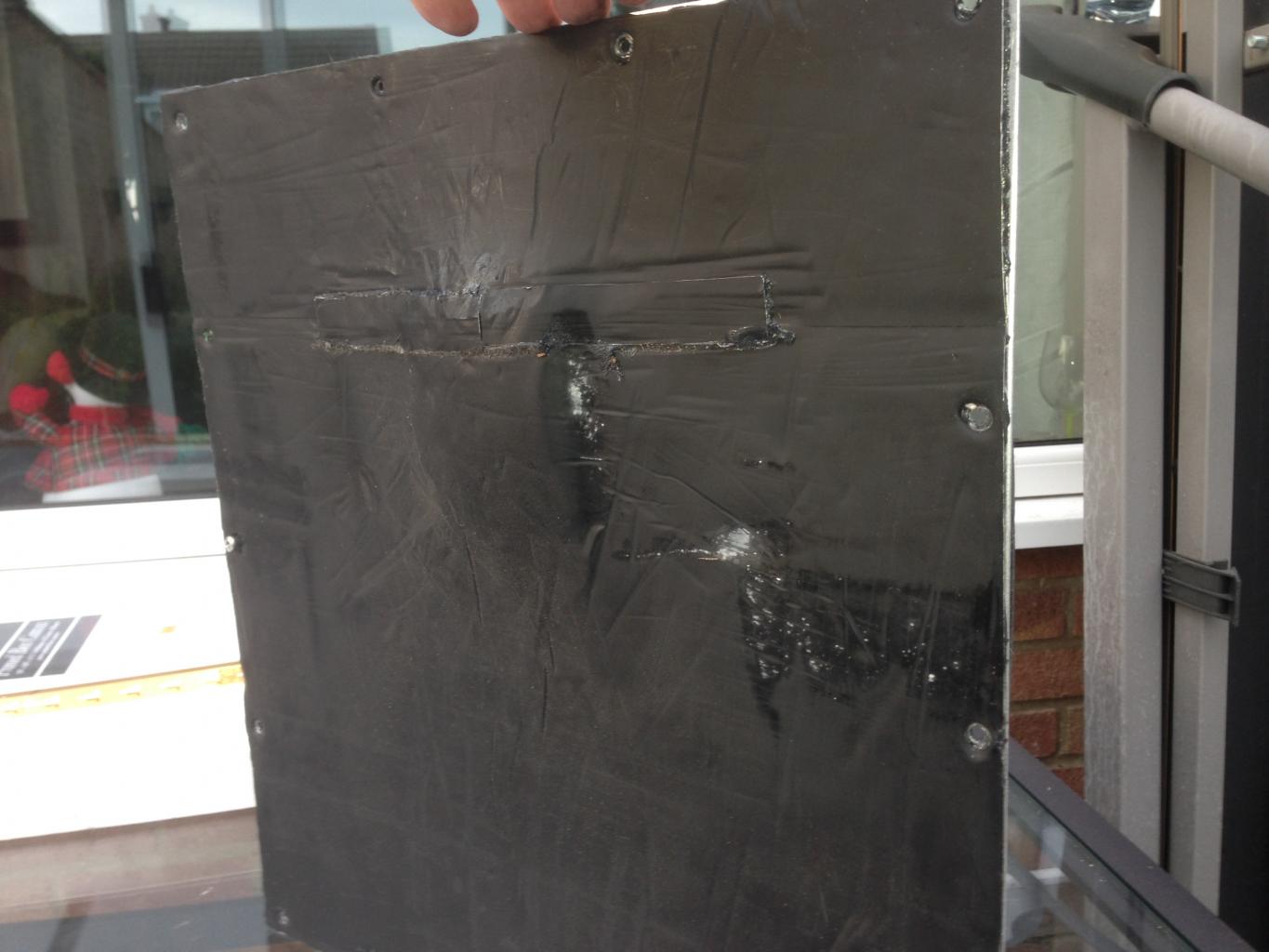

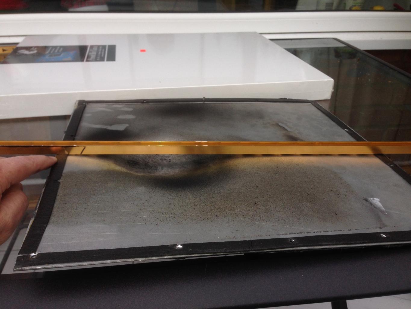

I made a bulge in a flat piece of aluminium
Flat sheet placed on the cushion of my daughters trampoline
Attacked it gently with a hammer and it slowly formed the bulge I required to clear the pulley.
Only took a few minutes with a few trial fits in the process
A sand bag or similar would probably be the correct thing to hold the sheet against but I used what was standing in the back garden

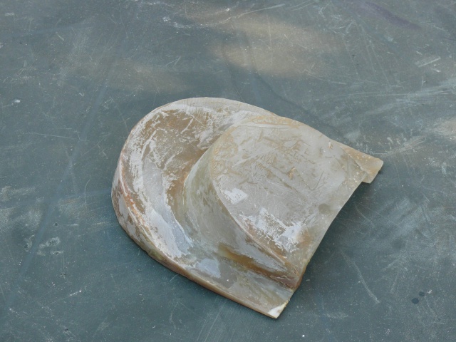

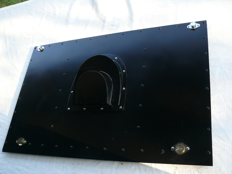

Don't know if it's the best or easiest way, but did mine with a cardboard template. Dressed the inside with some brown packing tape, and fiberglassed it.
Needed some sanding and slight modification, but eventually, I ended with something I found acceptable... (and cheap !)

It was a presized and pre drilled aluminium sheet.
I guess I was just lucky the holes still lined up after I beat the piece up with a hammer. :thumbsup::thumbsup:
As it is now covered with sound deadening, which was a much bigger problem I cannot even take a decent photo of it
