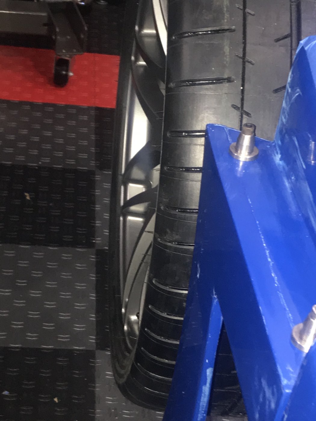

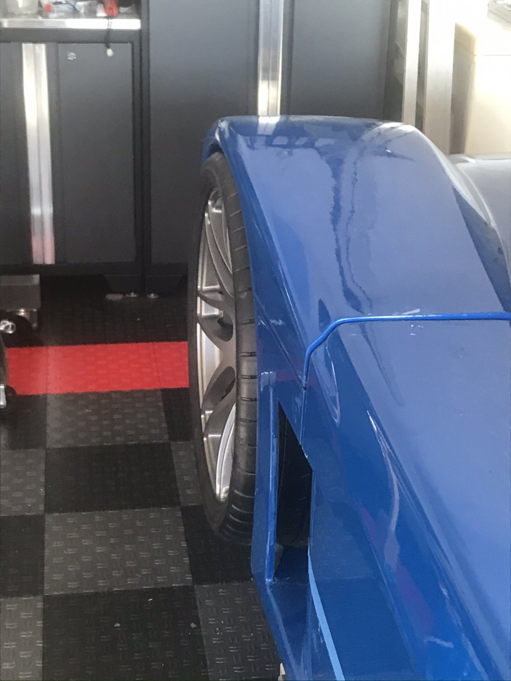

Here is a pic with the top fenders on...
A pic from behind the tire....
Joel K
I took some measurements with the tire on.
Tire width = 11.4”
Midpoint = 5.2”
Distance from back of tire to flange 4.625”
Backspacing = .575”or 15mm
My hunch is the run flat tires I have sit out and over the rim quite a bit.

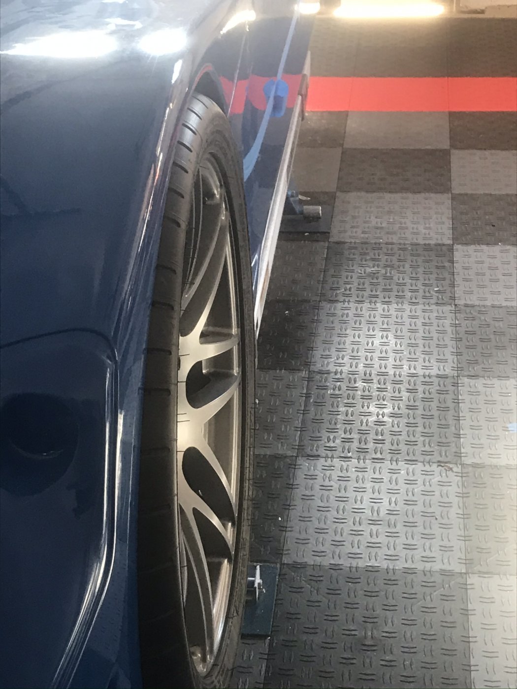

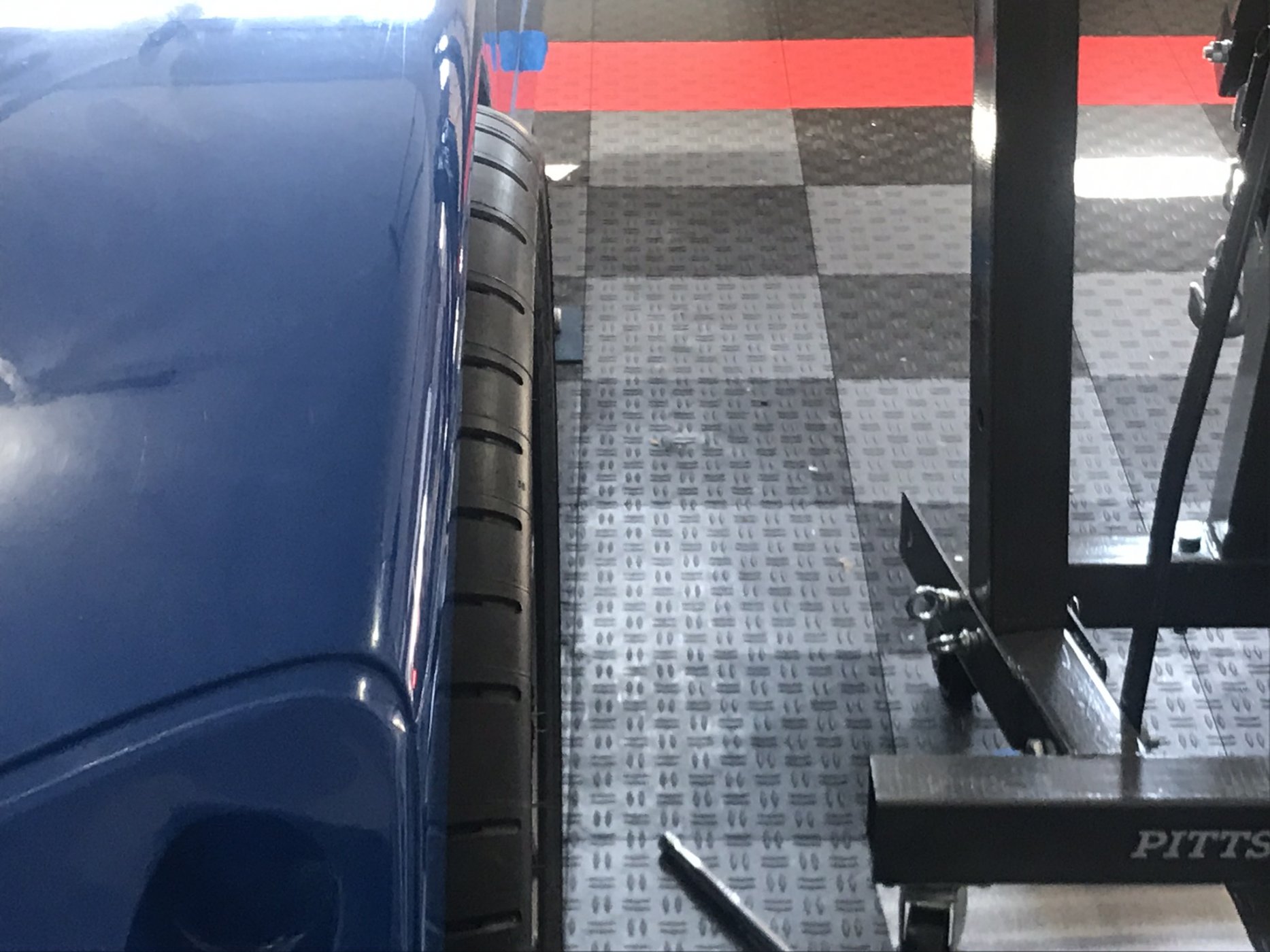

I dialed in 1.5 degrees of negative camber which I‘ve read is the max you would want to have for a street car and it looks better. Not perfect, but acceptable. These run flats have very chunky shoulders which isn’t helping the look.
plus, the front ride height needs to be increased .25-.33 inches and that gap may help the look a little bit more.
Here are a few pics...
