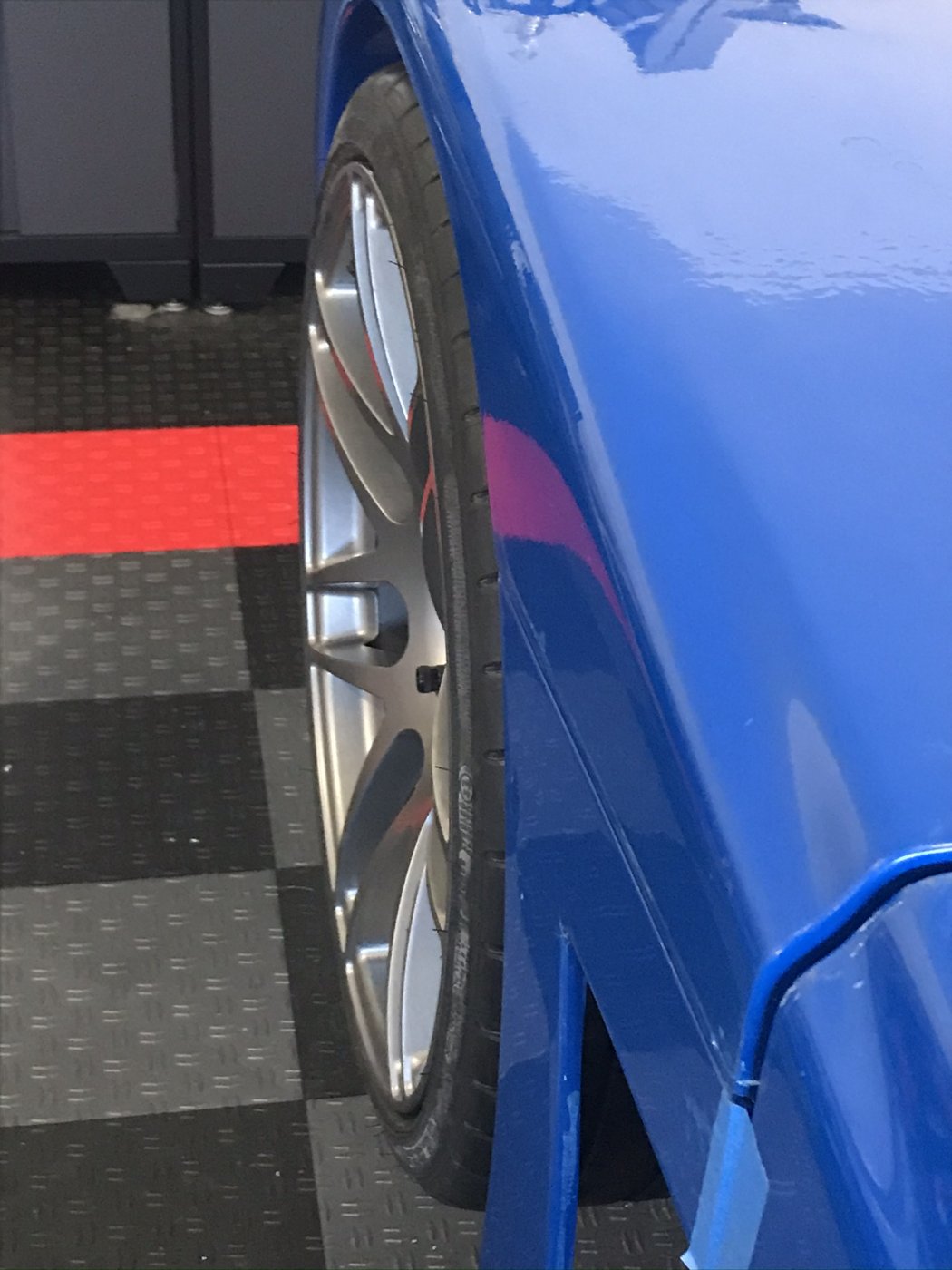

Joel - what ride height are you taking those measurements at?
I had some poke as well at 0-deg camber/4" front ride height, I run 275 Supersports (non run flat). I'm currently running 4.5" front ride height with ~-2deg camber with the 19" CF10 front wheel. The tuck looks great with this setup but I did wind my lower control arm rod ends all the way in, as you did.

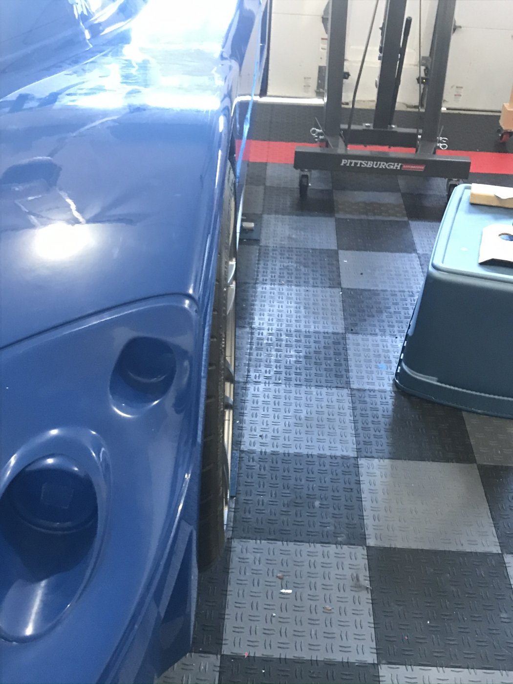

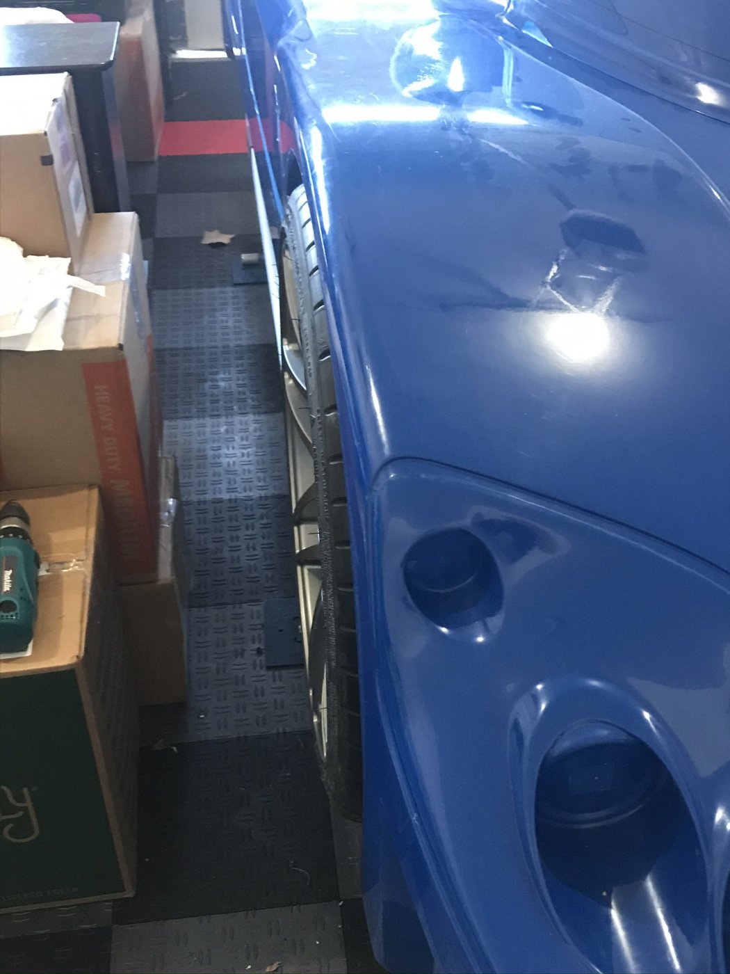

Cam, I probably read that page in your blog 50 times! A great write up.
My original ride height was 4.25“ inches with zero camber and had about .8” poke and the fender tops were literally touching the tires. Moved it to 4.75” ride height and about .5 degree angle on the lower control arm which centered the wheels in the side wheel arch nicely and resulted in a small amount of clearance on top of the wheels. My guess is I would need more clearance between the fender top and wheel.
I think the smaller diameter will work better for my body. Leaving the camber at 1.5 degrees the ride height should be about 4.25 with the front wheels centered nicely in the wheel well with more room between the fender wheel top. But this is all a bit in theory since I don have the car on the ground with weight. I am using anti-droop rods to hold the wheels at ride height in the air.

Joel, I had the same problem with my tires. I was recommended 285/30-19 but they where rubbing on the top arc. Ended up with 275/30-19 and a lot of grinding, the fit ok now. If I would do it all over I would definetly go with 18” in the front.

Thanks Johan, to Cam’s point looks like the Superlite.com page should be updated with better recommendations for front 19” rims. Would have saved a few of us changing the tire choice after initial purchase.

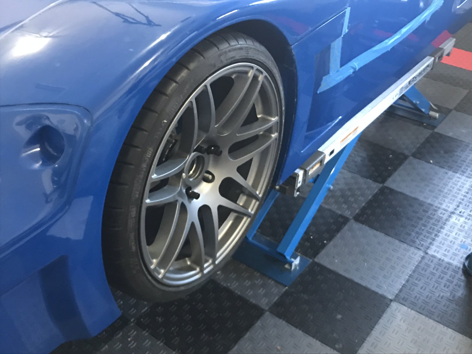

With the new tires on the rims I think the 255/30/19 will work. Ideally 265/30/19 would be best, but the only two Michelin Super Sport Runflats were the 285/30/19 or the 255.
The shop I went to today was great, sorry I did not go to them first but it is what it is and move on.
Here are some pics of the 255s. Interesting how the 285 looked pinched on the rims with the tire overhanging the rim while the 255 looks slightly pulled off the rims.
Pic with zero camber...
Pics with 1.5 degree camber..
This is how the 255 sits in the wheel well with 4.25” Ride height. Both front wheels need to be moved back a bit but looks pretty good with equal distance around the tires.....
Moral of the story, the 285/30/R19 tires are not a good choice with 9.5” rims unless you don’t mind the tire poke or want to add fender spats or widen the front fenders a bit.
