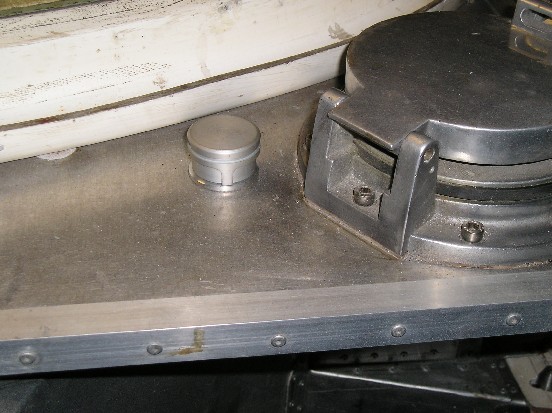

Can any one help with the external dimensions of the fuel cell vents that mount on the cowl by the fuel filler caps (on original GT40's) thay look to be about 25mm dia any help on this would be appreciated as i would like to make some look-alikes for my car.

The vents that I am trying to copy are Fig 3 in the FORD GT40 RESTORATION site www.grandsportcorvette.com/gt/details.htm.
The proper vents/rollover valves will be hidden away somewhere.
On the Tornado you should put some bolts where these vents are so thats why I would like to copy the real ones, I think it will look better than bolts also thats why I only need the external dimensions.

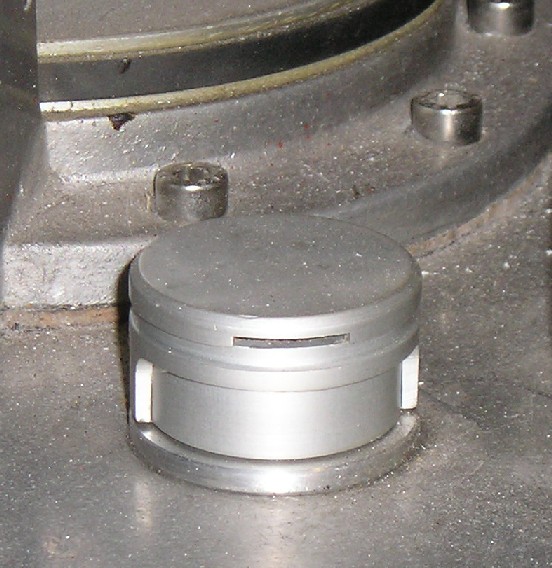

Re fuel cell vents I saw a picture of the vent on the gt40 restoration web site and decided to make my own by sizing the picture untill it looked about right and went from there I know it is not a very professional way of doing it but I think it has turned out quite well all things considered. they are fully working none return valves and makes the car look a little more like the original. I am in the process of rubbing the body down and getting the shut lines right hence the film of dust all over it.

Hi Geoff.
I purchased my vent valves from a company called "Tanks". They are in Clearwater MN, USA Phone 320-558-6882. They are aluminum remote mount and cost $11.0 each. They are about 1 inch in diameter at the vent end and have a 3/8 barb for a rubber tube. I decided to mount the valve part as near to the tank as possible,( probably right on top of the vent tube of the gas tank). In the event of a rollover you do not want a tube full of gas that could catch fire. The valve has a 1/4 NPT male thread on it, so a female NPT to 3/8 hose barb connecor can be connected to it to facilitate routing a vent tube to where ever you want the actual vent to be. The vent is 1 inch diameter and has a 1/4 NPT female thread. A male 1/4 NPT to 3/8 hose barb connector will fit into it. I have not mounted my valves vents yet, as I am still deciding where to put them. I am reluctant to put them near the filler caps, as rain water could get into the vent tube and then into the gas tank.
