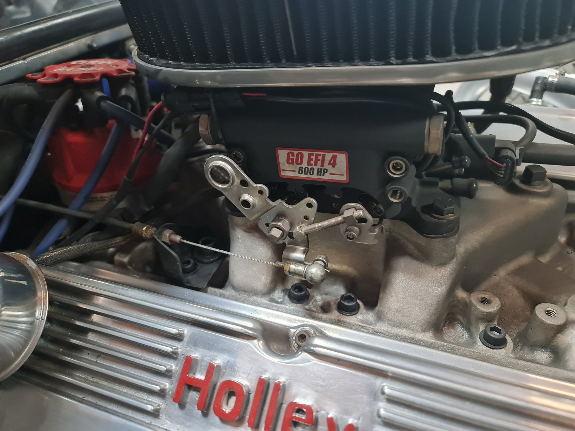

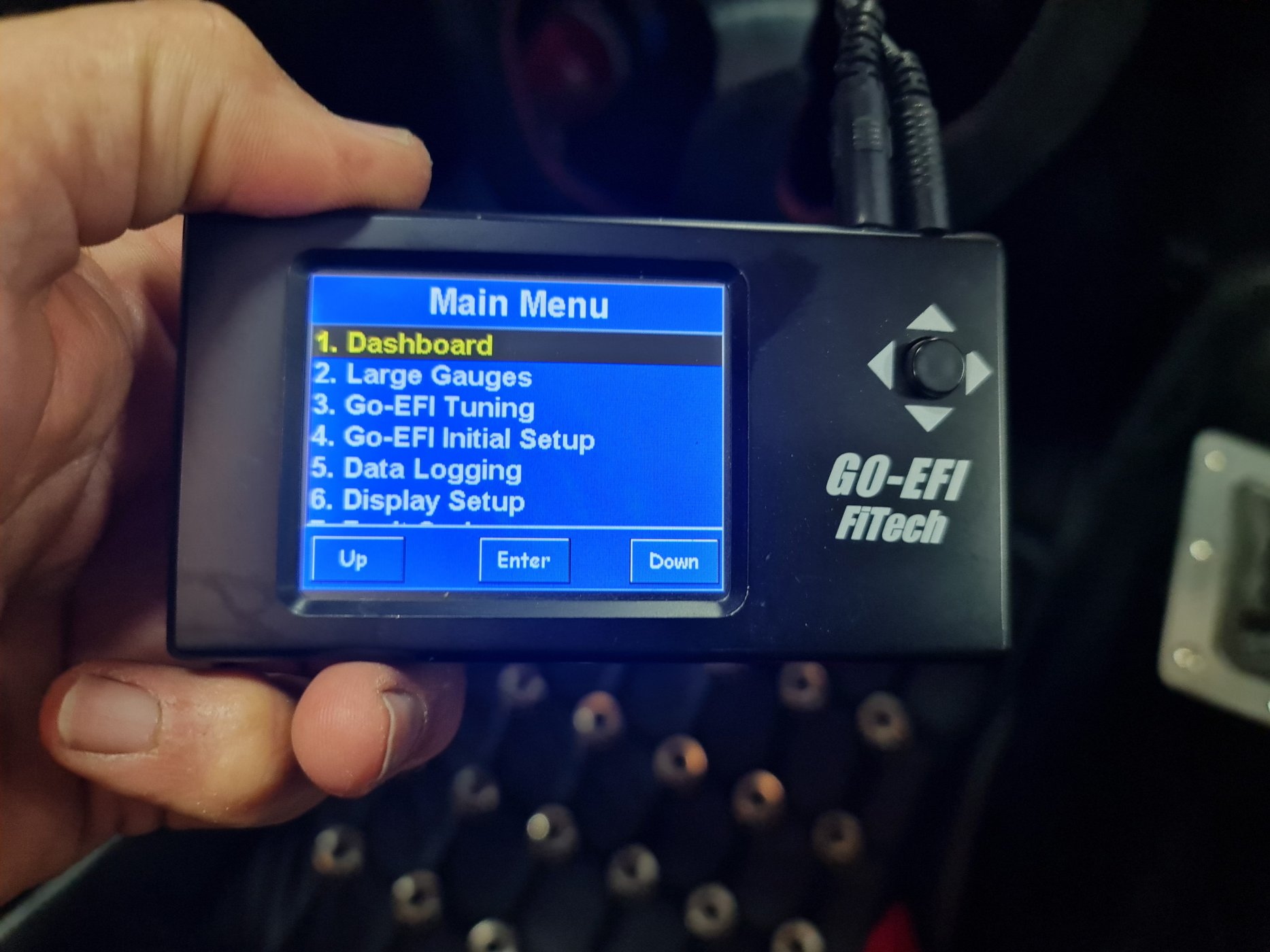

Struggling with a USA built GO-EFI FITECH on my reasonably stock road 302. I haven't used a Fuel injection set up before so am wondering if anyone on the Forum has some advise on settings...?
I have a standard looking menu however at the mo it's mostly Greek to me as I don't know what settings I should be possibly running...
Right now engine struggles to pick up smoothly at lower rev range and it's only around 3.5k when things seem a little better....
The plugs are very wet and with the smell indication is that the mix is too rich although the engine symptoms act like it's running lean...
Not sure if any US chums out there are ru nine or of these injection systems but would sure appreciate some advise on what is considered base line settings for a 302 so I can ensure my setting are where they should be on the menu...
I adjusted the plug gaps to around .035" to.040" running slightly cool plugs and am running an MSD dizzy....
Thanks in advance for any help guys.

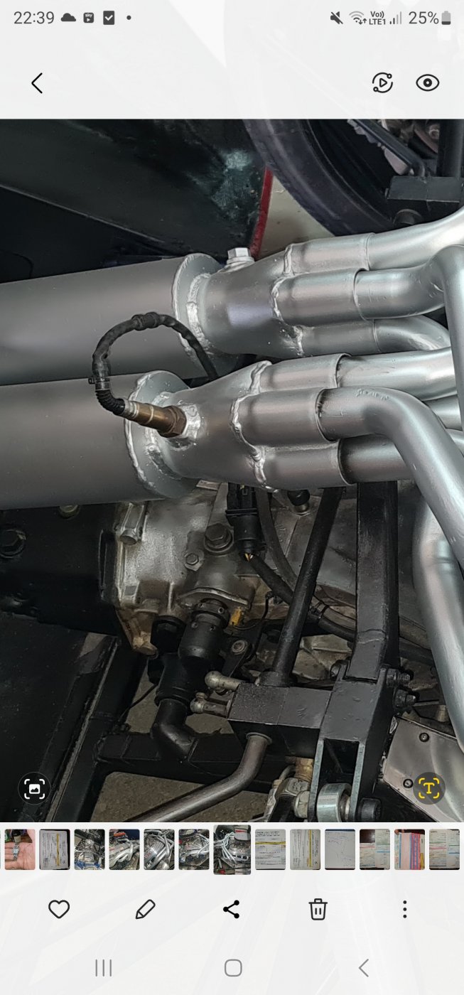

OK fellas picture attached of sensor in the collector... you can see there is some sign of exhaust leaking so selling this might help... I am also wondering if running the car now at non altitude (less thin air) in UK might have effected things so perhaps settings might need adjusting but will start by trying to seal collector....:)

The collector on the other side shows little to no signs off leakage (at least from what is seen on your pic) - you could put the O2 sensor there and see if things change to the better.....
You need to check for an exhaust leak on the O2 sensor side. Reverse the hose on your Shop Vac (if you have one) so it is blowing air out of the hose. Shove it in your tail pipe and tape it up to seal. Use soapy water on the slip joints and check for bubbles. I had the same problem with the Holley Terminator X ecu and ProFlo MPFI system on my 66 Mustang.
I had the same problem and without a doubt the blackened part on your collector pipes is definitely an exhaust leak. I corrected the leak by taking it apart and using Permatex high heat gasket maker. Issue resolved. Clean out your connections and place a double bead on the inside of both collectors and let it sit overnight. Someone on this forum posted it and it worked for me. No more rough idling.
I would suggest this is not a permanent fix, but should hold long enough to let your ECU tune itself.
After it is tuned and running good, find out how to lock in the VE table (or whatever they call the fueling tables) and don't let it start screwing things up if or when the permatex burns out.
I have megasquirt on a Cobra. Once it's running, I turn off any ability for the ECU to correct based on O2 readings because it seems exhaust leaks always return. It may be the case you have to remove and unplug the o2 sensor and cap the port.

Just an update all... So I was able to remove my O2 Sensor in the collector resealed the four headers, cleaned the Sensor with carb cleaner and compressed air and refitted same.
Engine now running far better and I plan to put some miles on her in what's left of the UK Summer...
Thanks so much to all that contributed to help me with the issue.... moral of the story make sure headers sealing correctly and clean Sensor...
