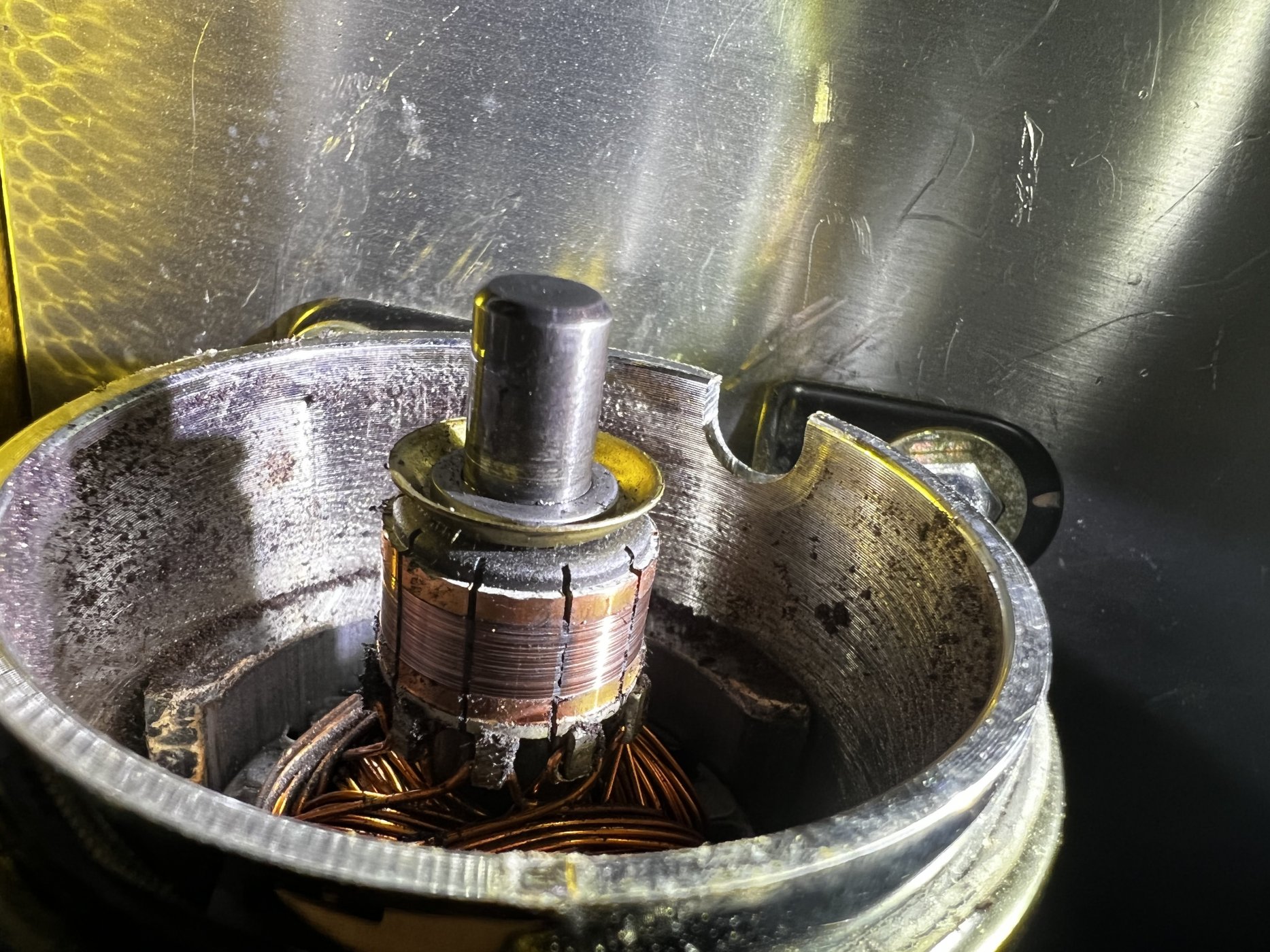

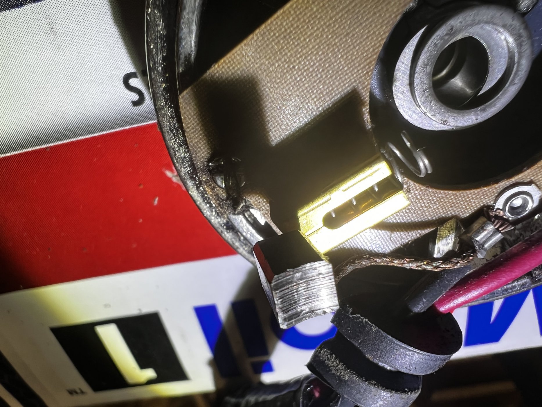

Disassembled the Holley HP125 and found the brushes disintegrating and the commutator badly scored. There were pictures very similar on Summit .com with the stories. The pump is mounted two inches above the bottom of the tank. I’ve never needed more than 7.5 gallons when getting fuel so I don’t believe it was a lift concern.

I think I’d be contacting Holley about that pump failure. There may have been trash left inside the pump‘s brush cavity during assembly. These pumps should be capable of a thousand hours of use without failure. This type of issue may also be indicative of why fuel pumps were moved into the fuel tank and have the fuel itself flowing through the brush cavity to keep things cool.
