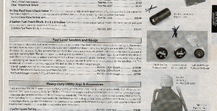

Jimbo,
There are sweveral catalogue listers that cary the same if not similar senders. I just ordered one from Pegasus. Here is their listing. This one allows you to alter the lenght of the sender to the size of your tank. It also has a provision for a low level warning light to be hooked up which is what I wanted. I use Stewart Warner guages and they listed about 3 or 4 different versions of the same guage with the different electrical values. So matching was easy.

I appreciate all the help. This will make life a lot easier. I didn't think about this, but of course if you have foam in the tank, you have to use vertical senders, or start removing foam, which is exactly the direction you DON'T want to go in. And if there are baffles, you can't stuff the foam in. So, I understand this now.
I'll have to figure out which senders go with the Smiths gauge that I have. I can read the impedance off the Smiths senders, and hook them up with the gauge on a test setup to make sure that the senders I bought were the right ones. Not that I am going to use them now, but I am sure I am stuck with them.
