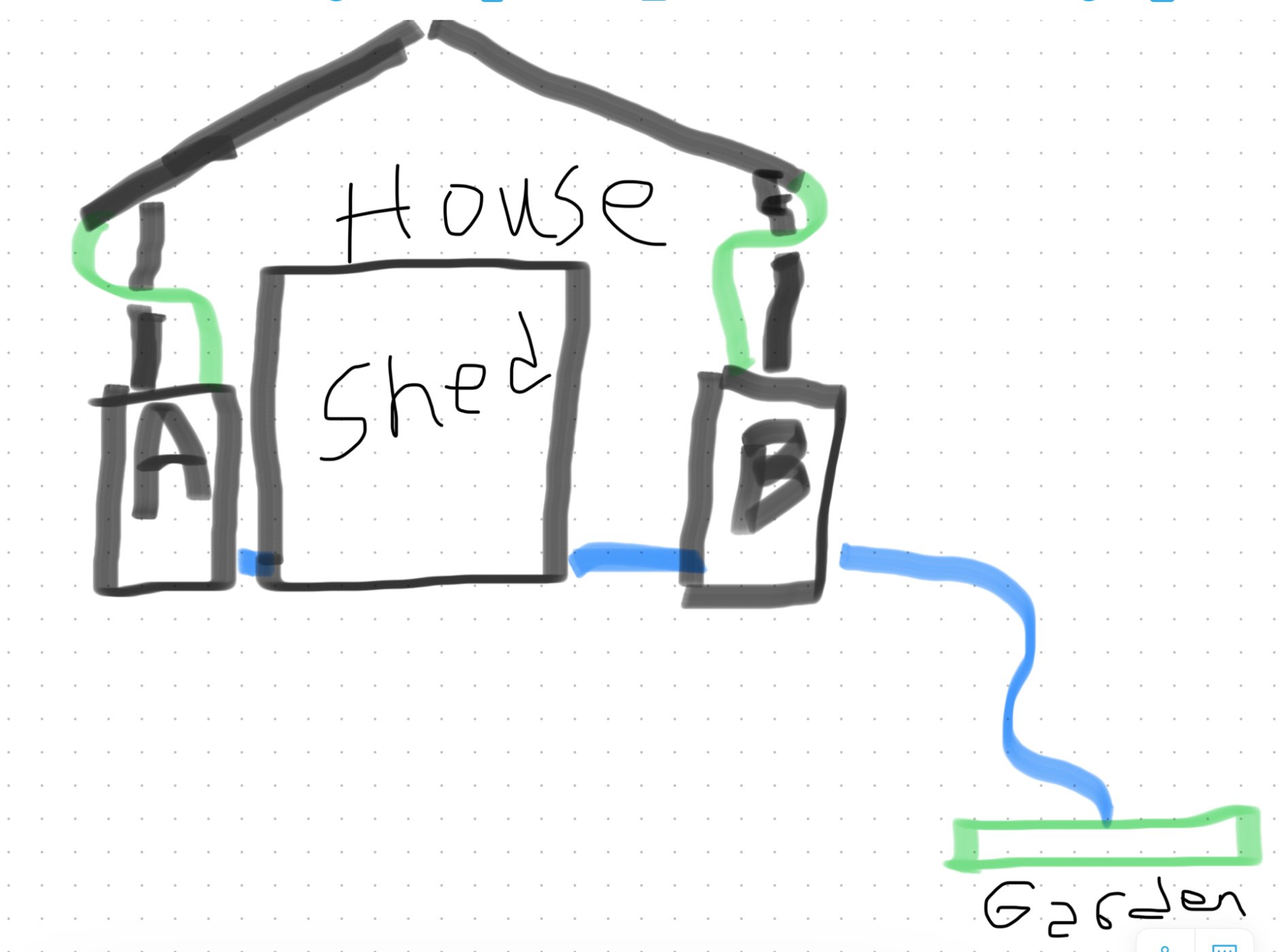

I had 2 50 gallon rain barrels (A & B) collecting downspout water 10’ apart. There was a shed between them. They were connected with a 1” PVC pipe at the bottom. Barrel B had a spigot at the bottom connected to a garden hose that ran down a slight hill to my wife’s garden. I was not getting more than a trickle through the pipe and the water in A would actually overflow while B was almost empty. That’s when I realized that with A & B on the same horizontal plane that there was not enough head pressure to cause the water to transfer from A to B and raise the level of B to be equal. I didn’t want to run a larger pipe nor go through the trouble to implement a transfer pump on something that should have been simple and without ongoing troubles or expense.
I lifted A up 3’ as an experiment (using a hose). Finally I got A to raise the level of B to the point where it would slowly overflow. She was happy and so was I. I left it that way until we moved about 5 years later.
understanding that gasoline weighs more than water, but the remaining physics should be close to analogous to a pair of fuel tanks.
excuse the poor illustration…
