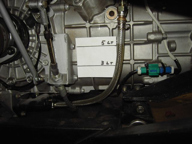

I found this photo somewhere- maybe here? It shows 5 liters in this G50. I run mine with about 4 liters.

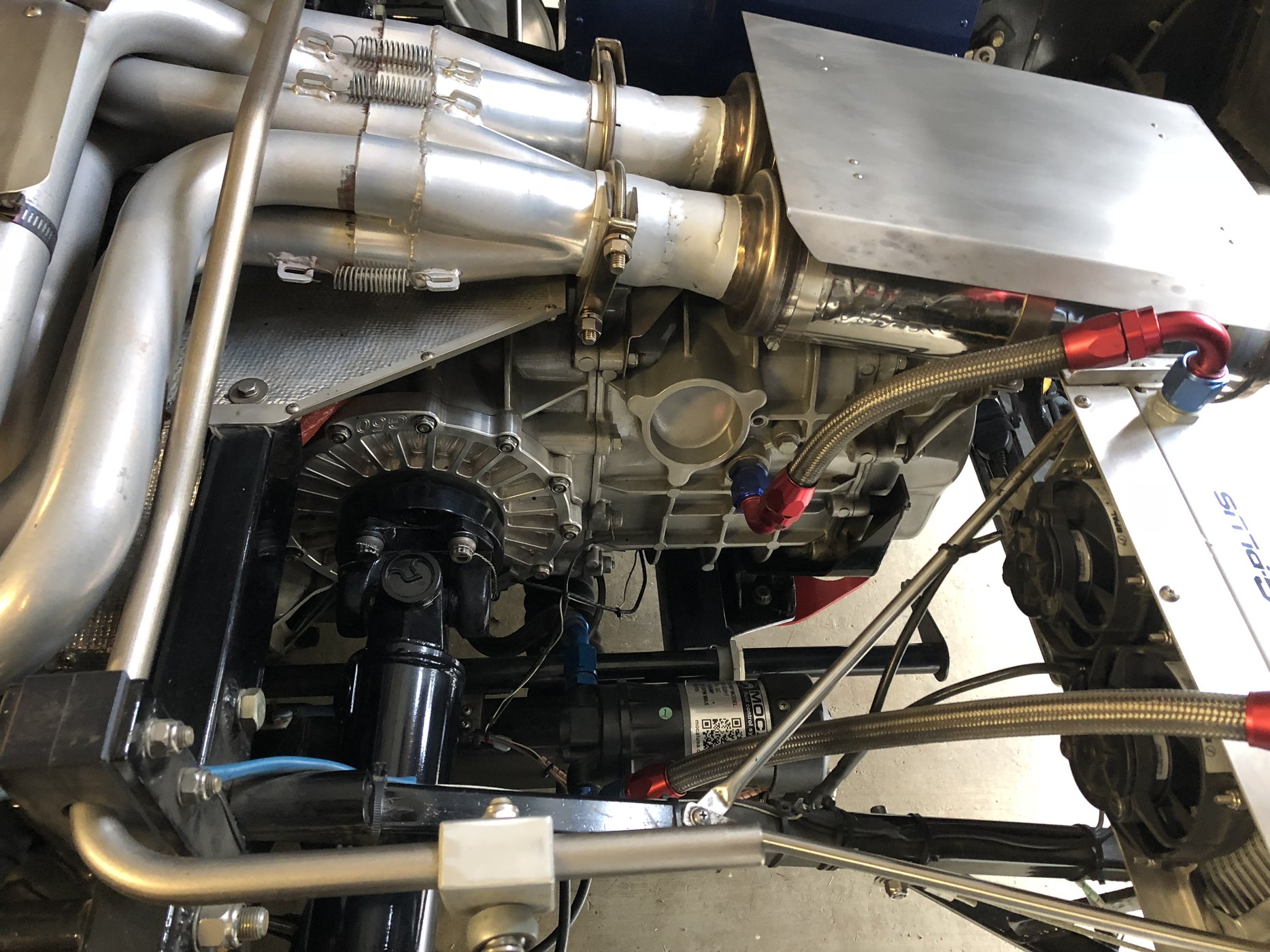

From my thread,
So I got a call back from California Motorsports. They built my G50-01/03. It has a short tail cover, Quaife TBD, taller German 1st and 2nd gears along with steel syncros and a billet side plate.
They are saying 4 quarts or 3.7 liters for my flipped (input shaft below output shafts) version.
This is the same amount recommended for a normally installed (input shaft above output shafts) G50-50 whereas the G50-01/03 calls for 3.4 liters.
So there we go! A gal it is!
