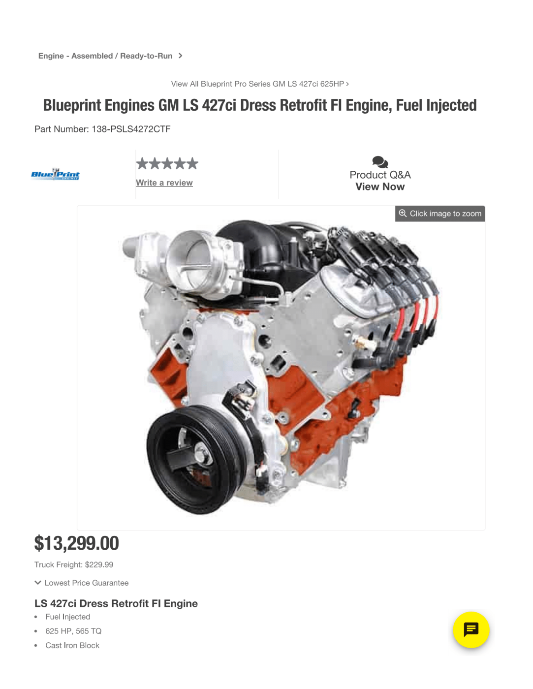

So I'm approaching my timeline to buy engine and transmission. I have NOT ordered the car yet.
I think Im pretty set on Graziano based on conversations with Fran. (I dont want to go above 1000HP at any point during the life of the car).
My personal preference is to get a 427 in some configuration that allows me to build the car, drive it around, and get the car on the road for a couple seasons. Go to some tracks, see where I can work out any kinks, take the wife out on some dates in the city, etc.
When Im ready, a few years into driving it, I want to bump up the HP to about 800. By then I will have been researching alot more about what it takes to track the car competitively, and gotten familiar with this car's capabilities, quirks, and limitations.
My question for the group (and eventually Fran) is: is THIS engine a good choice for 10-15 years of ownership, and is THIS engine configuration a good platform to start with if my plan is to eventually supercharge it? I can spend 6 months completing the engine on a stand in the garage; I actually want to, so that I know my engine.
-Will it fit?
-Is there any issue with the standard oil pans for these SBC's not fitting/developing performance problems in the SL-C?
-Will I have to modify the rear window to accommodate a supercharger at that later date?
-Anything Im missing that would be an obvious regret later?

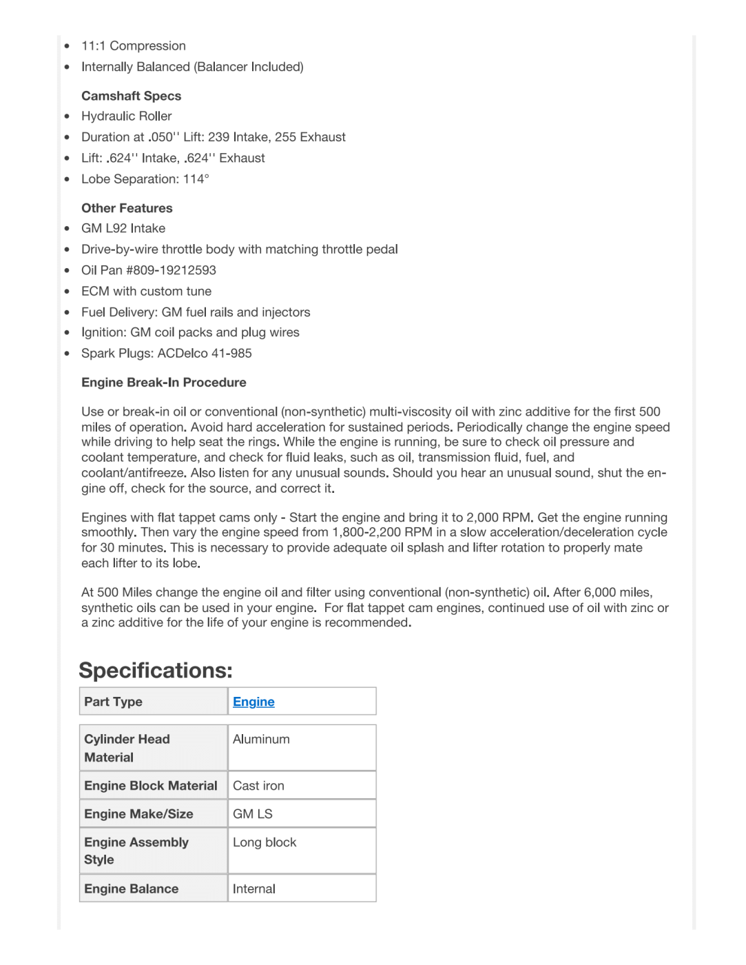

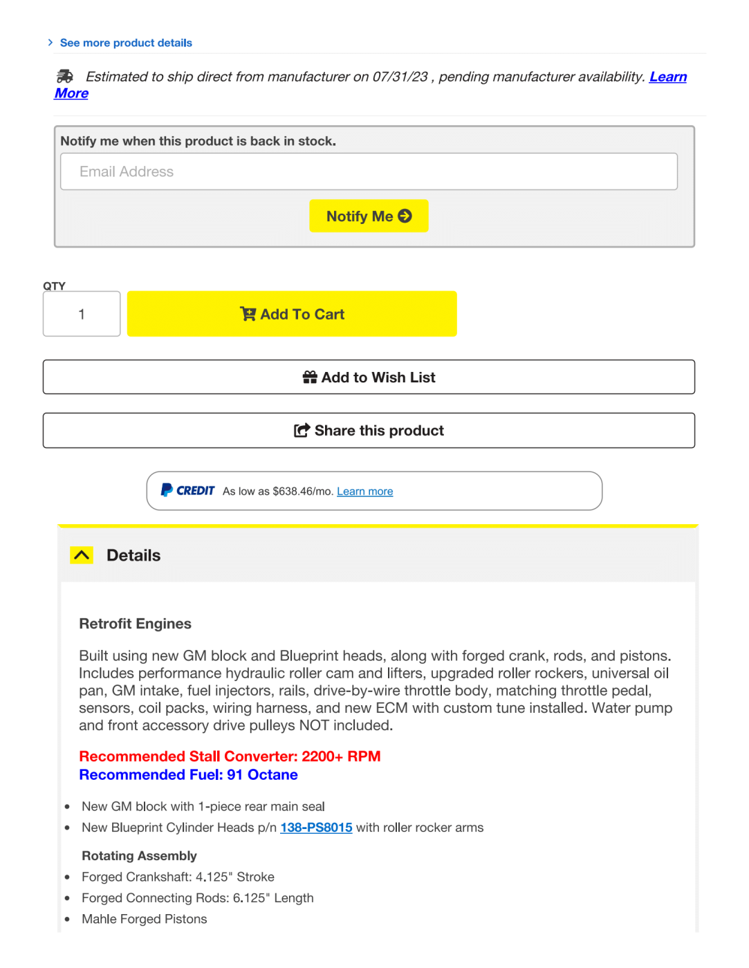

11:1 compression is too high to consider superchargers or turbochargers…. 9.5:1 would be the absolute max I would recommend. Also, adding any boost will increase the load on the cooling systems. Frankly, that engine Normally Aspirated will likely scare the bananas out of you in a lightweight car on the street…

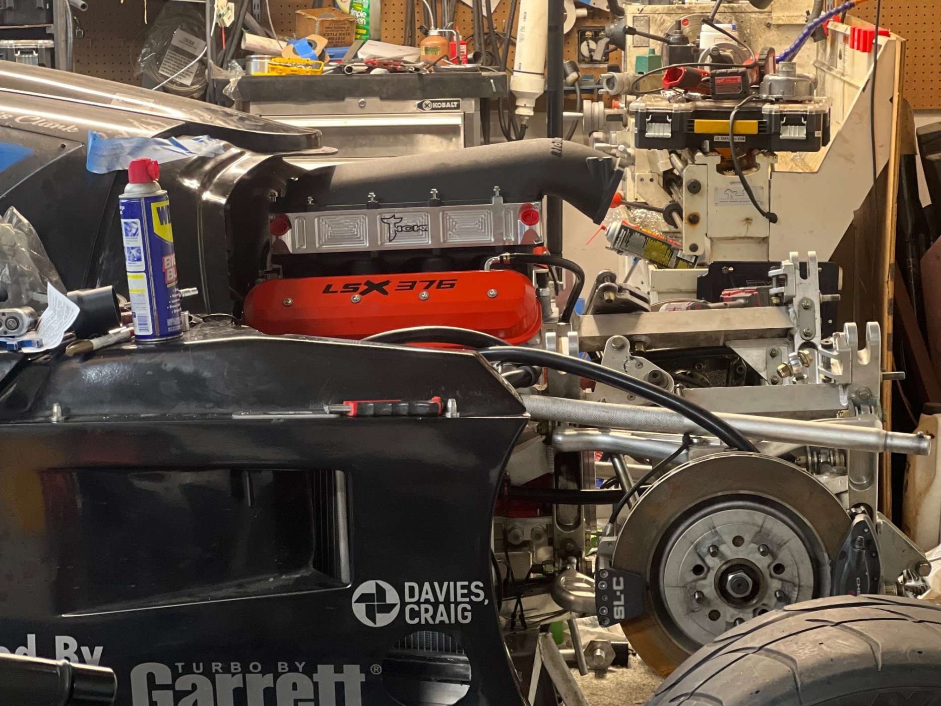

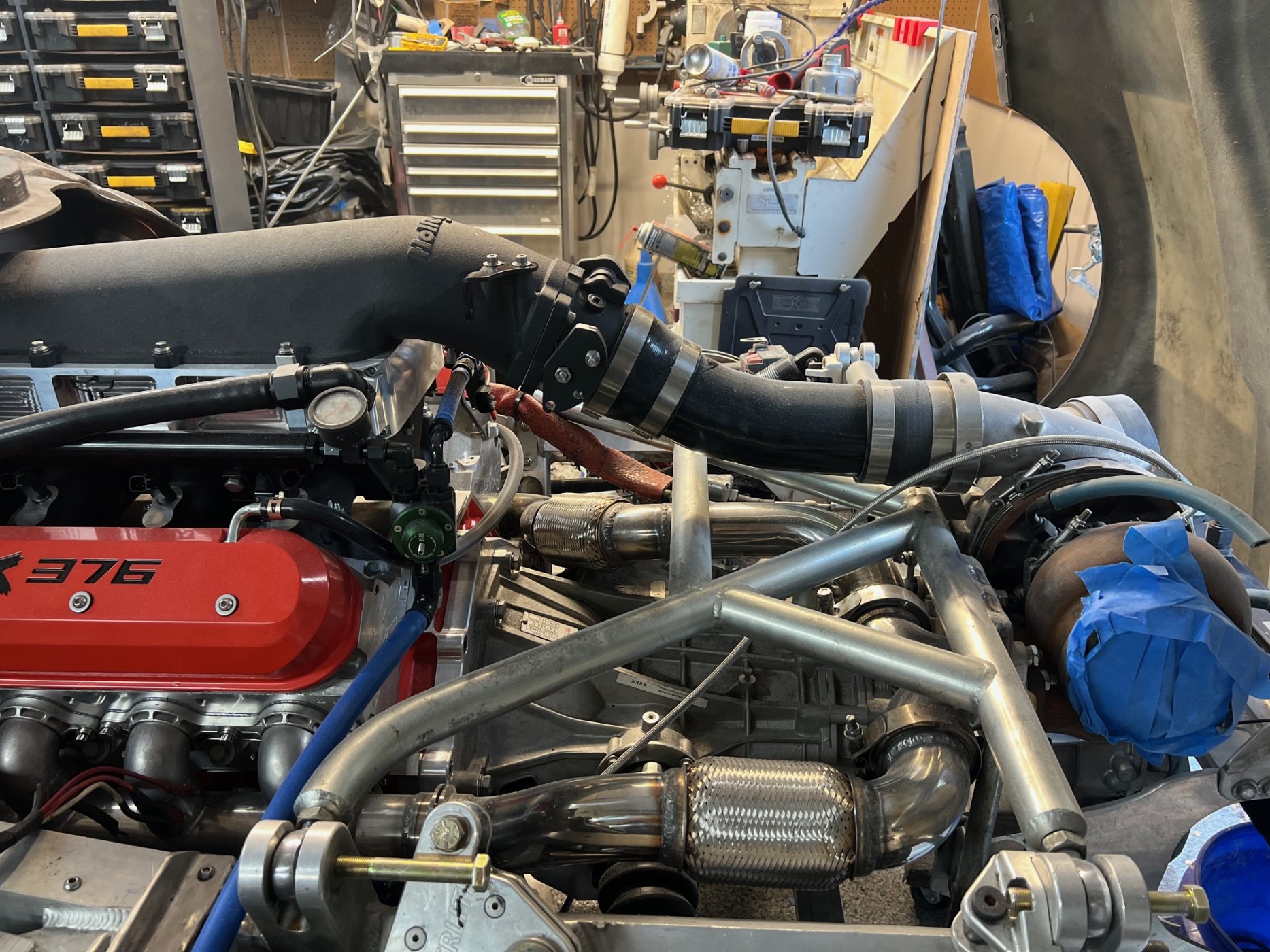

If you are looking for a boosted application (eventually), you probably don't want a 427. The large bore does not leave much cylinder wall causing various issues. Over the last few months I've put a LSX376-B15 (GM Crate Engine) in mine. Probably the same block as the Blueprint Engine above, but "only" 376cid. It already has lower compression. Makes about 430-450 HP with it's lower compression and reasonable cam. It's meant for boost (B15 = 15psi Boost). It's a bit cheaper, but does not include intake/TB/Coils/ECU/Injectors so will cost more in any finished form.
