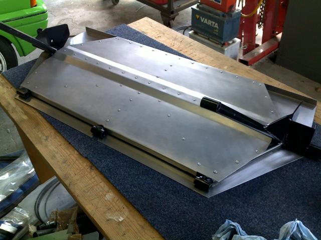

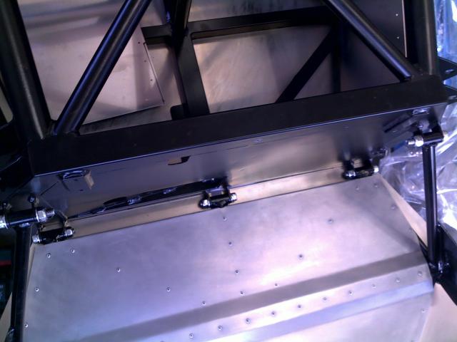

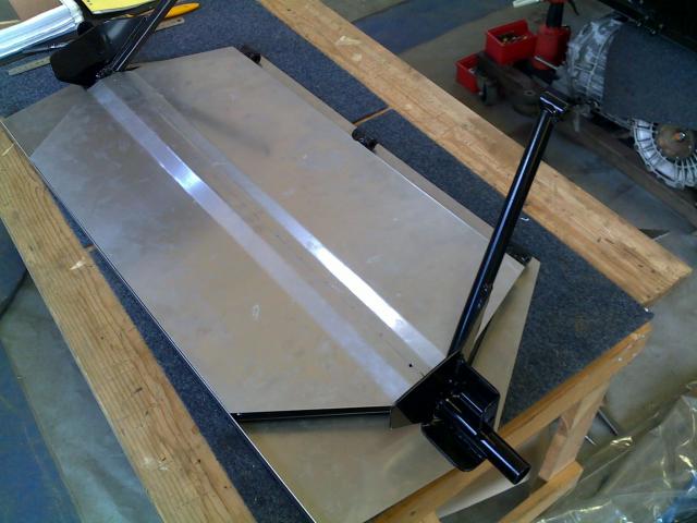

Ok, some progress to report. The front subframe is now fitted with ally and fitted to the car.
Thomas, hopefully the photos will answer your questions. There is a very small gap (about 1mm) between the main floor pan and the rear edge of the subframe bottom panel.
