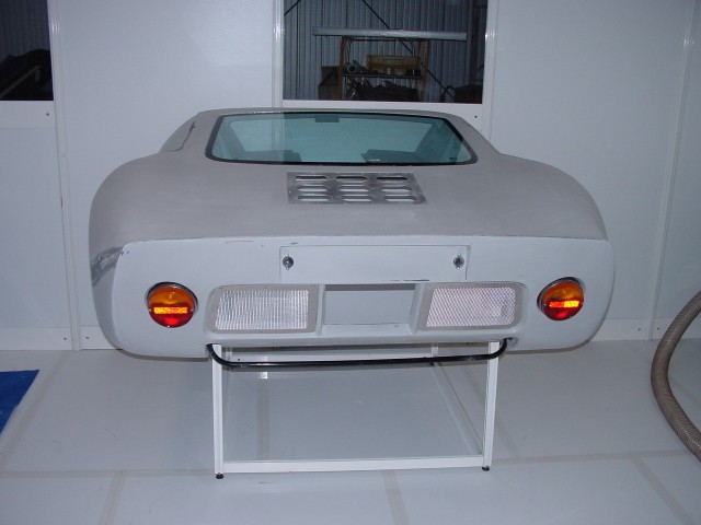

"Finished" rear clip.
Trimmed the cutouts and installed the lights and grilles.
The rear glass fits very nice.
Reinhard

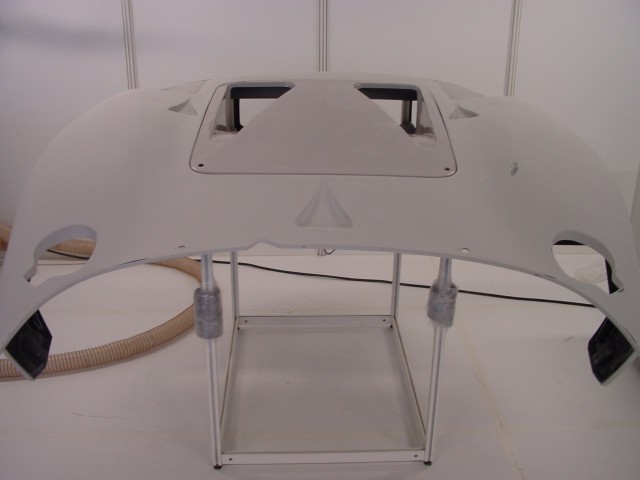

Fitted the single vent nostril - but still needs some trimming till I am satisfied.
Reinhard
