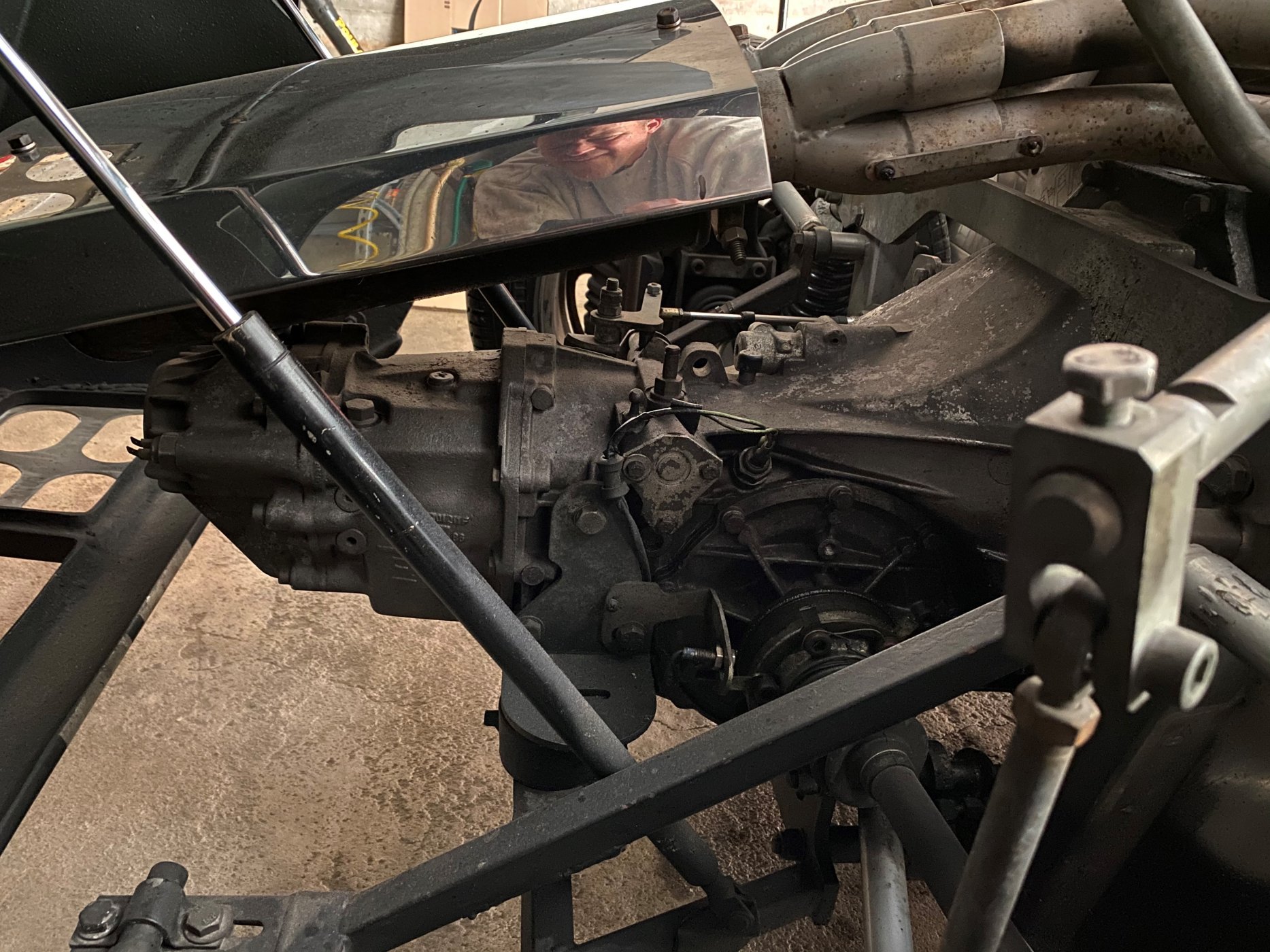

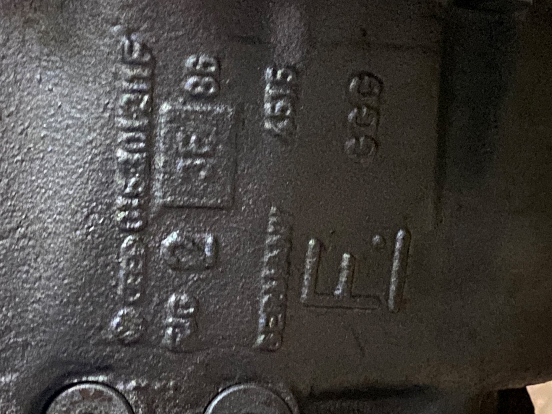

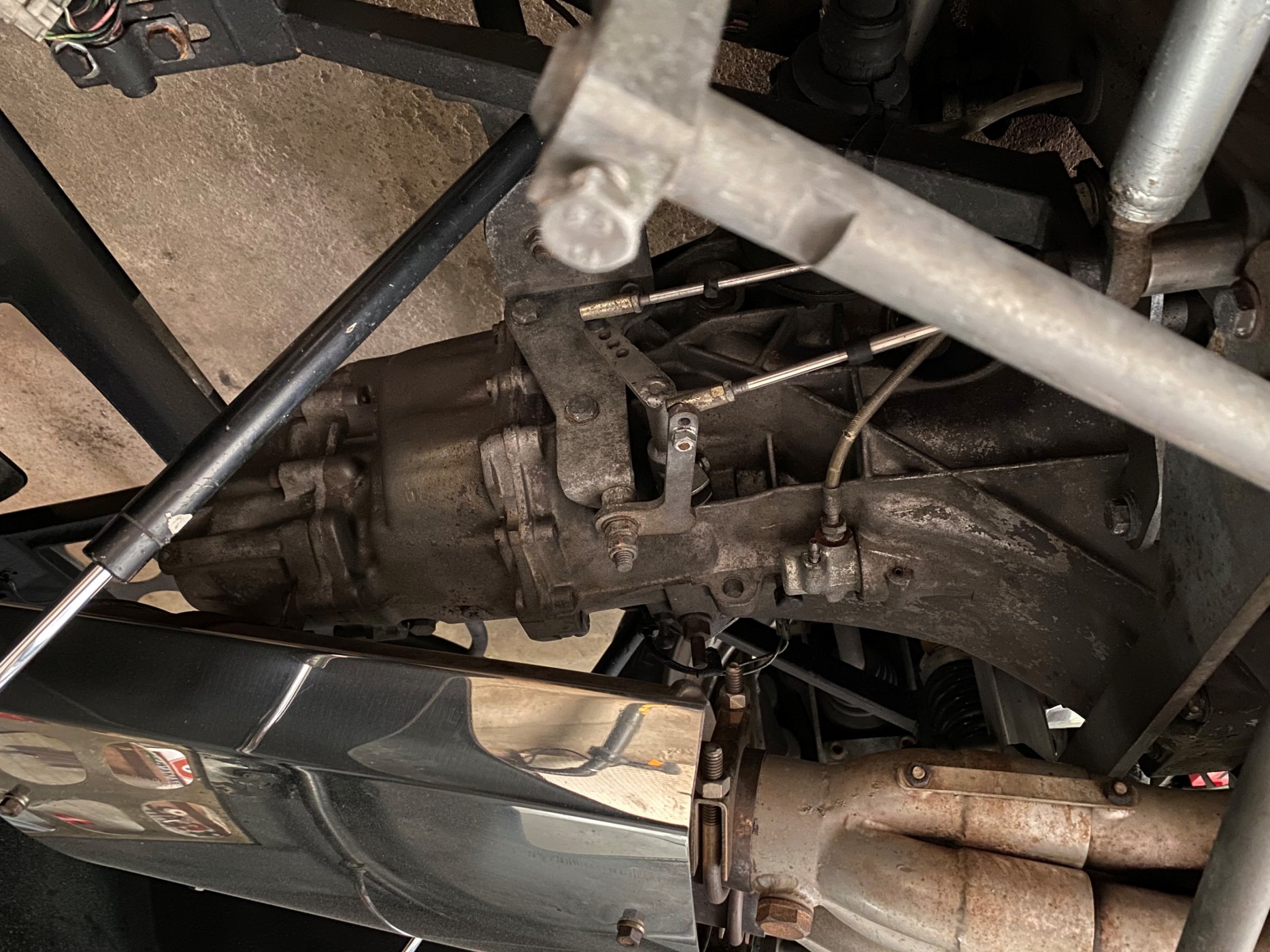

B brook wise Sep 21, 2020 #1 Hello! I have inherited a CAV GT, Chassis #70 and I am struggling to identify the transaxle. I know it is a Getrag 5 speed but, I would like to know which "model" I have included a few pictures. Can anyone help? Attachments Getrag1.jpg 419 KB · Views: 342 Getrag2.jpg 485.3 KB · Views: 387 Getrag3.jpg 455.5 KB · Views: 366
Paul Hendrickx Sep 21, 2020 #2 Hi, Audi 016 box old Audi 100 or 200 model box or even Audi 80, Volkswagen Passat 1ere model Paul
B brook wise Sep 21, 2020 #3 Hendrickx Paul said: Hi, Audi 016 box old Audi 100 or 200 model box or even Audi 80, Volkswagen Passat 1ere model Paul Click to expand... Thank you very much Paul.

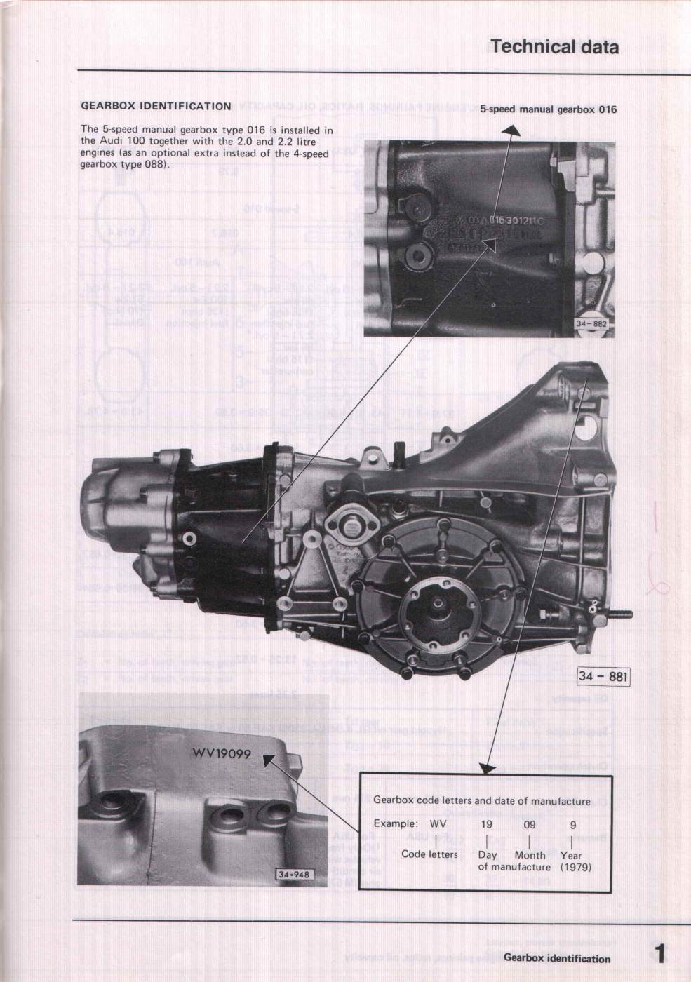

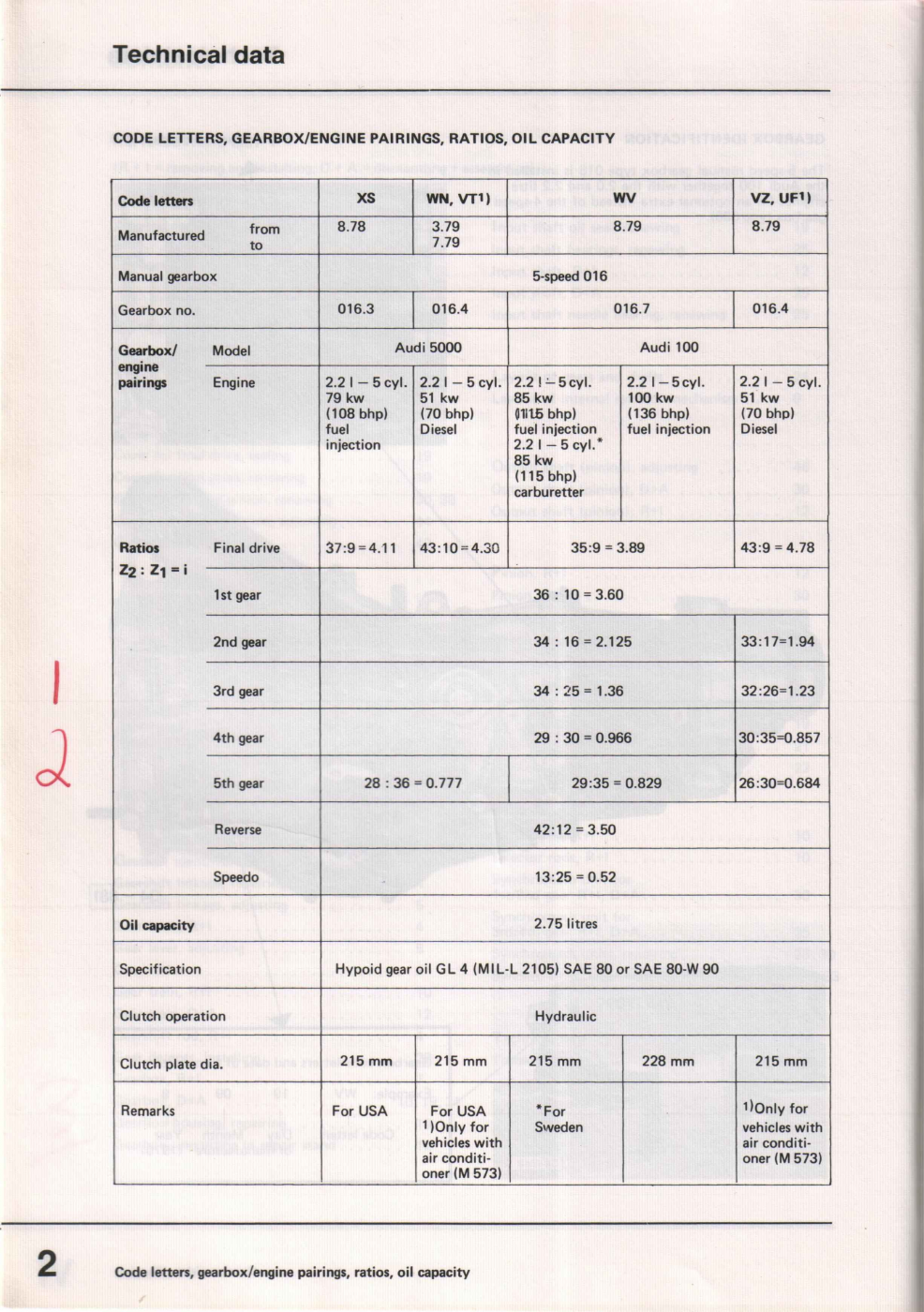

Paul Hendrickx Sep 21, 2020 #6 TRAINING DOC Attachments ssp_027_d1.pdf ssp_027_d1.pdf 1.6 MB · Views: 469
Pat Supporter Sep 30, 2020 #8 You also need to look at the top of the transmission under the collectors to get the code letters.
