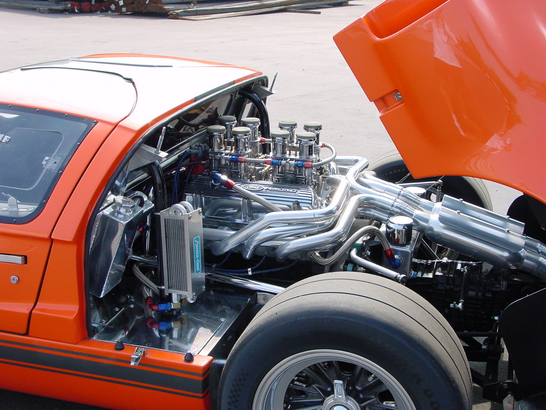

btw: I got to spend three intimate hours with a real GT40 today!!!! I think I wore out my camera!!! /ubbthreads/images/graemlins/smile.gif
A real GT40! You rode in it? I'm jealous.

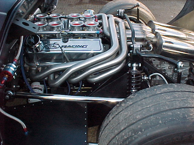

Bill,
Not sure what motor your building but my fabricater will be starting headers soon for my 351\427. If your interested, he could do two sets if I ask. In addition, if you have a 302 then maybe my old set will work for you. Just a thought.
Attached below is the 302 set that my fabricator made a couple yeads ago.

Actually I didn't get to ride in it . /ubbthreads/images/graemlins/frown.gif
It would have been a blast though (it has well over 700hp!)
It is an aluminum 427"SBF with Yates heads!
I did,however, get full access to take as mant pictures as I wanted! I got 255 of them!!!
