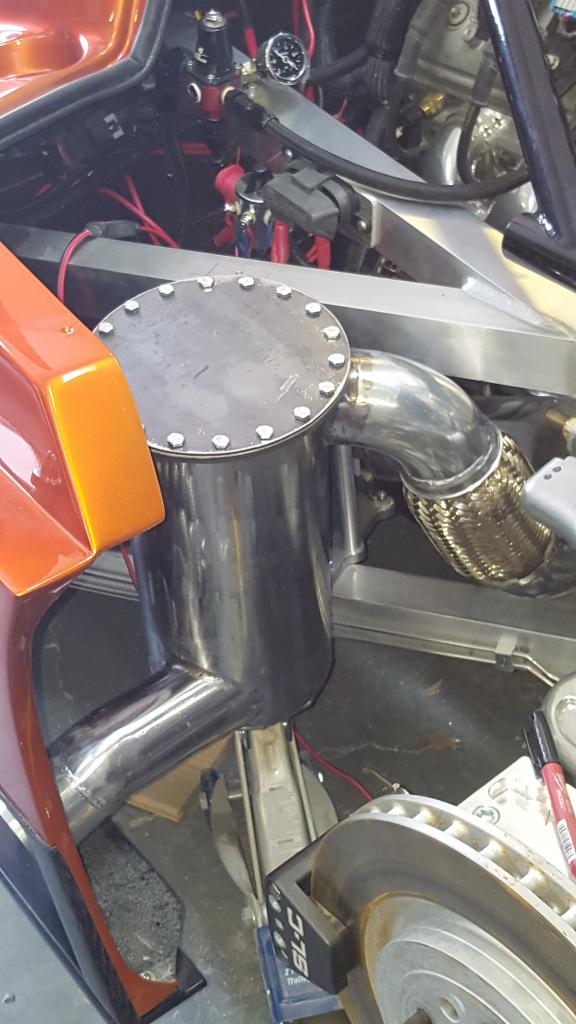

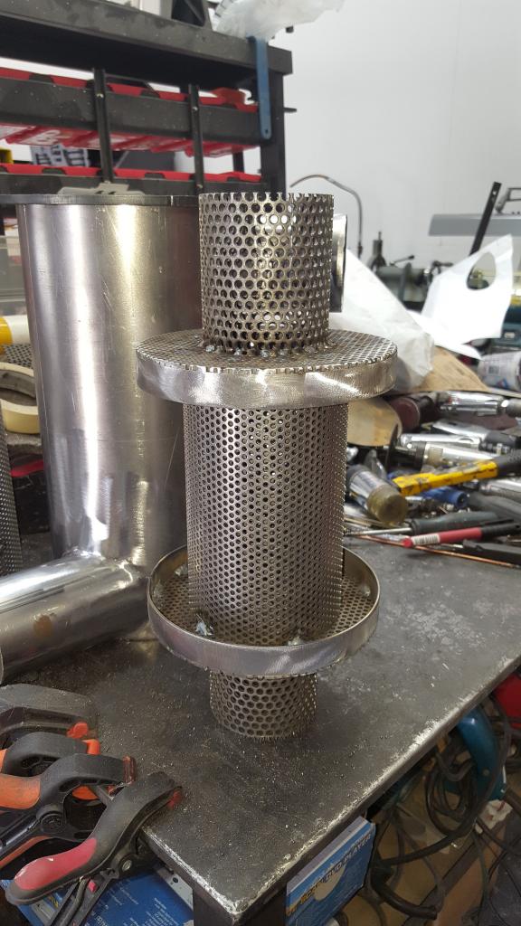

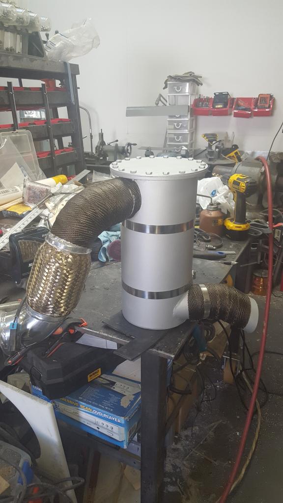

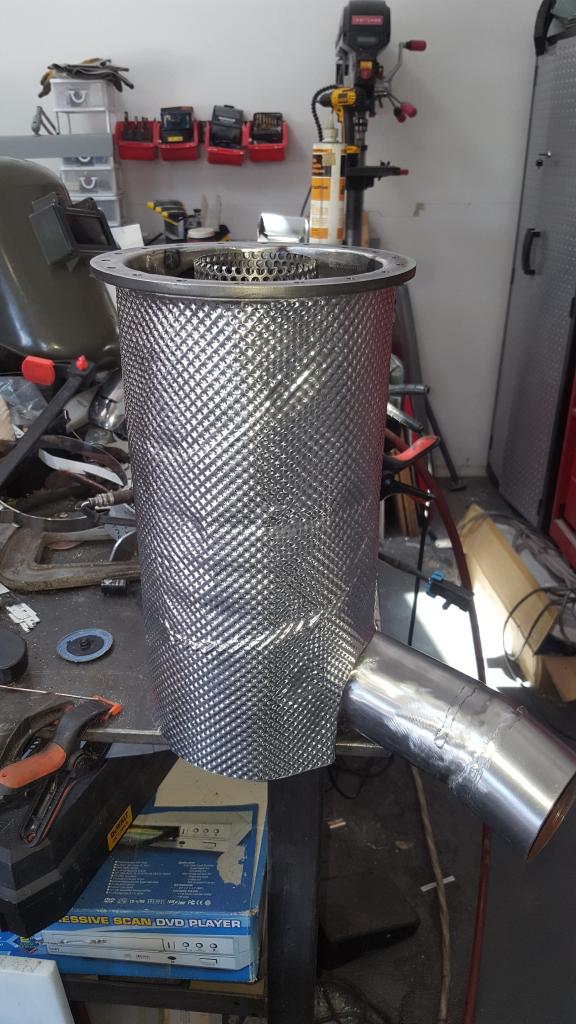

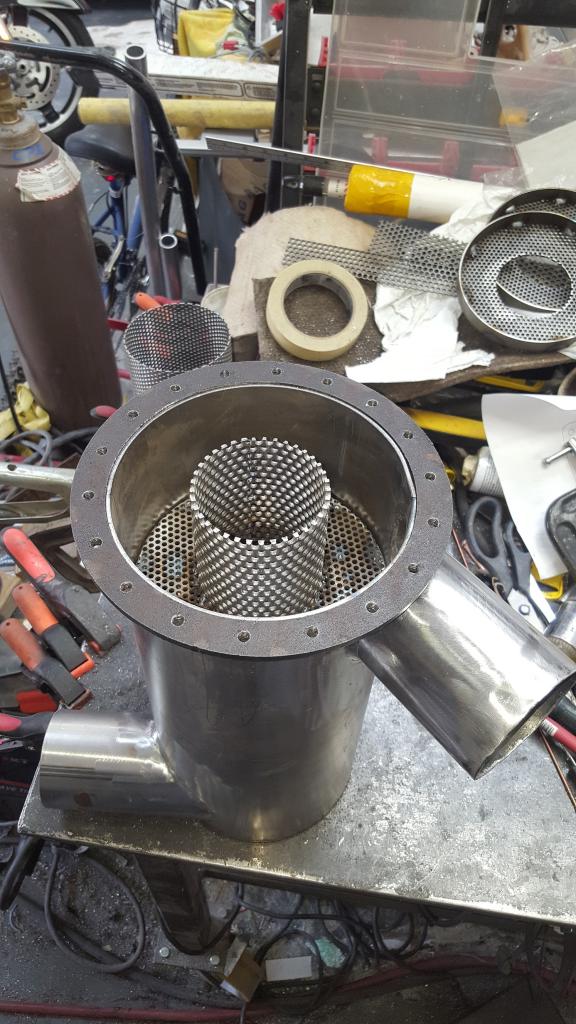

Ok So the exhaust system I built earlier did not turn out not so well after all.

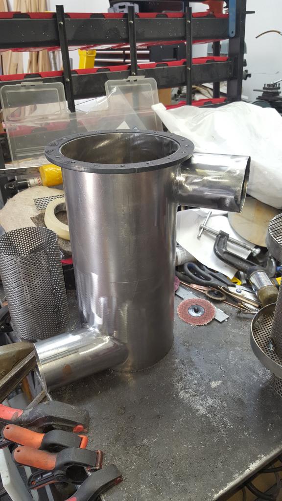

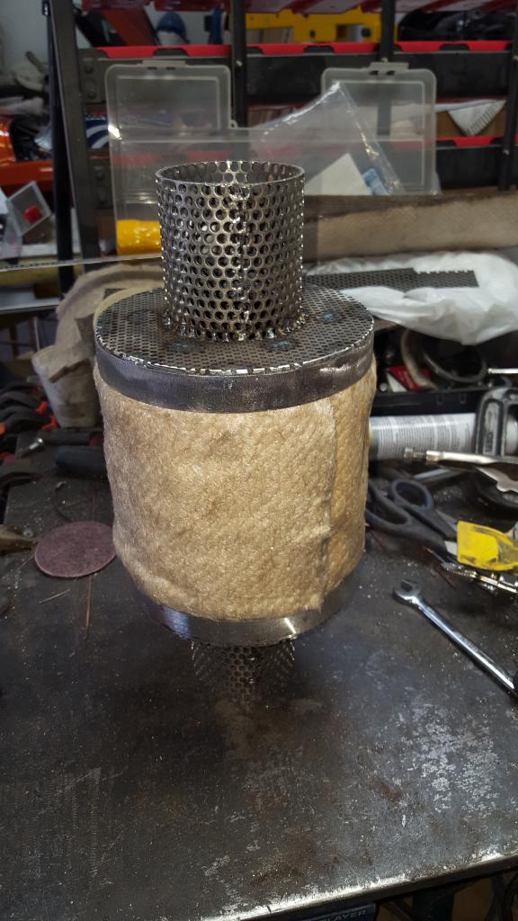

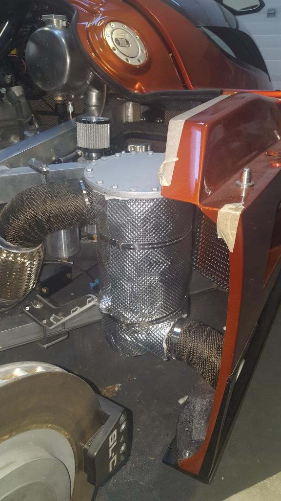

Fran did said to watch the heat and at first it seemed to be ok. So after you put 500 hours into body and paint and put the whole car together is when you find out that the exhaust gets really really hot and you will melt the paint off the car. So back to the drawing board after three days of searching for a unicorn muffler that has to fit exactly and be semi quite .... well it doesn't exist. Being I've made everything else from scratch why not the mufflers too. So three try's later and another hundred hours or so we have custom made mufflers that flow, sound nice and are not to loud, they fit and most important low heat and they can be easily repacked or opened right up in mins if I wanna track the car but being that they flow so good, I think I'd just leave them as they are.

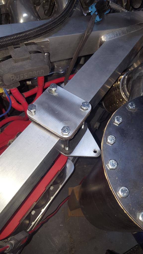

once I figure out the mounts I will wrap them in the a alum heat shield shown in the pic's to help further reduce the heat.

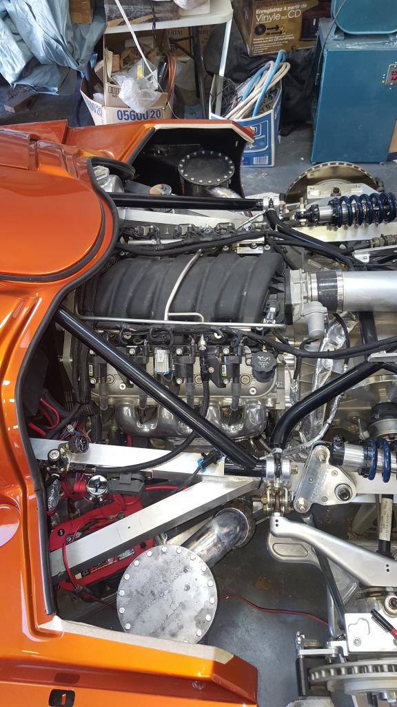

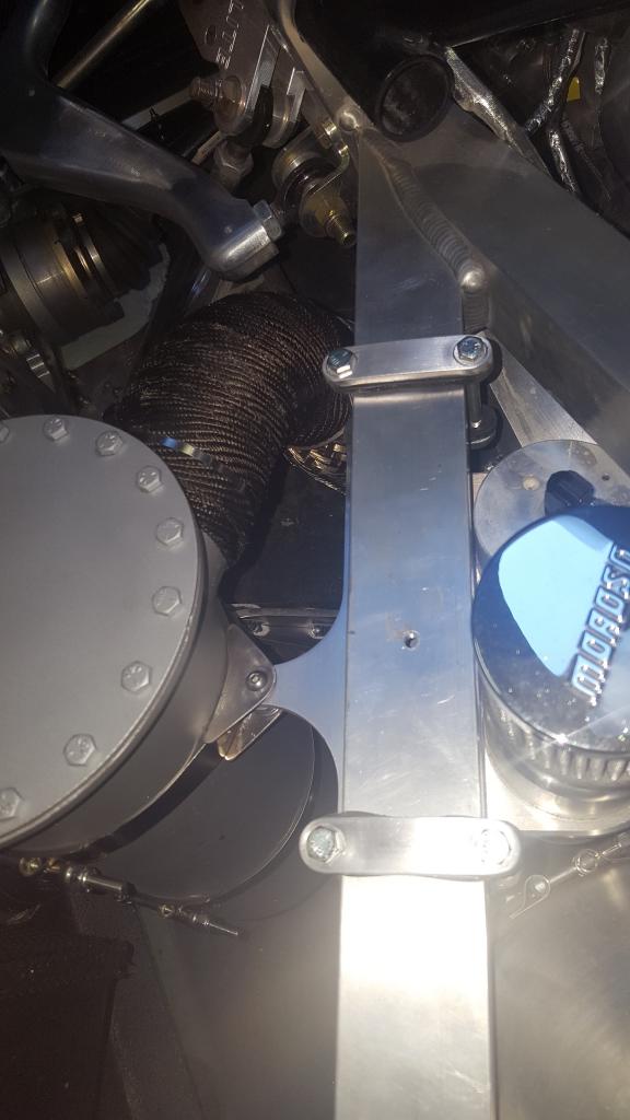

couple more pic`s of the rubber mounts and head shielding

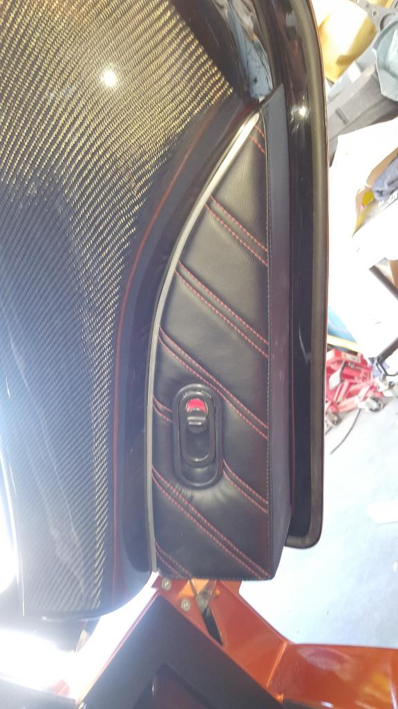

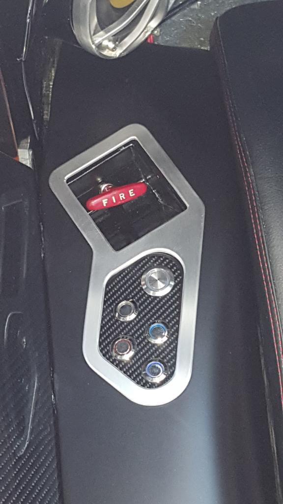

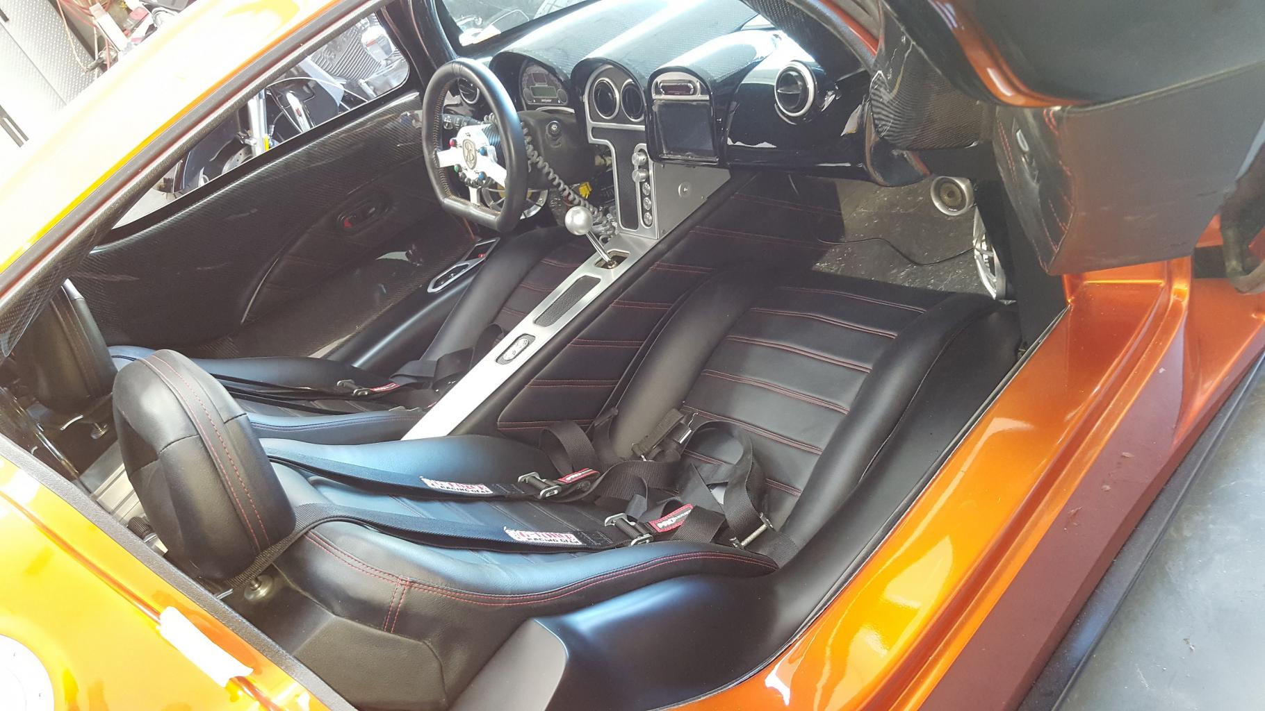

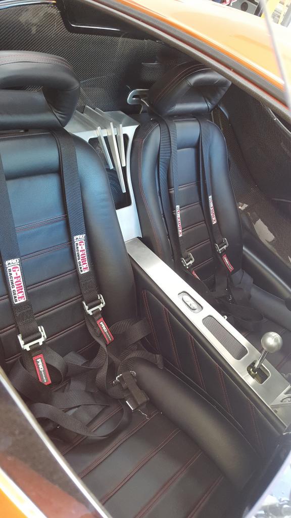

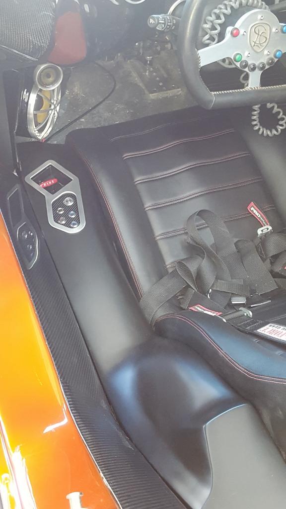

Did some finishing touches on the interior, finished the filler panels between the seats and doors installed another control panel for fuel pumps and in-reserve system.
Your interior is really coming along. I like the integration, and approach to the seating. The aluminum work for the trim is a great touch, especially as it ties in with the work on the console.
Thumbs up!
Thanks Guys, it was a lot of work lol
