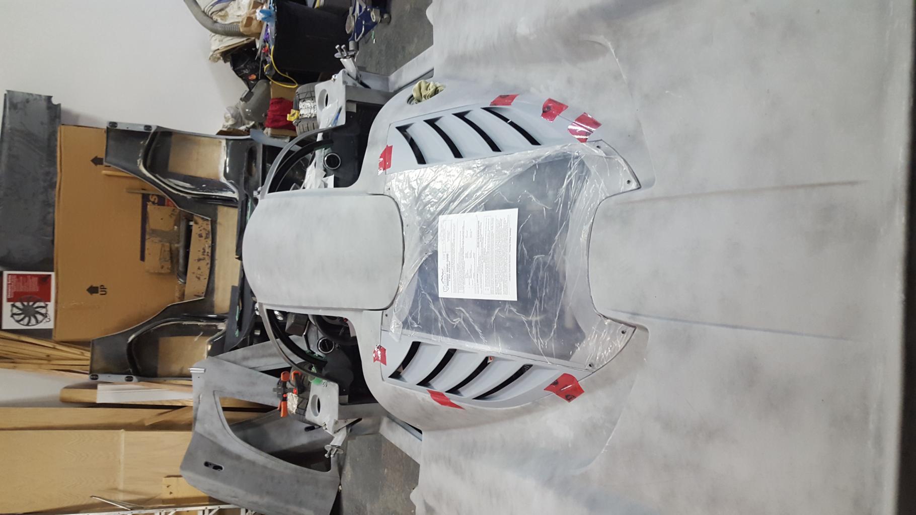

I broke down a bought the rear widow vents was hoping the Canadian dollar was going to come back a bit but things are looking like it was gonna get worse
So what the hell.
They do give the car a nice look and should work well at helping to keep it cool.

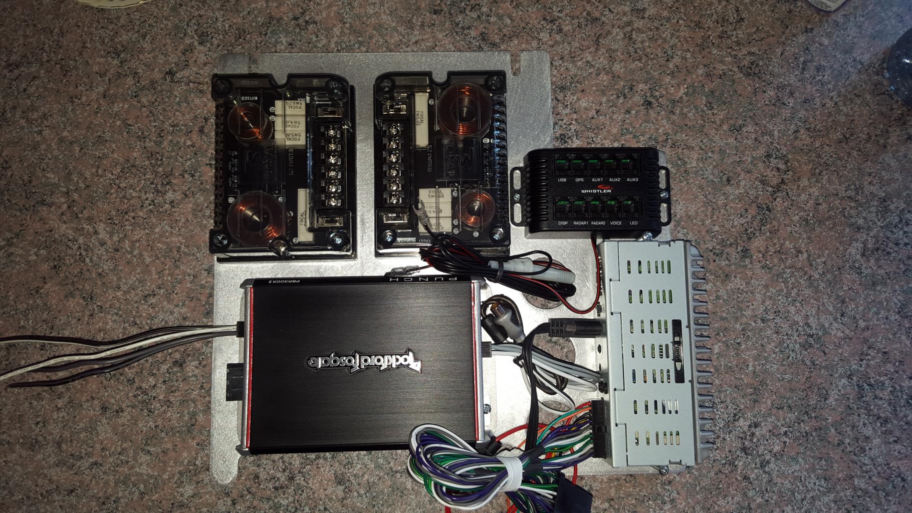

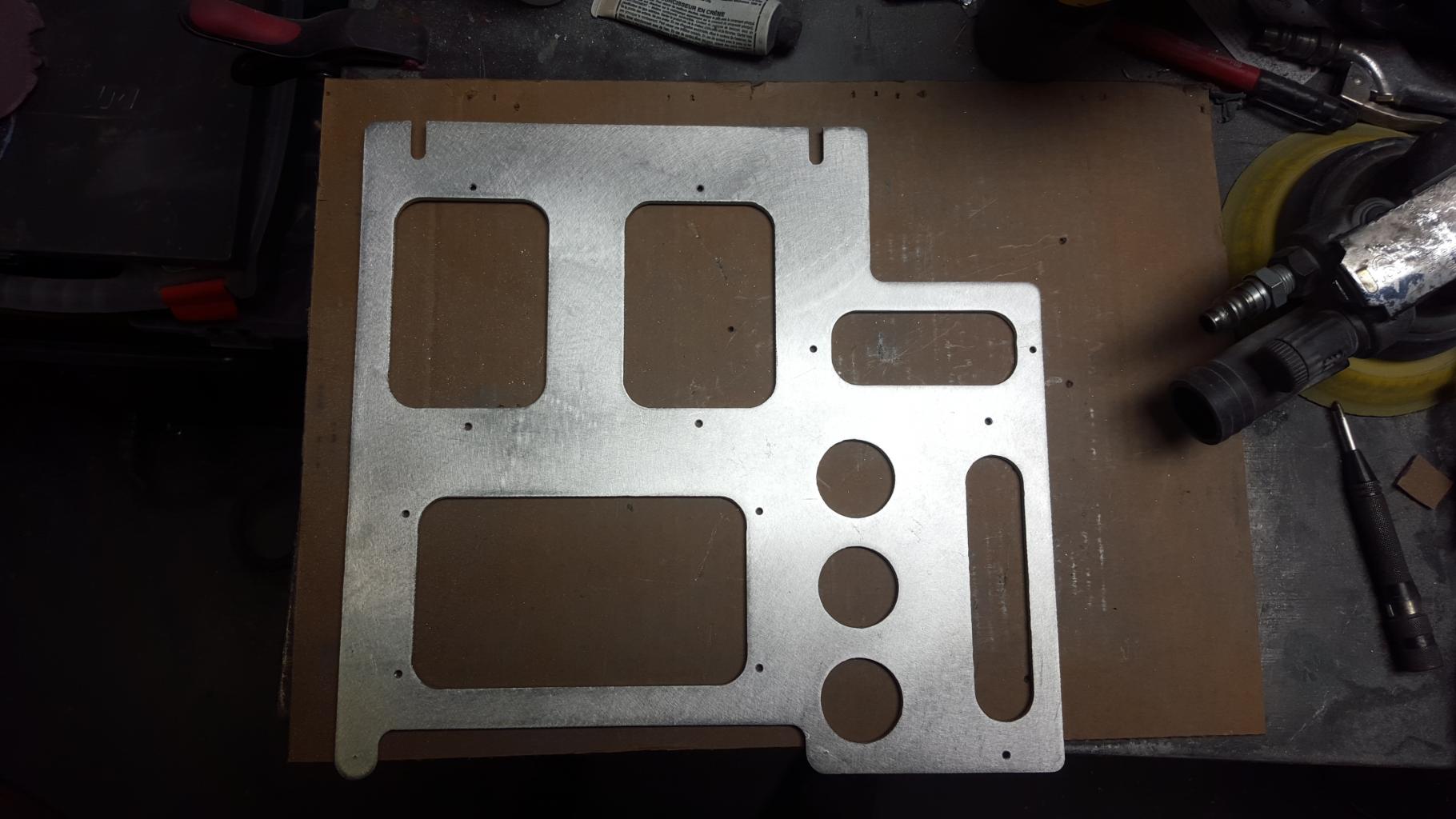

made some new pieces this one will hold all my stereo and radar bits under the dash and out of sight above the passengers feet using four stand offs.

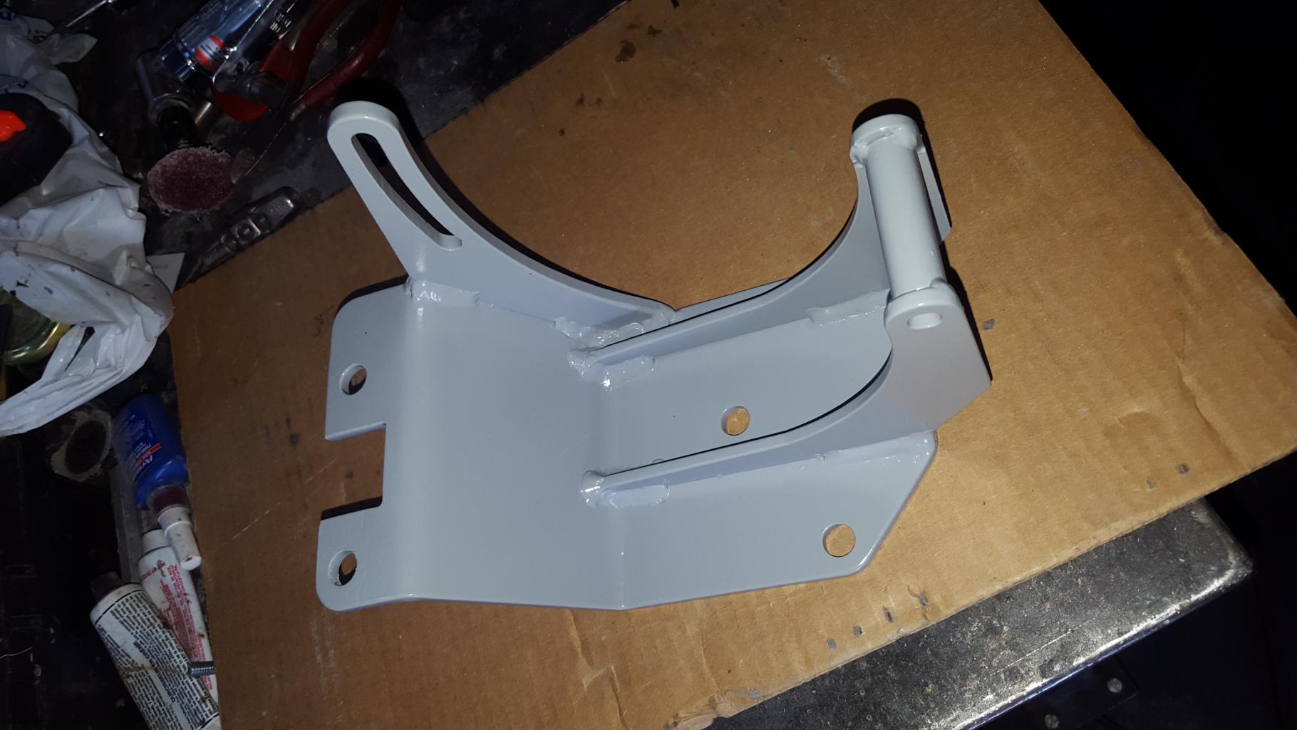

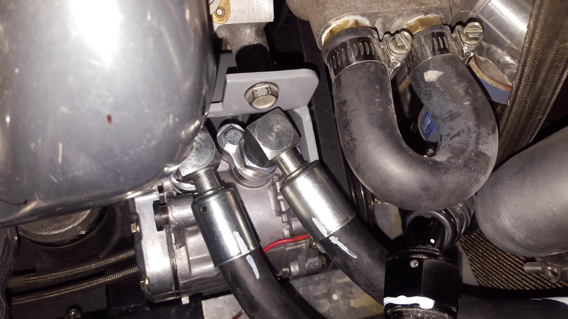

Had to make a new A/C pump mounting Bracket this one turned out much better then the first guess practice makes perfect. Just a little hint This way easier to do when you have the engine out of the car. Trying to do this after you've stuffed it full of goodies is like building a ship in a bottle and trying to get your arms in there with it.:shocked:
and yes that is blood on the exhaust manifold lol.
The hoses that go to and from compressor have to be between a 10 and 2 O clock if they are on the side as mine are.
With my old bracket they came out near the bottom which would have killed the pump in about a week as the oil would not have stayed in the pump.
Ken Roberts
Oh shit. I'm in the same boat. Looks like I need to make a new one as I didn't get a bracket with my kit purchase. I made my own incorrectly.
Ken I think I have the same compressor as you, if you need the drawing I have it in CAD
this new bracket fits perfect.

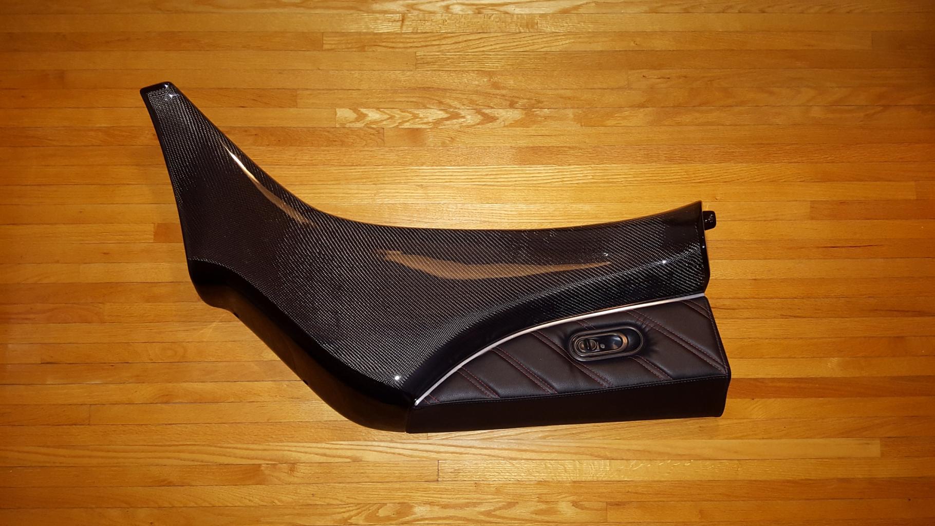

Just got my inner door panels back from the upholsterers the picture does not do them justice, next the new dash.

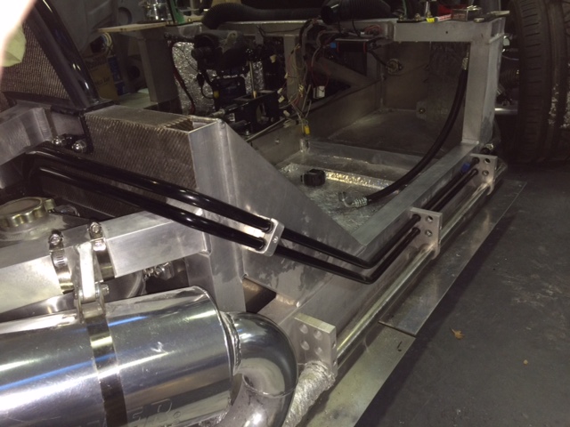

I finished making the A/C lines and they are in, pretty much it now for the mechanical part. A little wiring left to do and its off for the final body work and paint. should be rolling down the road this summer :)
