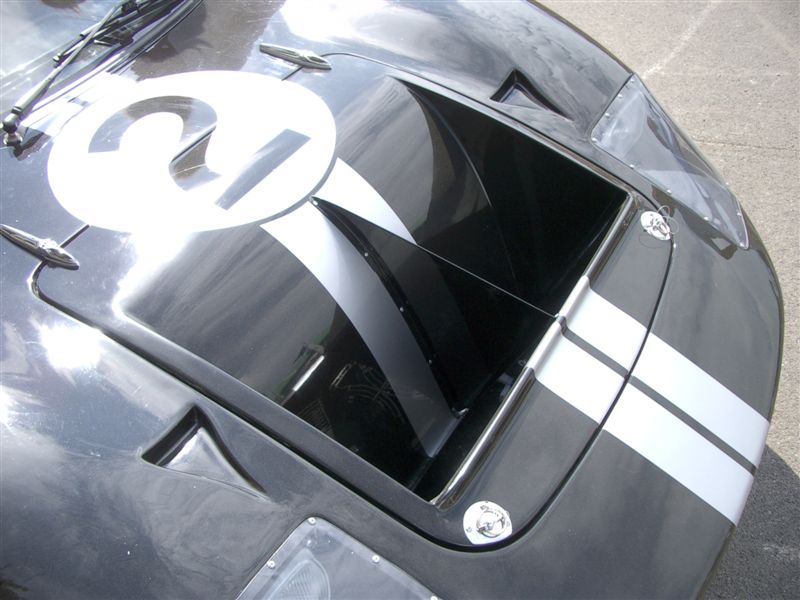

Here's a picture of the nostril on the Chris Melia/MDA Mk 2 at the Goodwood Rev. The ally splitter adds a nice touch...
Hi Guys, theres my car again! Nice Photo Julian! The Splitter Chris made for the black car is simple, but effective.Like Malcolm says above another mod is to dam the air through the rad so that it exits right into the Single vent and upwards over the front end. As most of the English guys will tell you, riding in a twin vent standard nostril car at 130mh watching the front end lift in front of your very eyes is facinating! It baloons to the point where you think it will burst open.. Then if youre really lucky and have a standard GTD with those stupid Dzus fasteners fixed on the wrong side of the body! The nostril panel will fly out, smack your windscreen and hit the rear end as it smashes on the ground behind you!! What fun that is, NOT. This is all due to the amount of Lift the twin vent panel kept under itself and therefore not allowed out of the front body areas.
