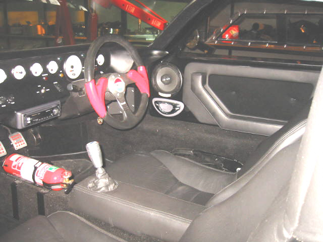

This GT40 has had a lot of money spent on it. Luckily for me the mechanicals are very close to what I would have done. The interior looks ok, don't love it, don't hate it, it will do for now. A lot of the body fittings are poor or inappropriate, so need changing. Also needs a paint, which means I can actually paint it a colour I like. This gives me the opportunity to get widened rear-end retro-fitted, change mirror locations, fit MKIII style windows, clean up ducts etc etc.

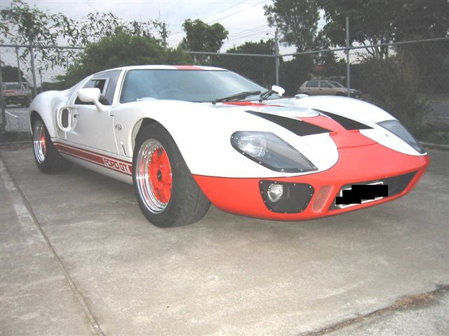

Here is a photo of it as it currently stands.

Ouch! Is that a PINK wheel? Apart from that, rebuild? Some people are NEVER happy! (lucky dog) /ubbthreads/images/graemlins/wink.gif
[ QUOTE ]
[/ QUOTE ]
The steering wheel is actually red/orange colour. Thinking it would look better if those hard plastic bits were painted the same colour as outside. Blend interior a little more with exterior. Will look for some other highlights I can also paint body colour to lift the interior.
On the rebuilding note, fit and finish just wasn't up to the standard that I would do. Lots to do...I can make the it look much better, drive much better, be much more comfortable, be more reliable. Just a much better car. And I can do most of it in bits and pieces and keep it on the road. And yeah, I'm pretty fussy. /ubbthreads/images/graemlins/smile.gif

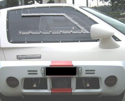

Image below is closeup of body fittings currently fitted.
Side windows with poor sliding sections and wrinkled tinting.
Side Mirrors that will become totally useles when wheel arches are widened.
No mesh on rear
No tow hook
Number lights that are not body coloured.

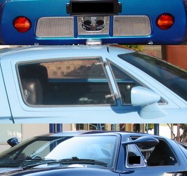

These are style of fittings I would like:
1. Rear grills like this fitted.
2. Side windows like this(except they won't have groove around them)
3. High mount side mirrors and also same style side windows with main window lifted out.

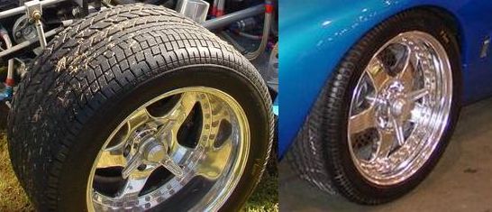

Wheels and tyres as detailed above, well I think the front wheels are only 8" wide. Haven't decided if I want to also fit the replica spinners.

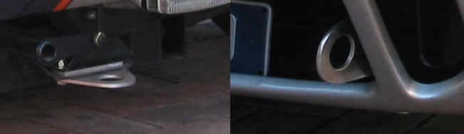

And finally tow hooks.
(sorry they have come up a bit grainy, they are smooth and highly polished)
GT40 Australia is supplying all the good stuff and even widening the guards for me. /ubbthreads/images/graemlins/smile.gif

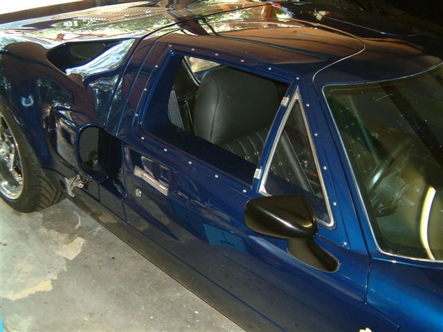

A couple of ideas :
- Re the side windows - I have the "MKIII" windows & they are great. You can get good ventilation & can even reach out to pay tolls ! The best part is that you can just take out the main window alltogether (I haven't had mine in since rego) - nice breeze & not too much turbulence at all. I kept my frames separate so that I can replace the whole show with the more "original" one-piece MK1 windows if needs be in the future (see pic).
Kind Regards,
Peter D.

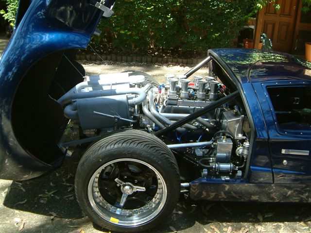

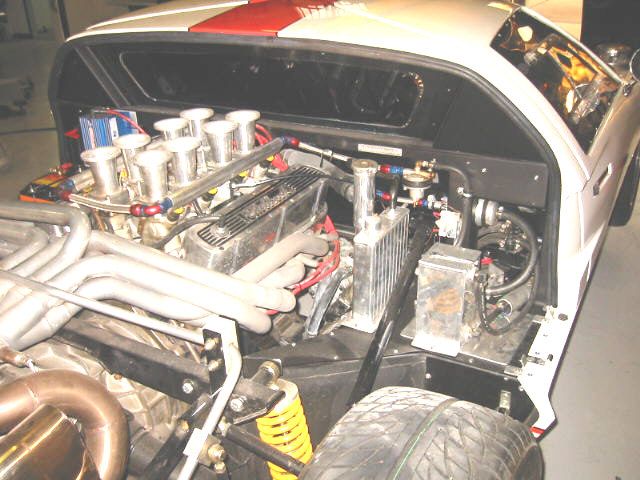

Peter Delaney
Next idea - re the Simmons wheels. I did a lot of thinking & looking, & finally decided to go with these, but with black centres. My reason was that I thought the spinners got a bit lost in an all-polished setup & that the black centres made the whole setup look a bit less "modern". (See pic, but please ignore the horrible temporary exhaust !!).
I am also planning on making up some cover plates for the wheel nuts so that they look a bit more like pin-drives.
Just some food for thought.
You are in for some serious fun !
Kind Regards,
Peter D.
