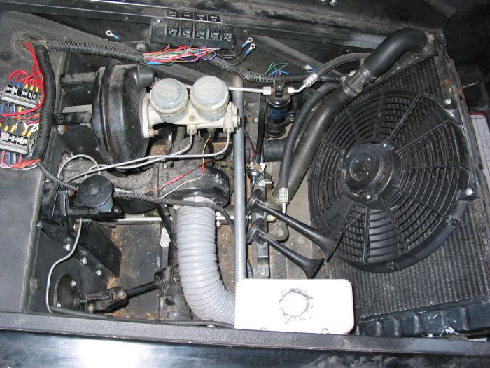

Just thought I would include a photo under the front clip. Wow, what a mess. /ubbthreads/images/graemlins/smile.gif
Needs a tidy up and decent detail. Should look the part then. Another job to add to the list.
