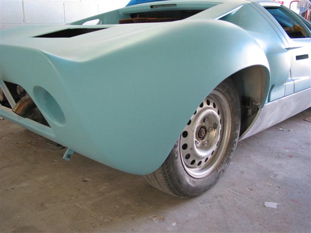

Rear shot...I have just finished trimming up the guard lip to match the lip on the guard. The lower sill had to be built up to match the clip, so ended up with a very wide guard lip on lower sill.

Craig, welcome into the fold. Your fit lines look very good. This is the real test of a home built GT40. By home I mean you did the body youself. Good work!
Thanks Howard. I've also been sneaking the help of the same professional for fit lines. /ubbthreads/images/graemlins/smile.gif When I bought the car(complete) the body was pretty straight, but fit lines were shocking. /ubbthreads/images/graemlins/shocked.gif Yep, this is by far the hardest part. The fit lines are not perfect and I've got to make a call when I am happy enough with them. Will do a final fit-up over next few days and decide if they are good enough. I've still got to fit spigots to front clip. I'm pretty fussy, but you can get anal about these things.
I've just been doing the easy stuff, labour intensive stuff. Which there is plenty of. /ubbthreads/images/graemlins/smile.gif I've put a lot of hours into that body. Couldn't afford to pay someone to do all that work.

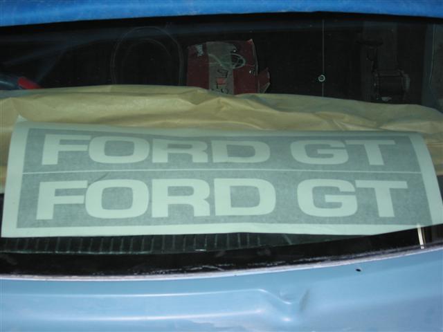

Here are the decales for sill stripes. These are reverse templates and writing will be spray painted on and of course the stripes masked up. Haven't decided whether I'm going the twin stripes on new GT or wide and 2 narrow stripes each side of old GT's. Decided that I like the lettering the way it was done originally(solid), so meant that the template could be ordered at least.
I'll leave the decision about the type of sill stripes, to the very last minute. /ubbthreads/images/graemlins/grin.gif

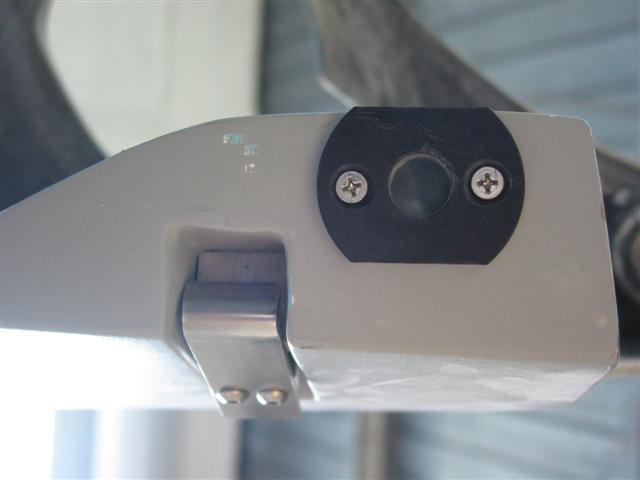

Photo of spigot bush(female part) on the front clip. Earlier I posted a photo of male part of spigot.
The spigot bush is made from nylon and has a raised centre area that locks into clip and gives spigot some extra depth. I bought spigot kit from DRB factory.

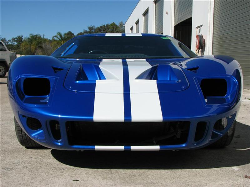

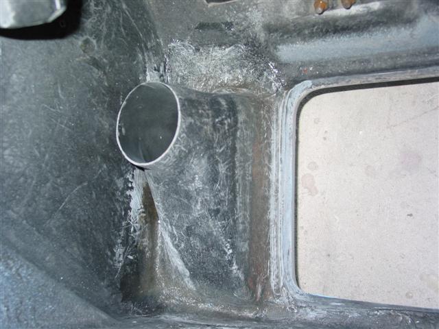

Here is a photo of front brake air intake ducts that were glassed onto the body. DRB GT40 comes from factory(and by looks of it hasn't changed) with housings glassed in to mount indicators in brake duct holes.
I've decided to retrofit brake ducts. Did not buy the factory kit as I wanted 3" brake hose. So made up some ducts from mould supplied by local brake shop. I've started to regret the decision of 3" ducts as these were very hard to squeeze into front clip, fingers crossed I can engineer the 3" hose into the equation as well. /ubbthreads/images/graemlins/confused.gif

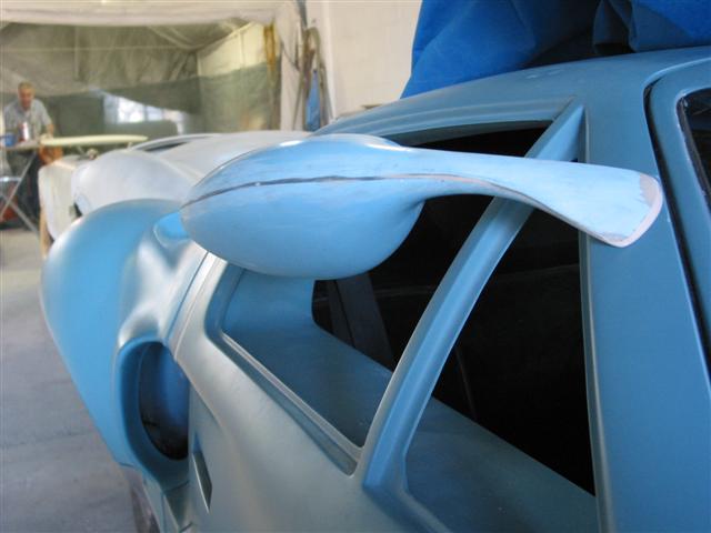

And finally the mirrors fitted. These are the high mount DRB mirrors, available in manual or electric form. Mine are manual. May not be original looking, but they give fantastic vision to rear. You can actually see over the rear clip and help with rear vision directly behind the car, even when setup for standard rear vision for lane changing.
I considered these essential once the Gulf guards were fitted.

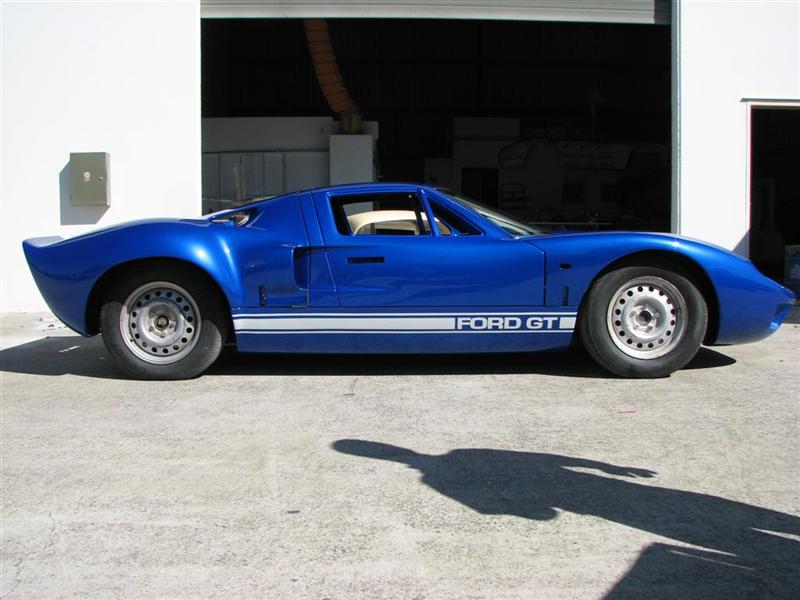

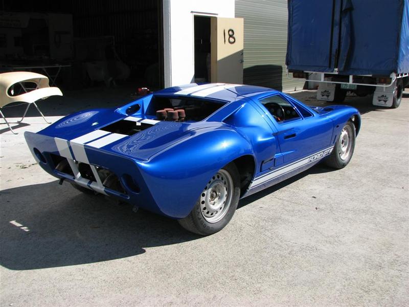

Here are a couple of shots of the rear clip painted.
Subaru WR Blue Perl. Paint Code - 02C
Subaru Artic White Perl stripes (has white base and separate perl/mica coat, then put clear on). Paint Code - 36J.
Stripe Width: 170mm with 40mm gap.
Also paid a bit extra labour to get stripe edges rubbed back so that they would be semi-smooth - no hard edges.
As you can see, definitely not building an original looking GT40.
Will post more when I have more photos.

WOW!! That is beautiful! You have done a terrific job rebuilding that car into a real show stopper. Please keep the pictures coming.
Bill D
Drb Gt40 #32
I LOVE Blue with white stripes! I can't wait to see some more photos of the rest of the body.
Keep up the awesome work.
Jack
Thanks guys, I'm absolutely stoked with the results. :)

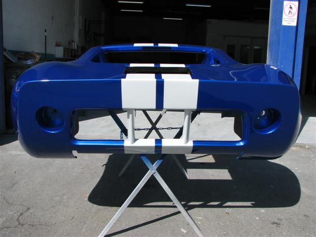

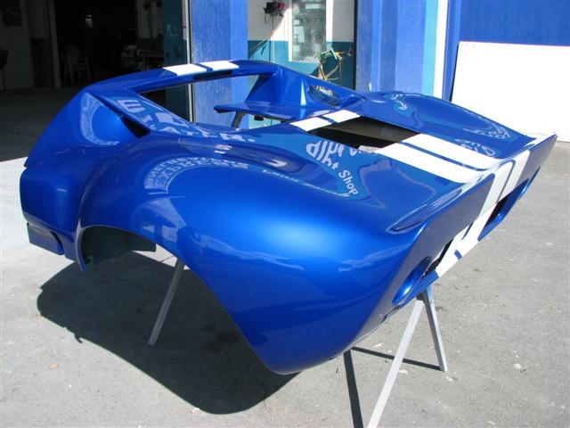

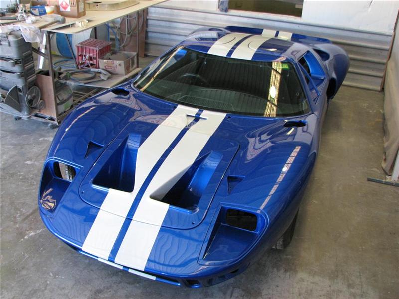

The front clip is finished as well. And looks even better than rear. I just forgot to take my camera the last time I was there.
Just waiting on clear for spider, doors, bonnet etc. My painter is going away for an extra long weekend. So won't have any more news to late next week.

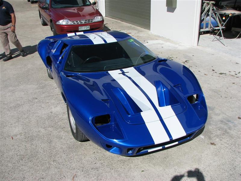

Finally got some more pictures of the body work.
All I can say is WOW!!! It is absolutey stunning. I am very, very pleased with the paint work. You would think I was building a show car. ;)
Spent all day today with the body guy, removing panels, masking up and stone guarding under sides. Then they will get a hit of gloss black. Back for another full day of work tomorrow, which should nearly finish it off. Except for black inside brake duct & napa duct holes, will it never finish.
Should be back in my garage early next week. Which is a huge achievement considering how long it's been away...don't even ask. Can't believe how many hundreds of hours I put into the body myself and I paid someone to do most of the work.
I thought I had a good photo of the perl in the stripes, but camera didn't capture it. Stripes are white base with 3 coats of perl/mica so that they match and blend with the main colour.
Oh and did I mention that it has not had it's final cut & polish. Painter will be back next week to finish it off, just in case we get overspray on it.
