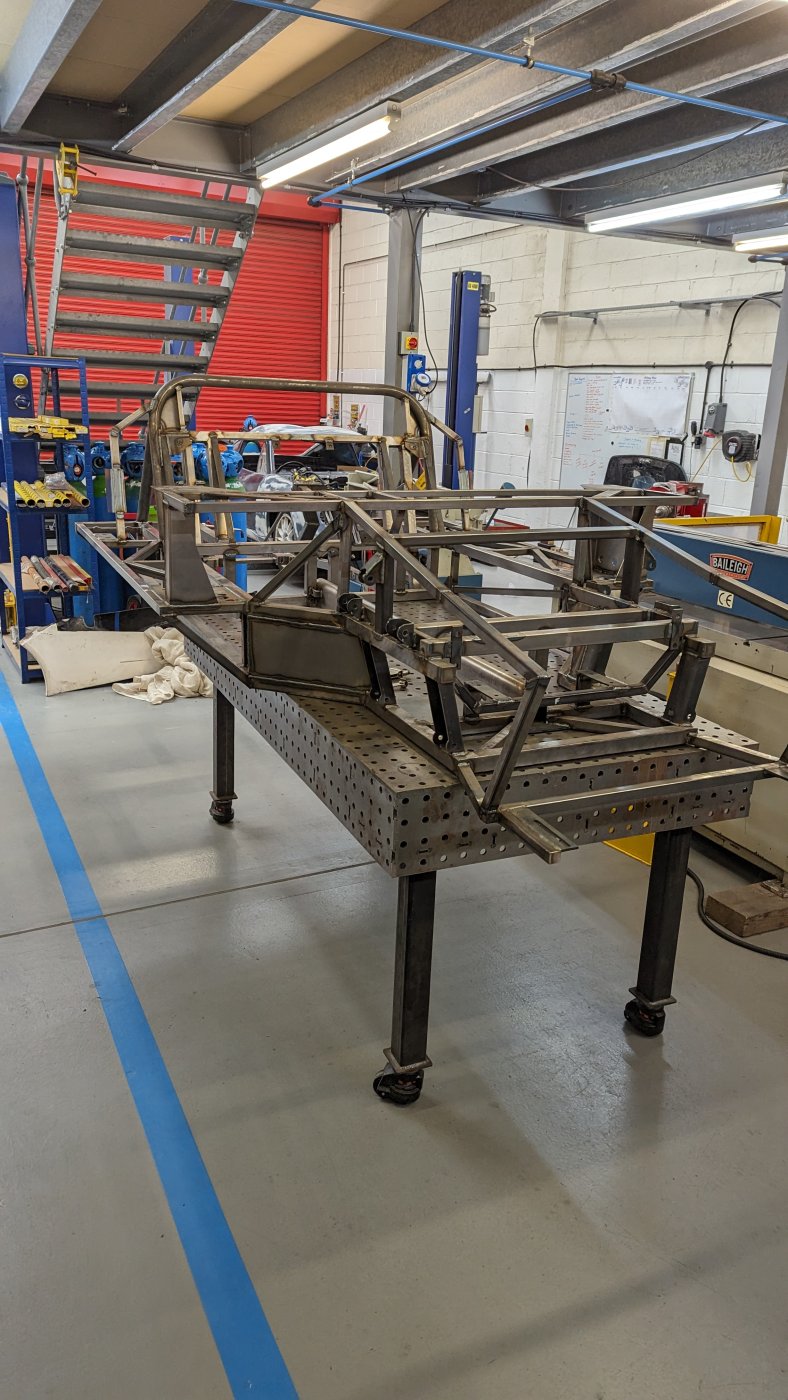

GT40 Mk1 Build (AK)

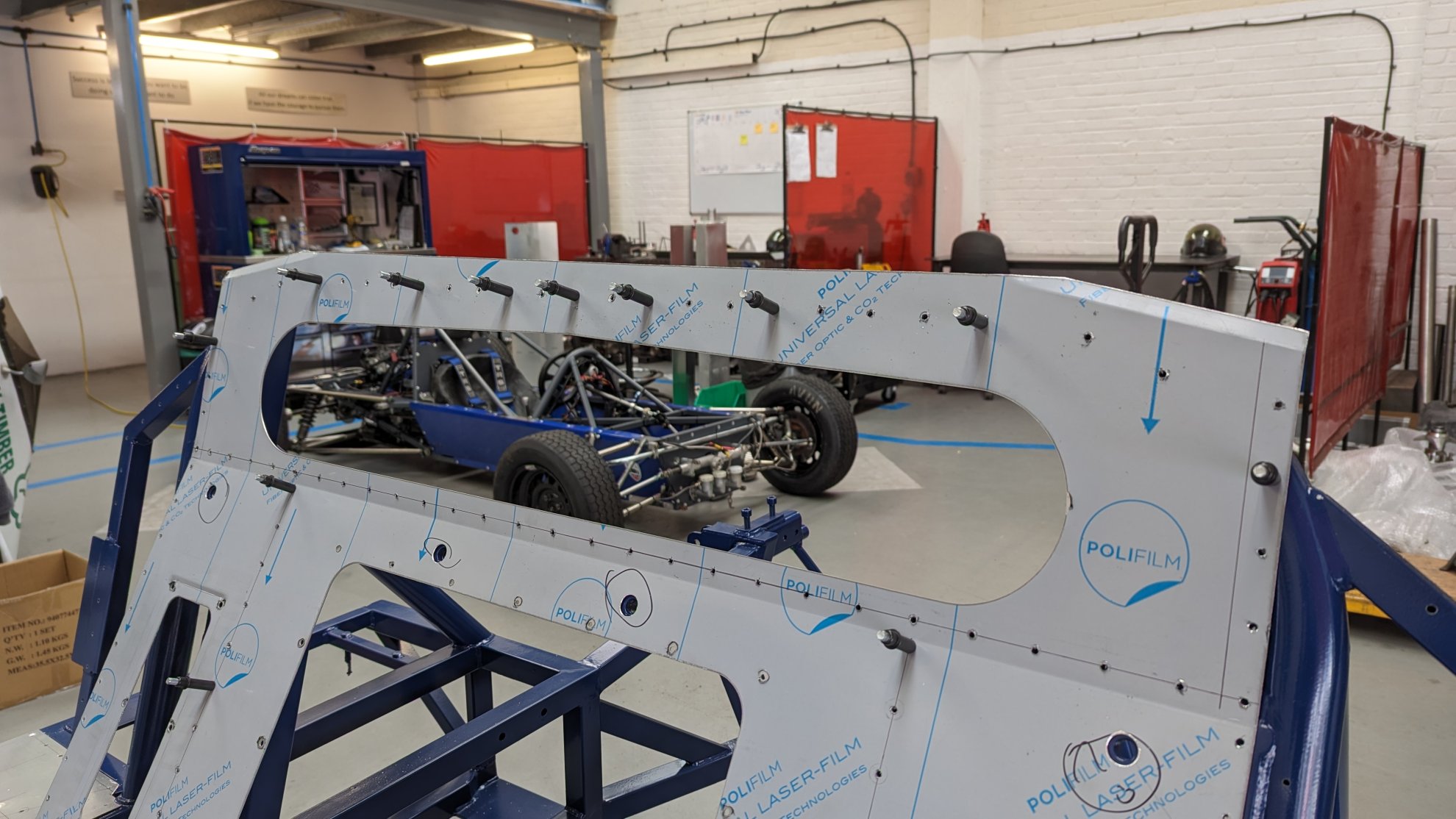

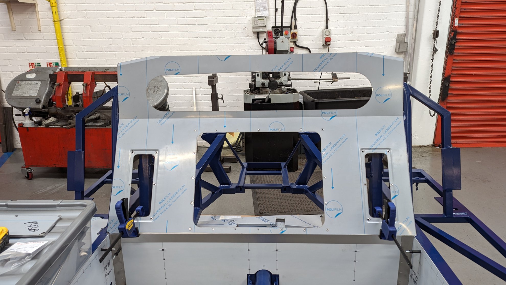

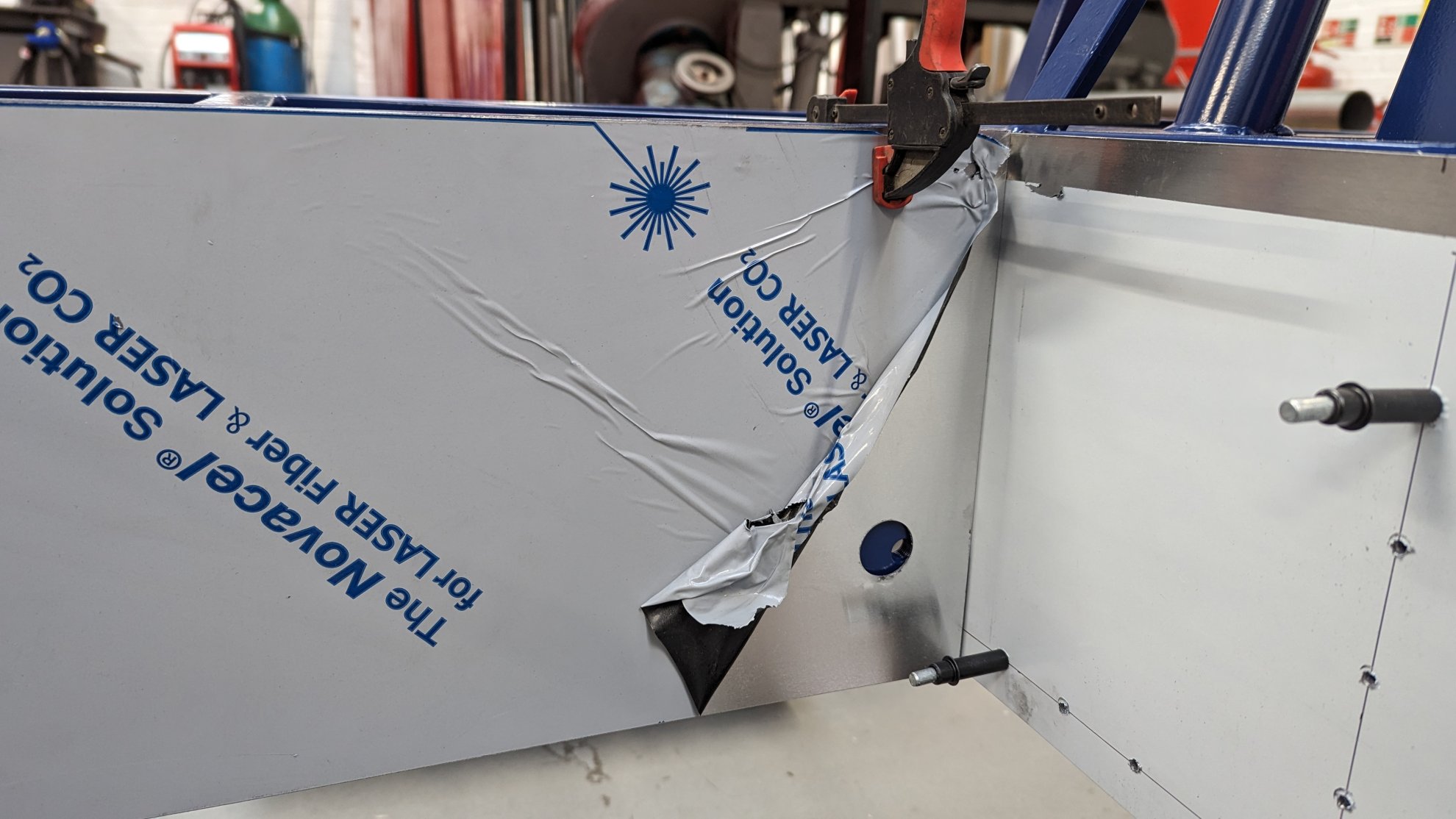

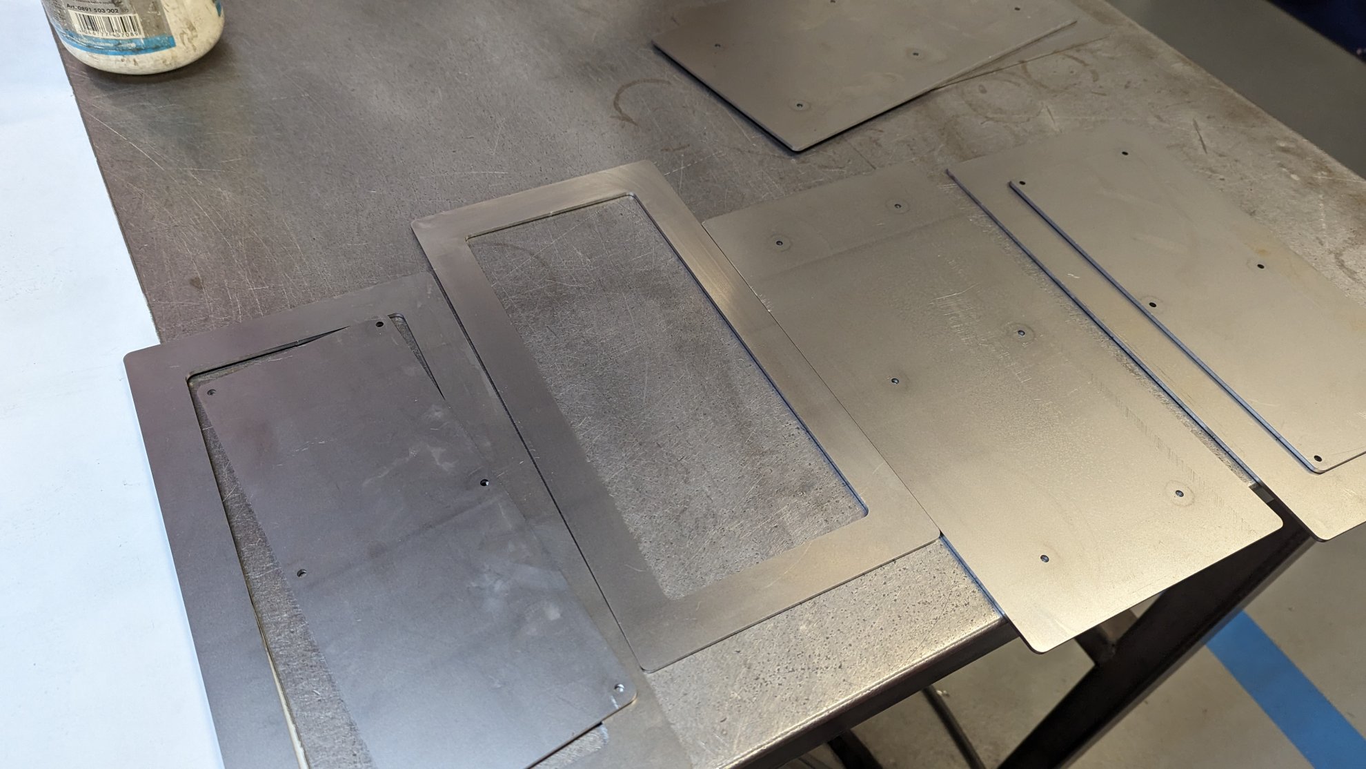

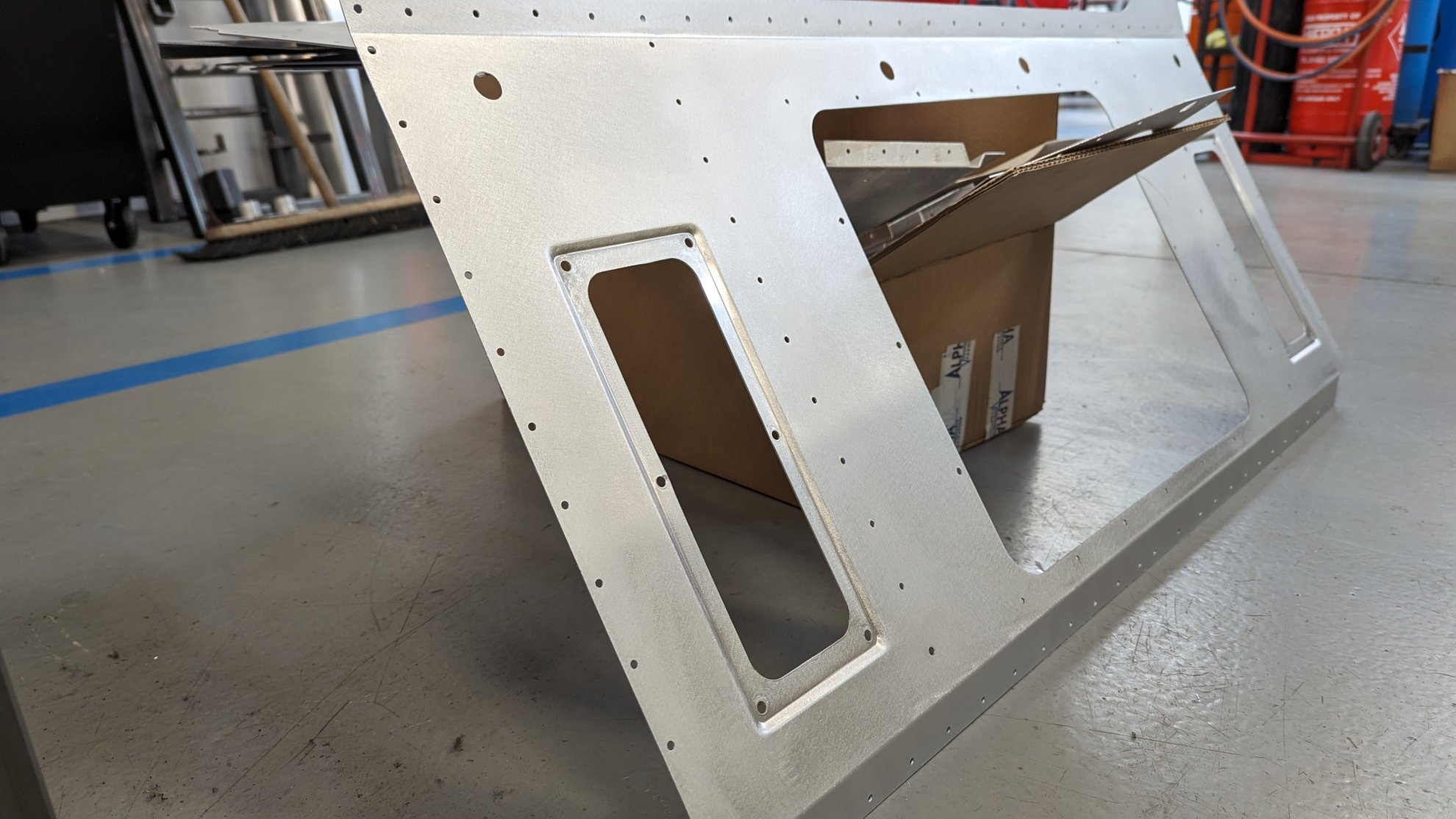

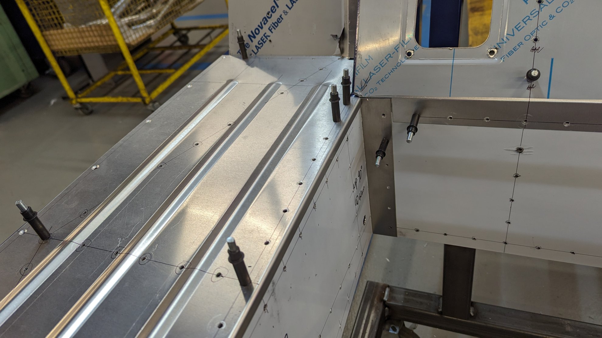

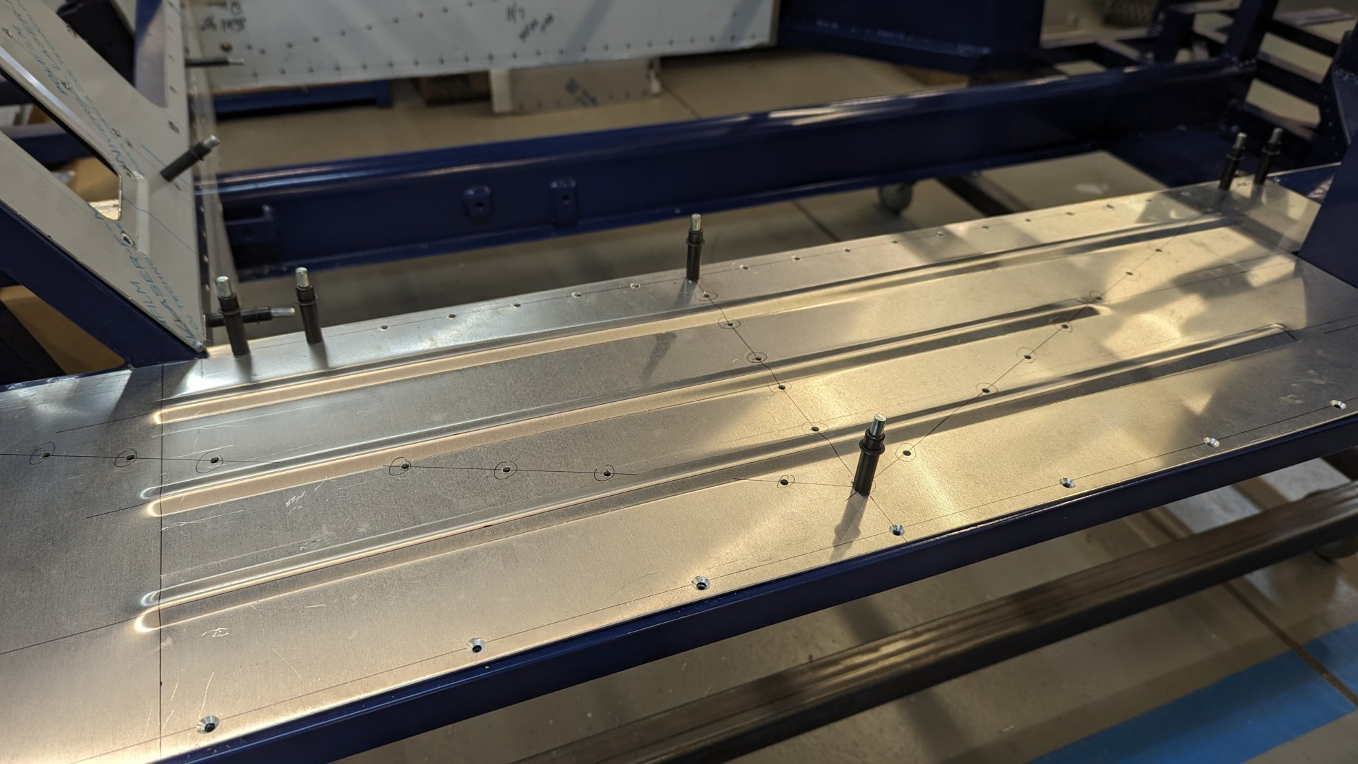

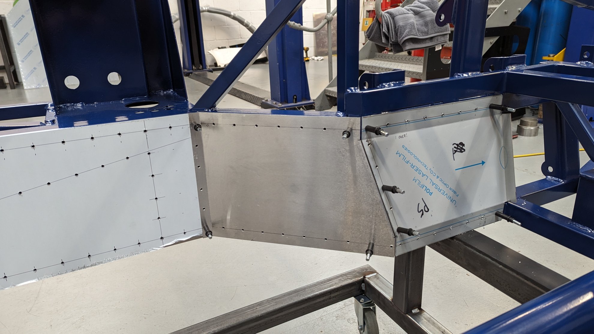

I decided to remake a couple of panels here. Mostly because I thought they would fit better if they overlap differently to how they were originally made..

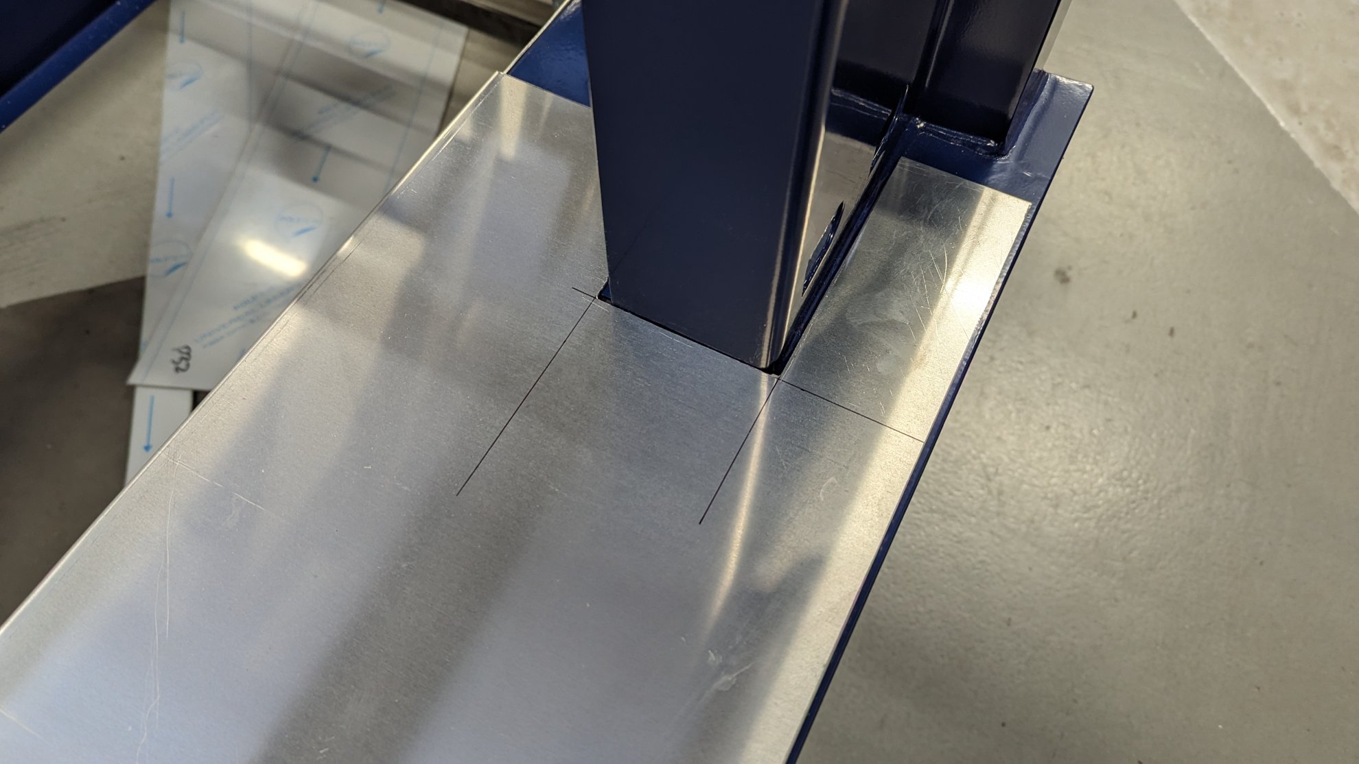

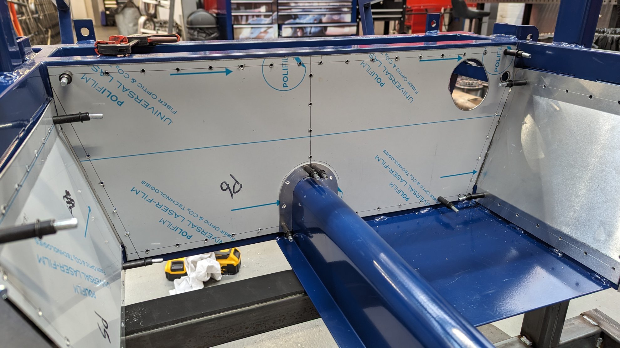

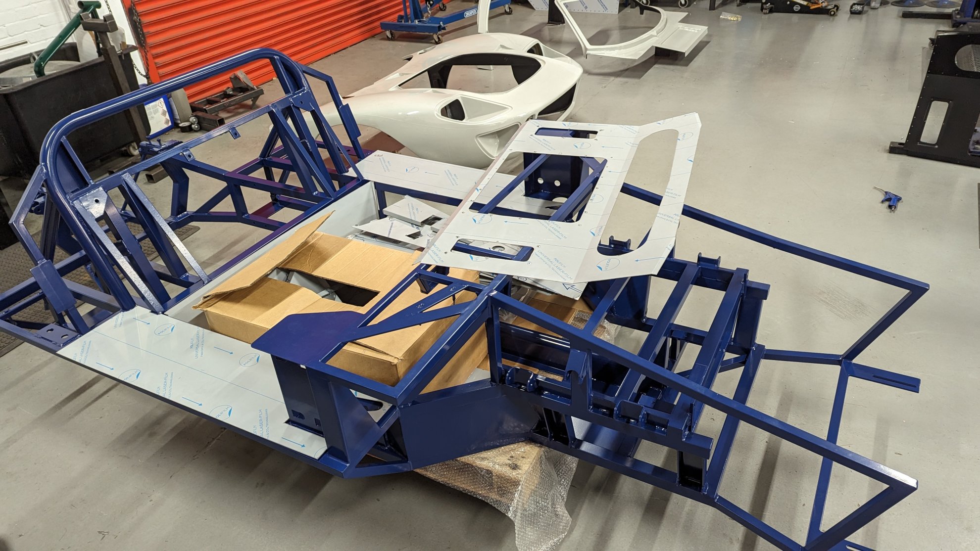

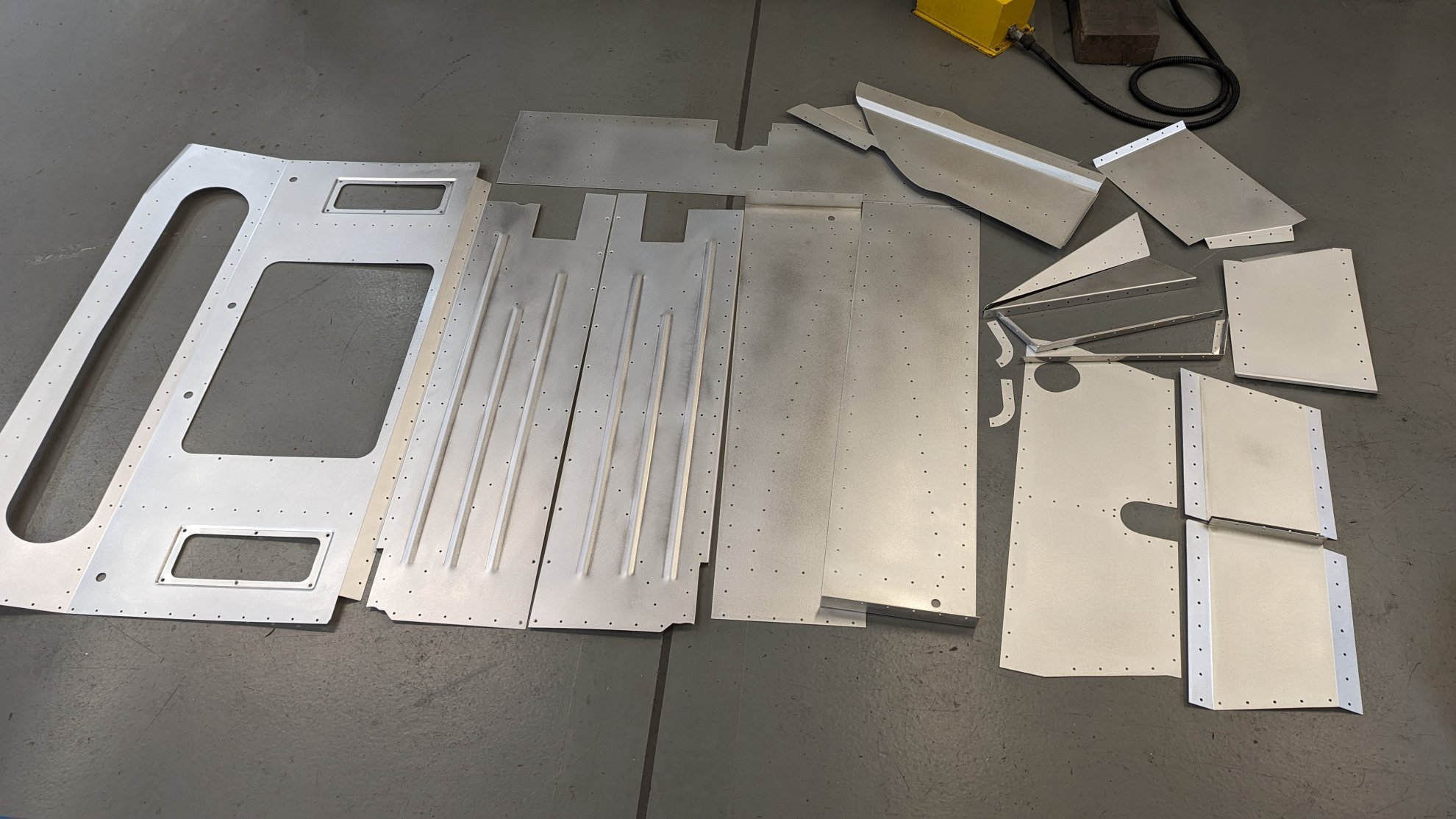

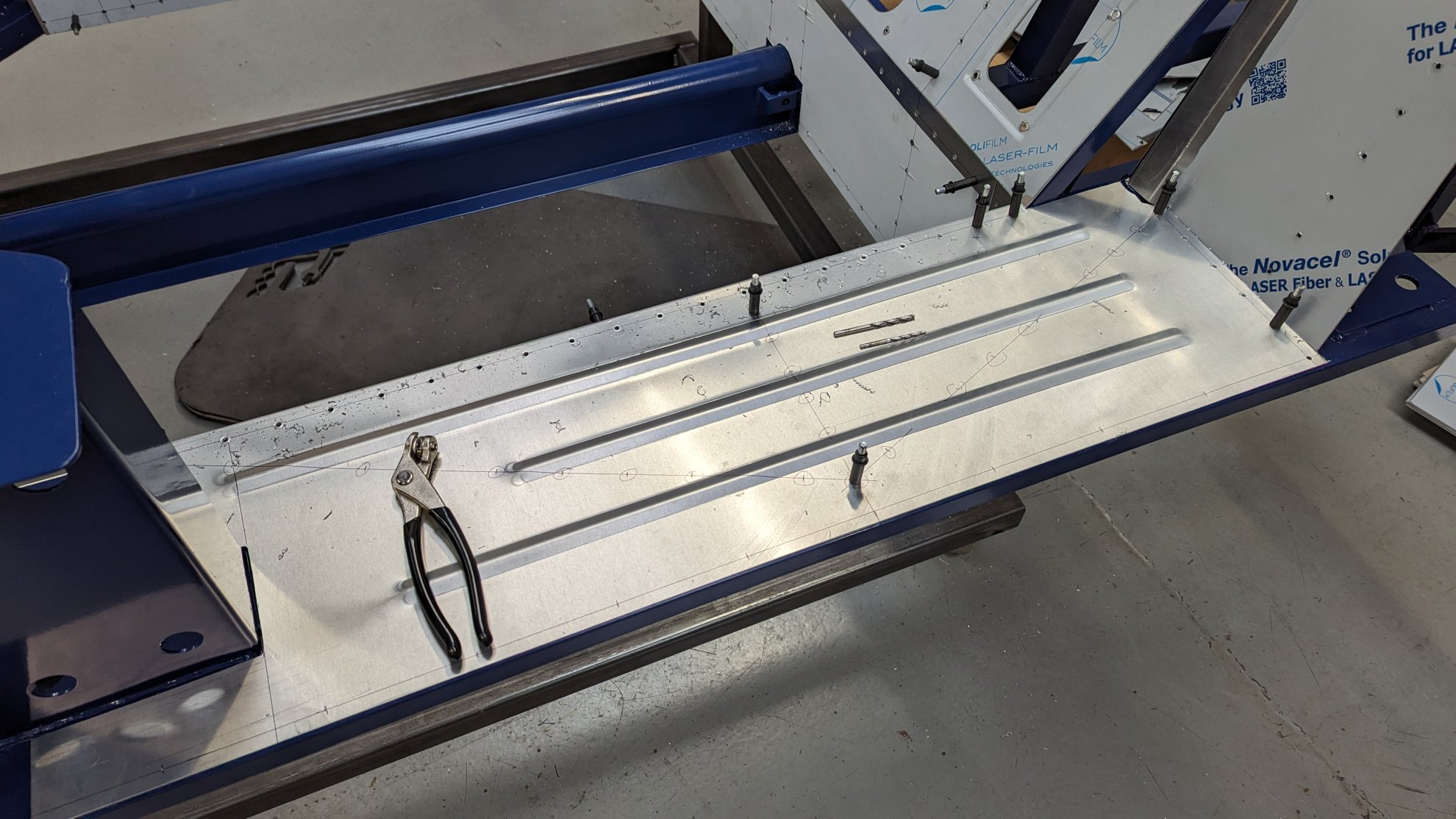

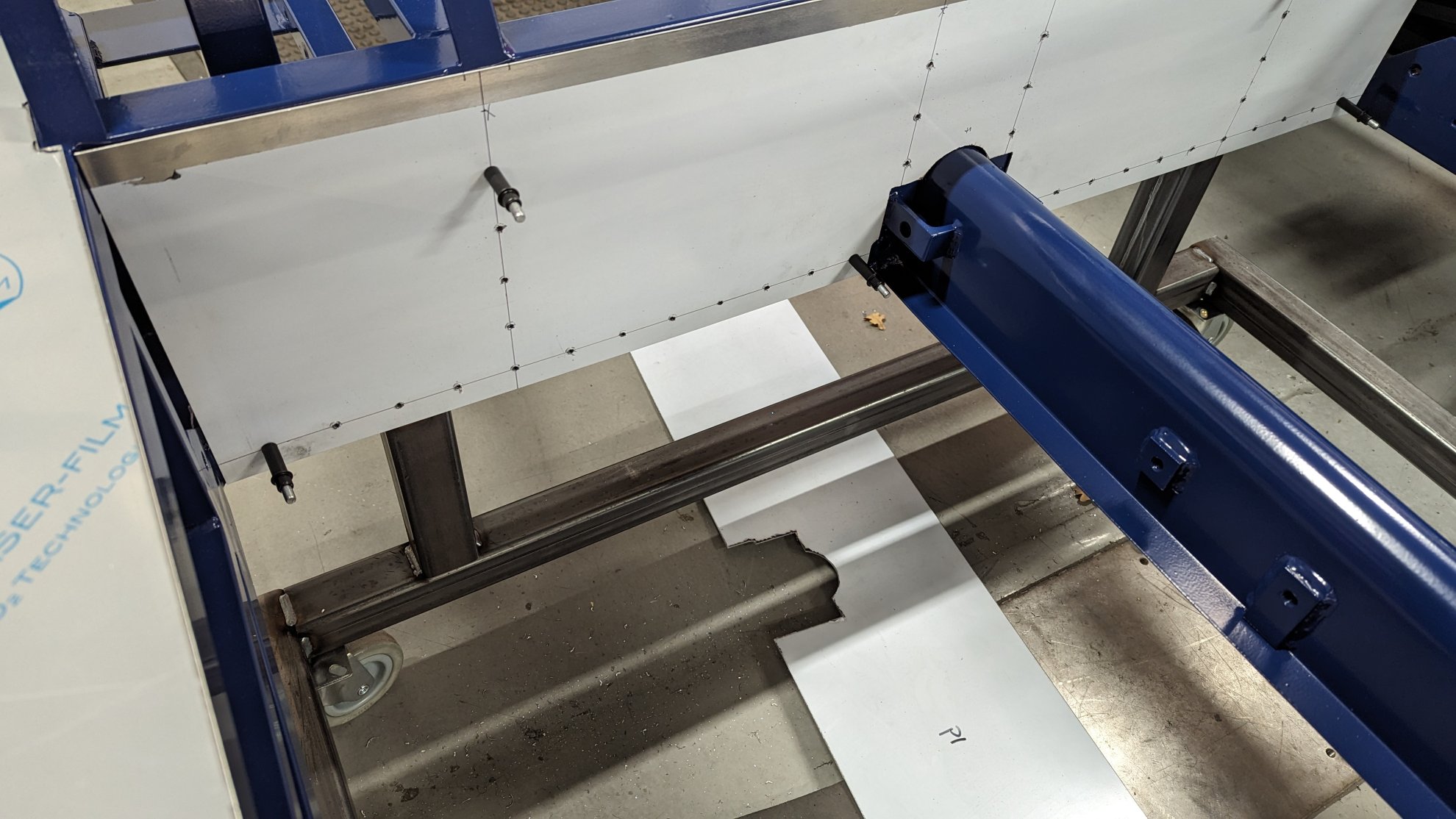

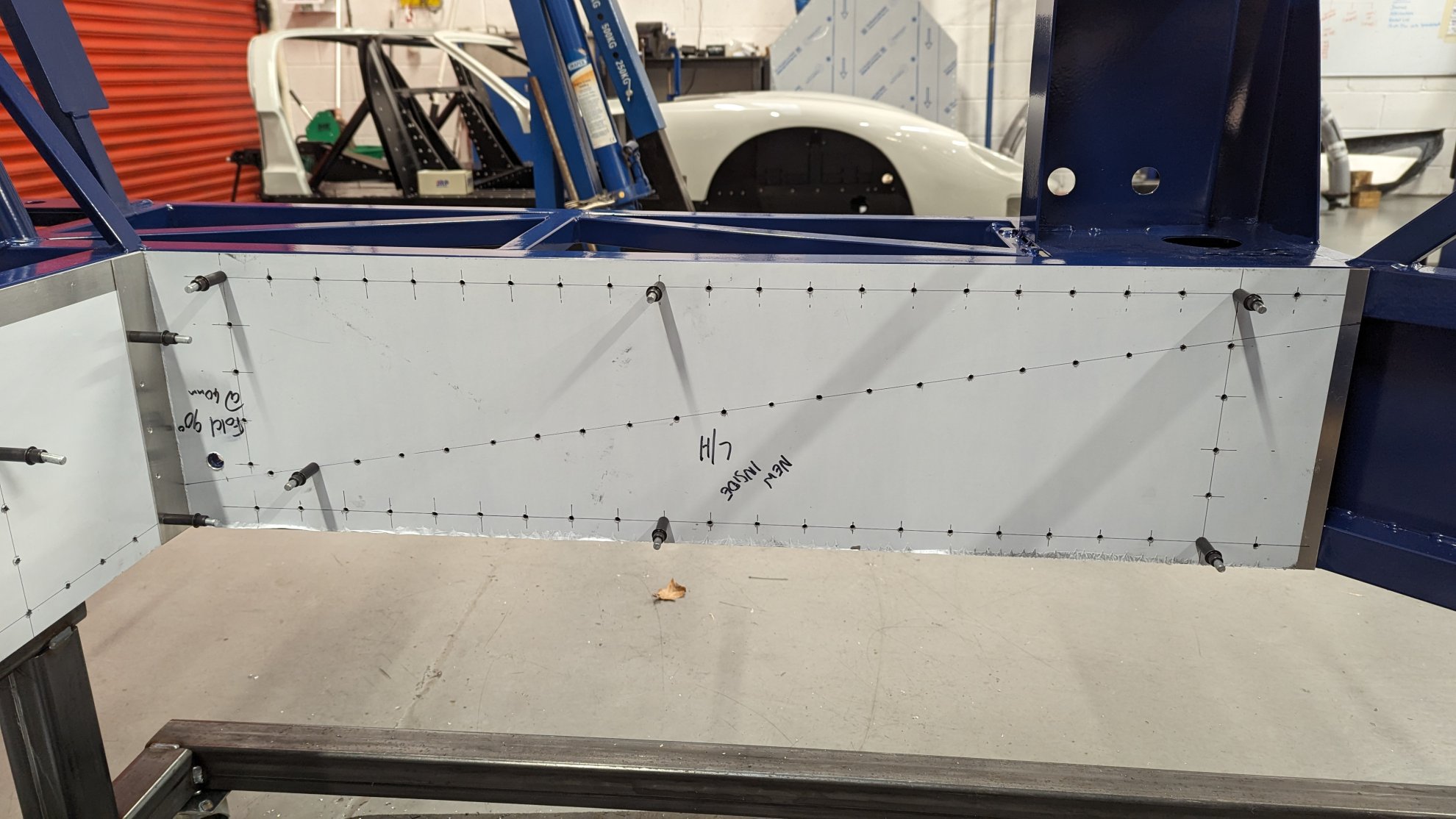

Will do my best to keep pics of the panels in the order that they were fitted

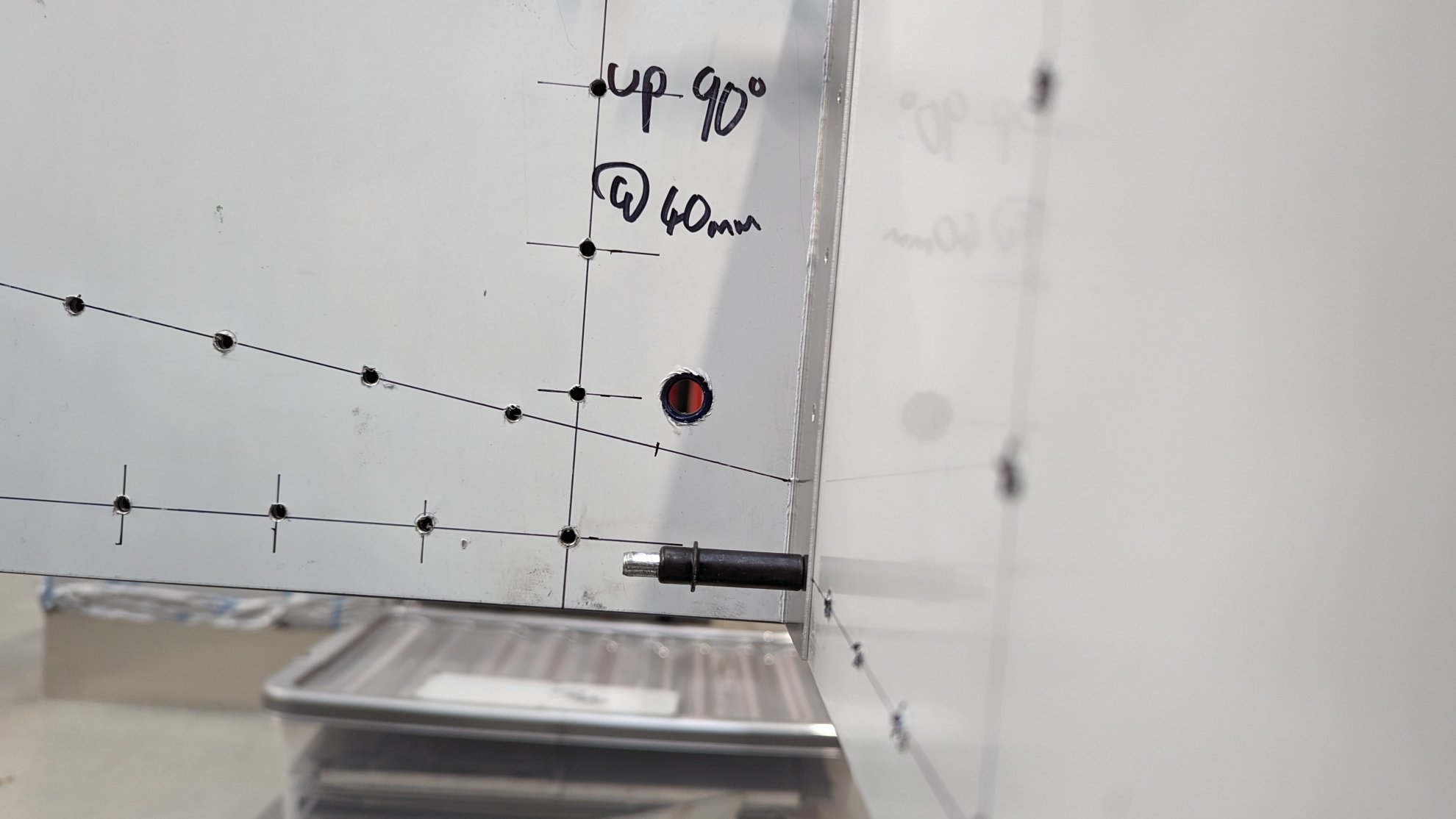

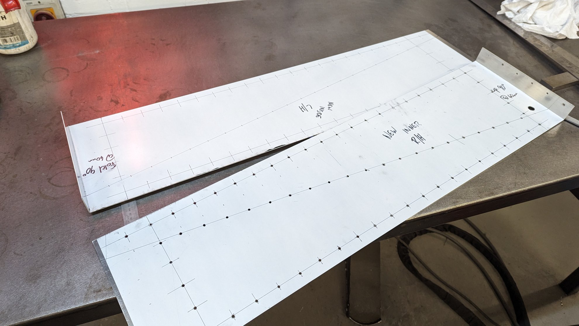

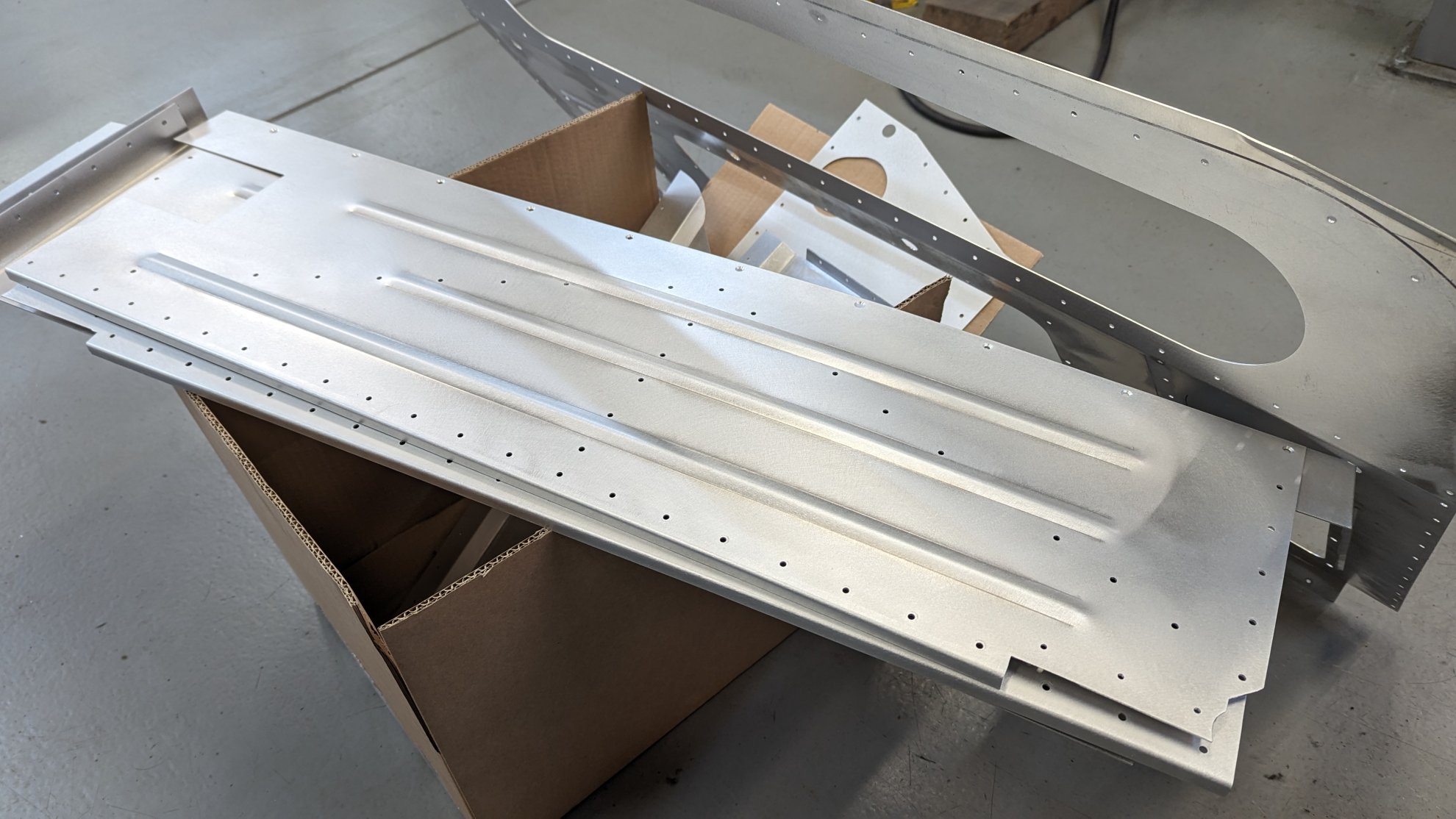

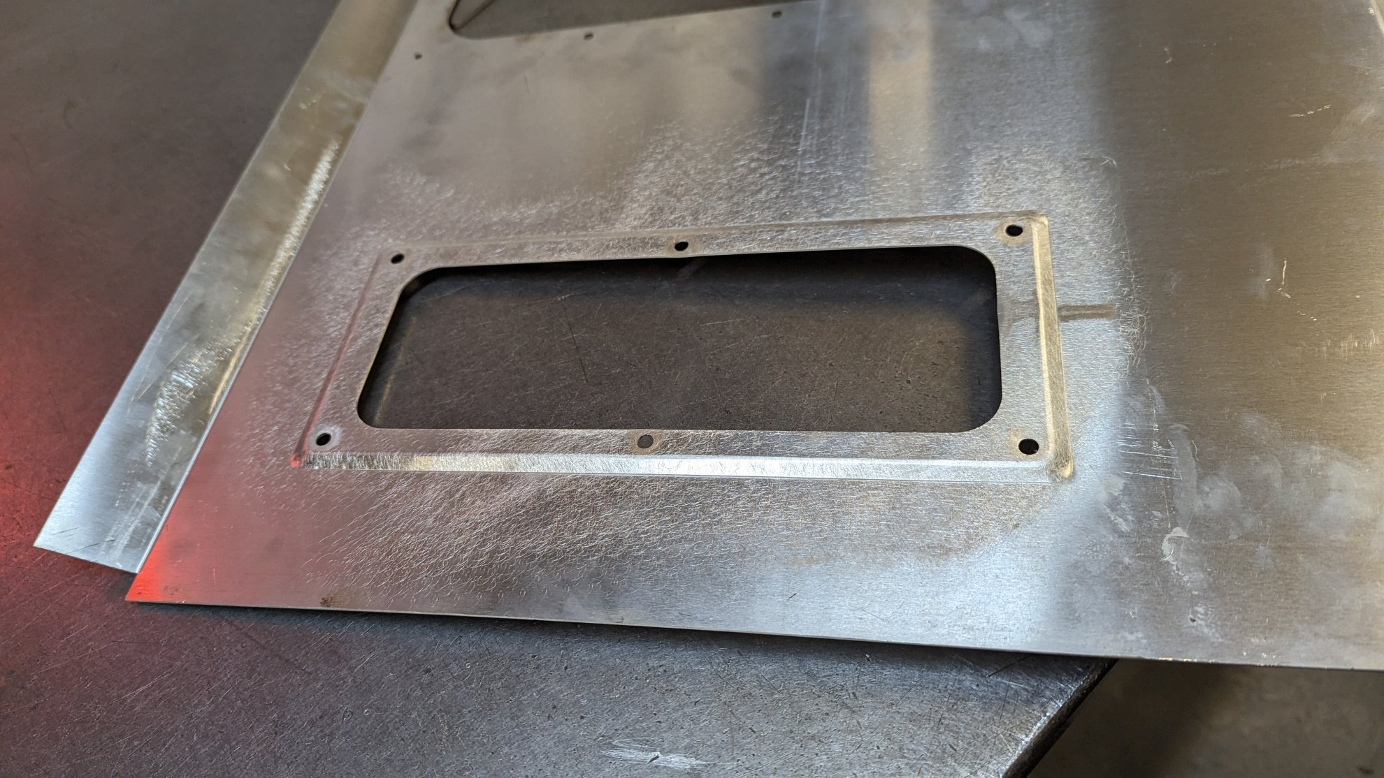

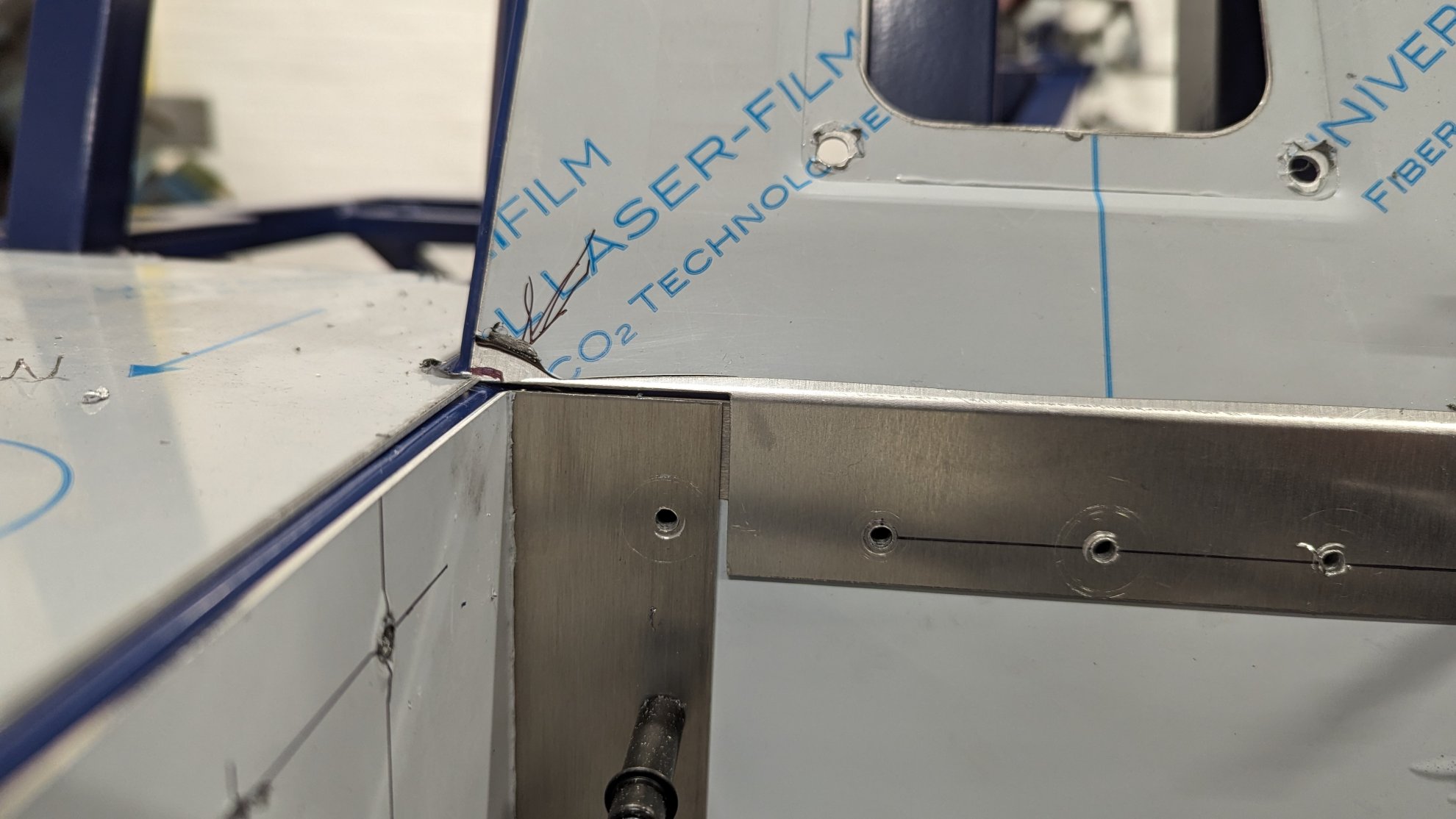

Not too happy with the fit of some of these panels. I also want to add the swage lines as a nod to the originals

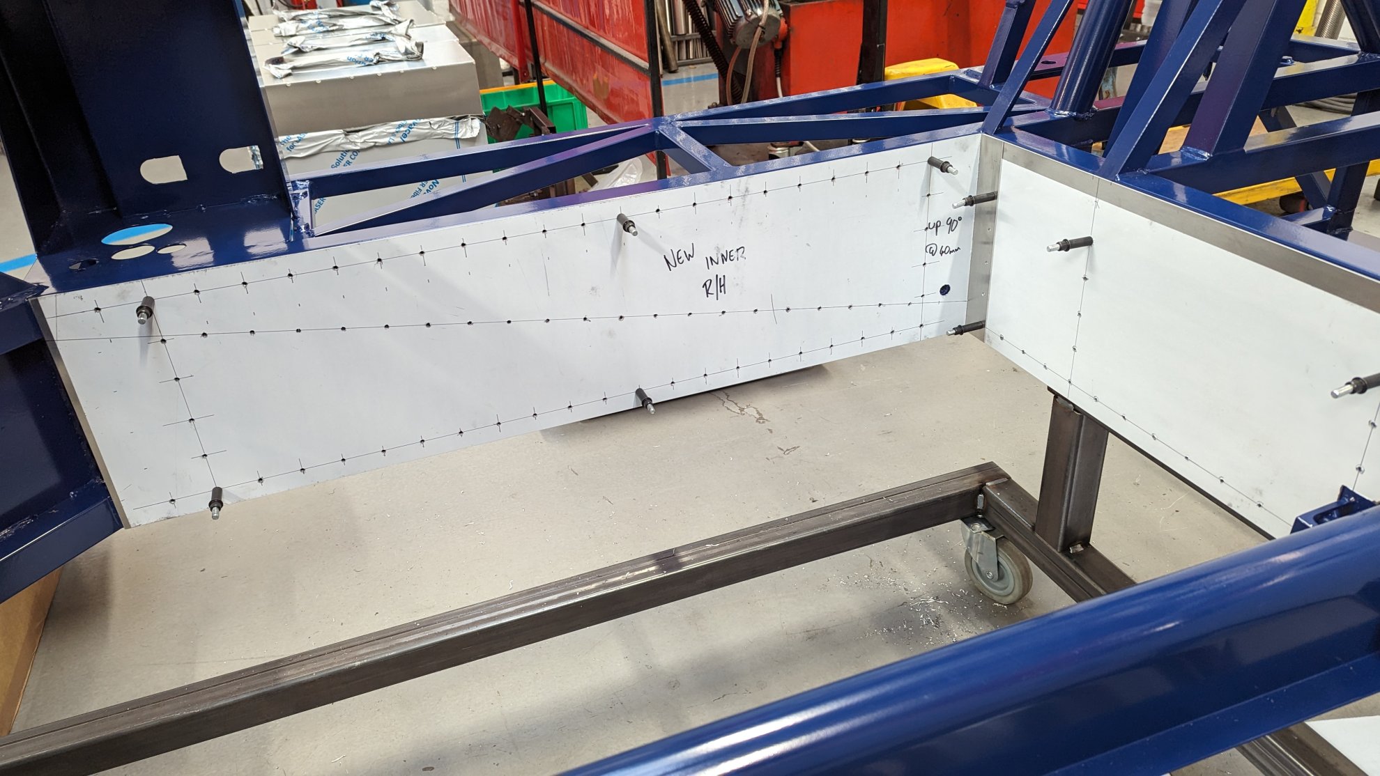

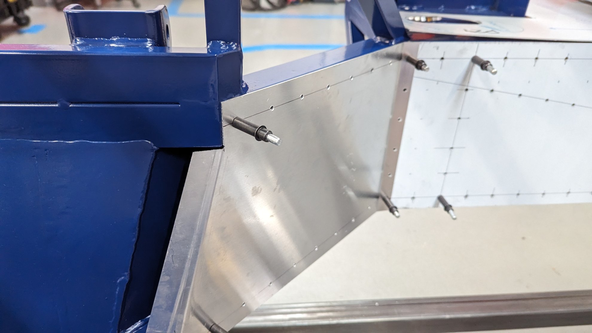

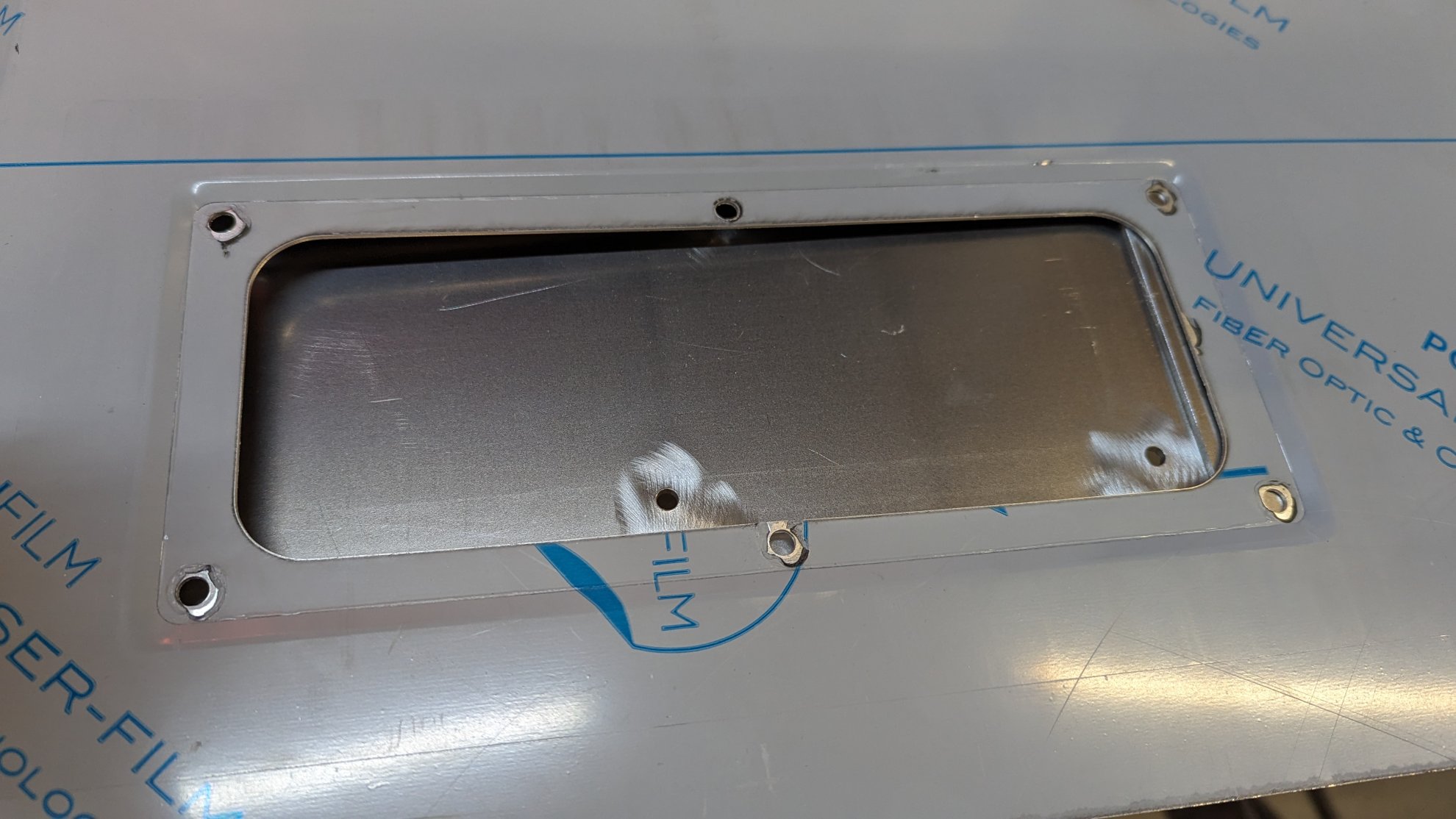

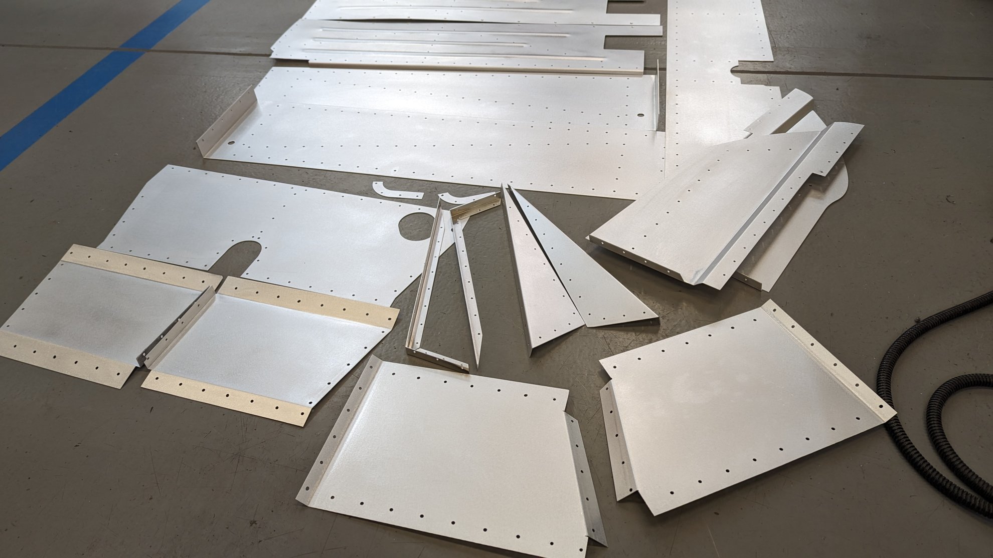

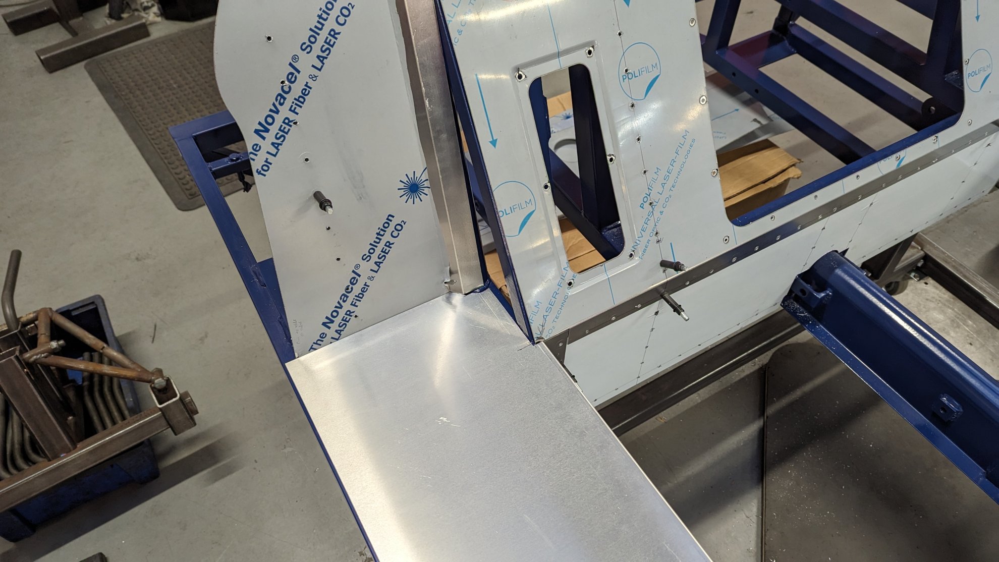

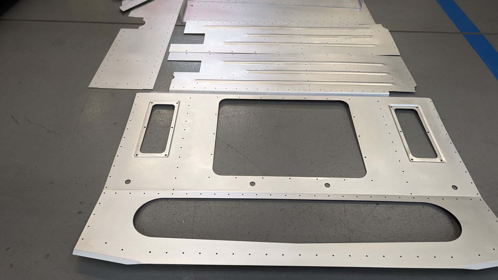

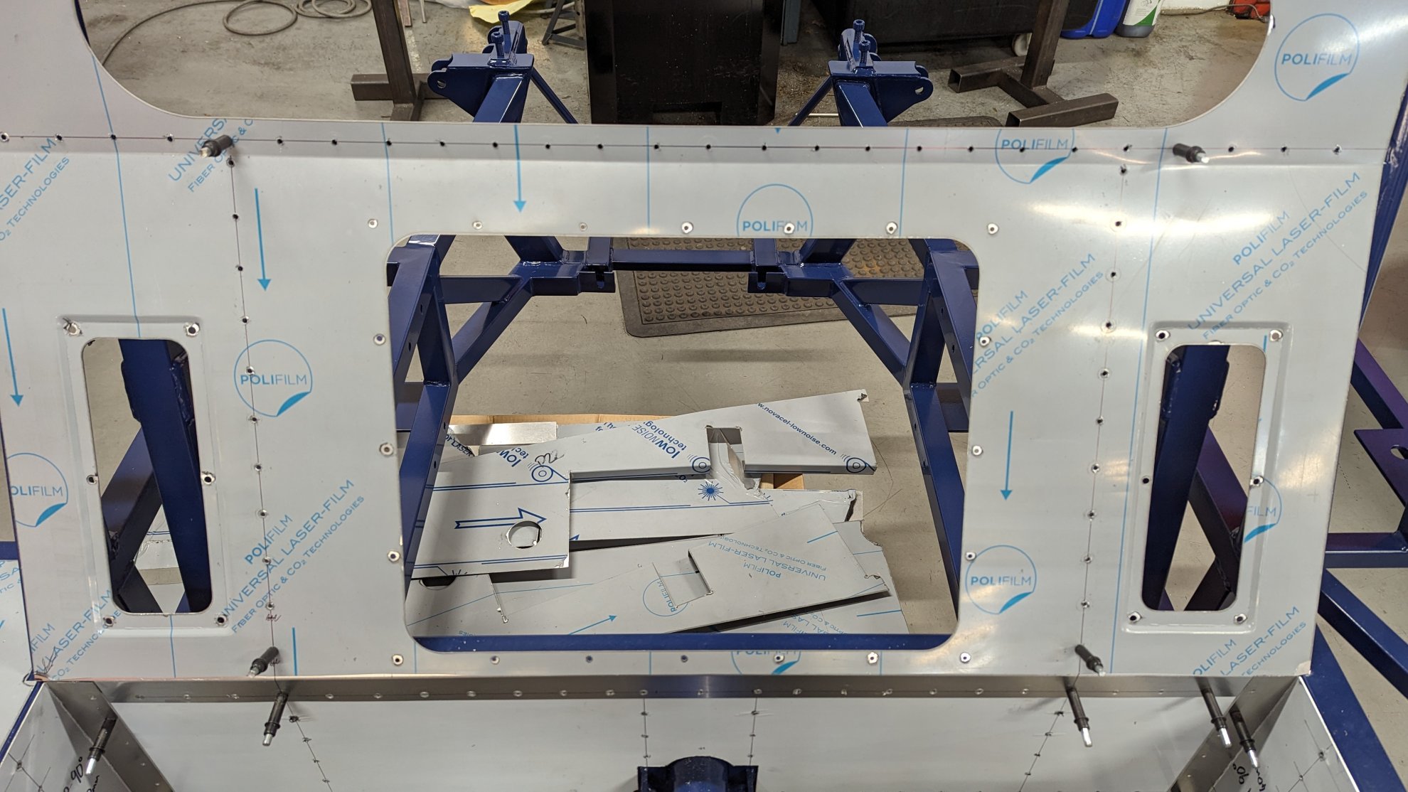

Last few panels for the interior are done, not many pics as the task at hand had my full attention...

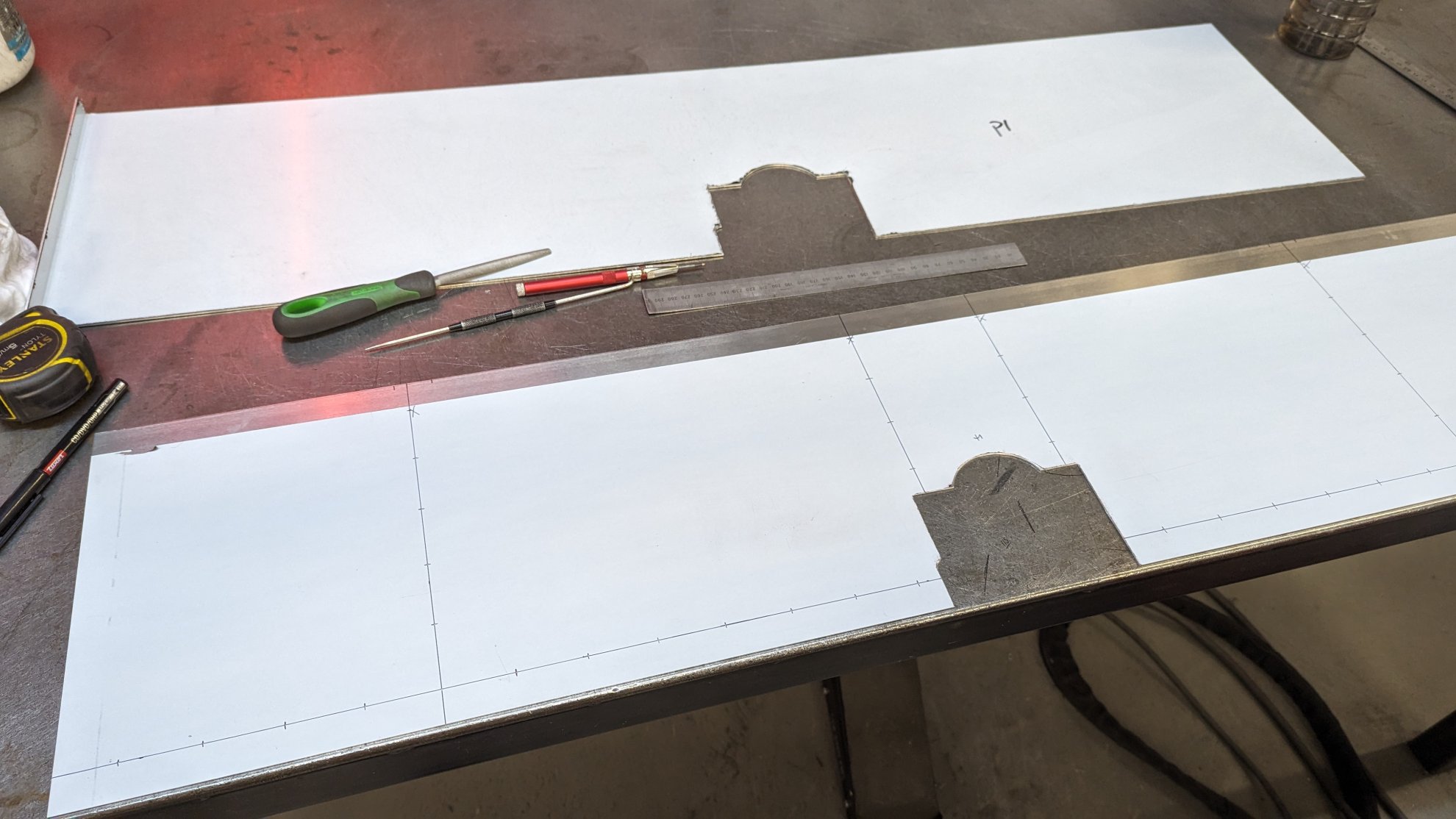

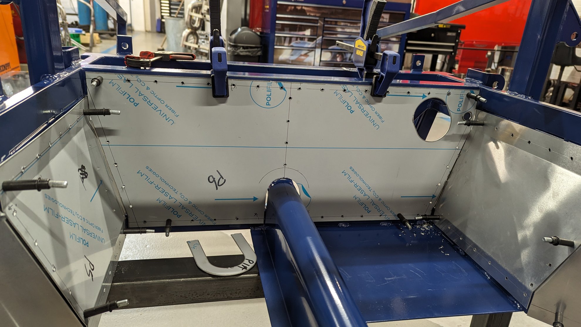

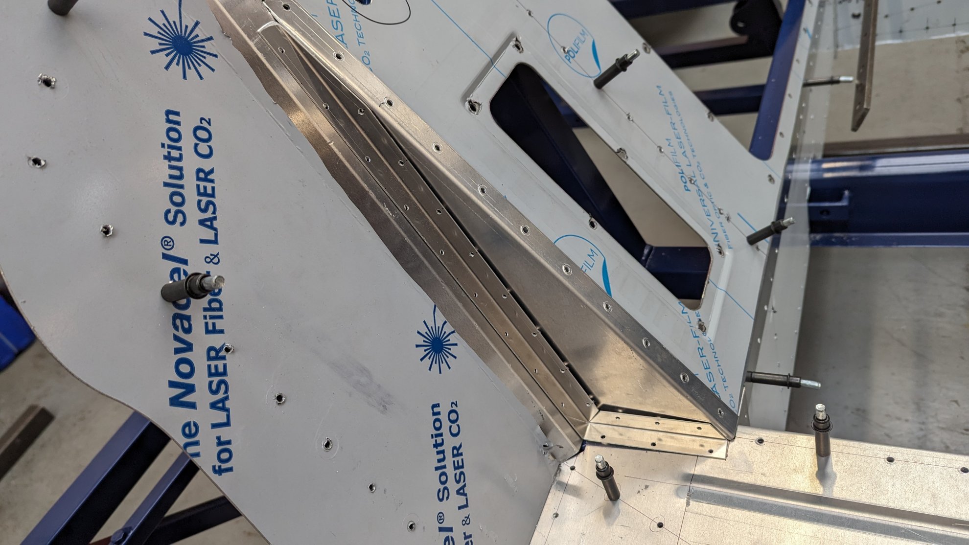

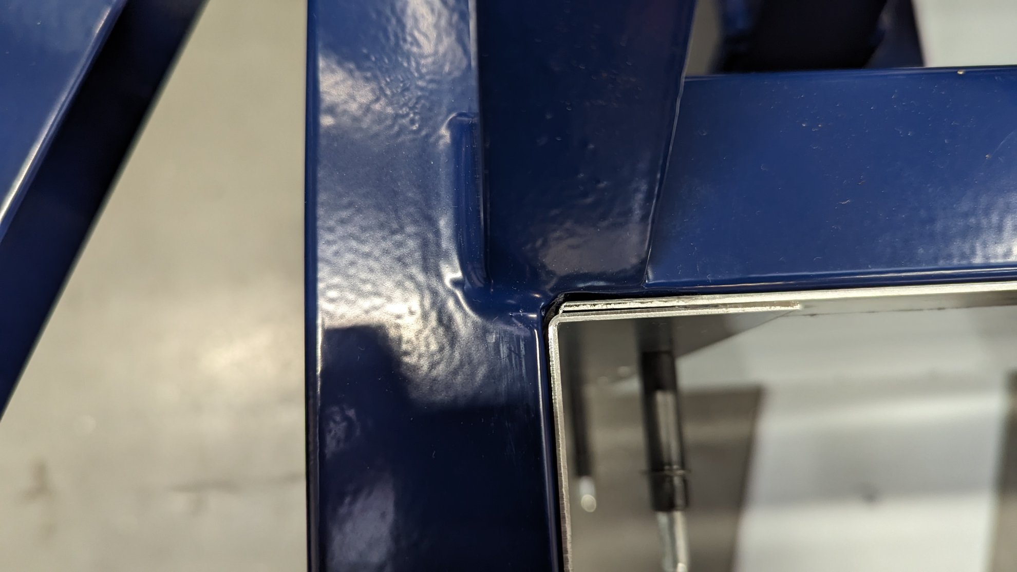

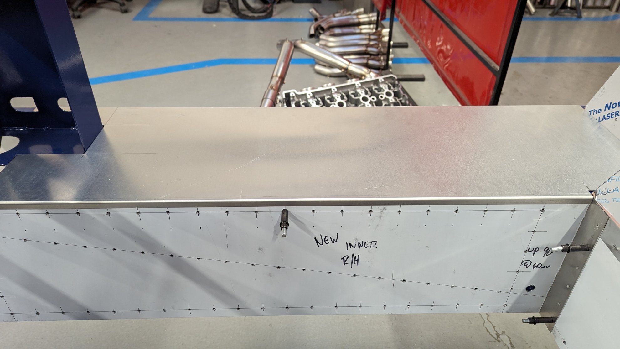

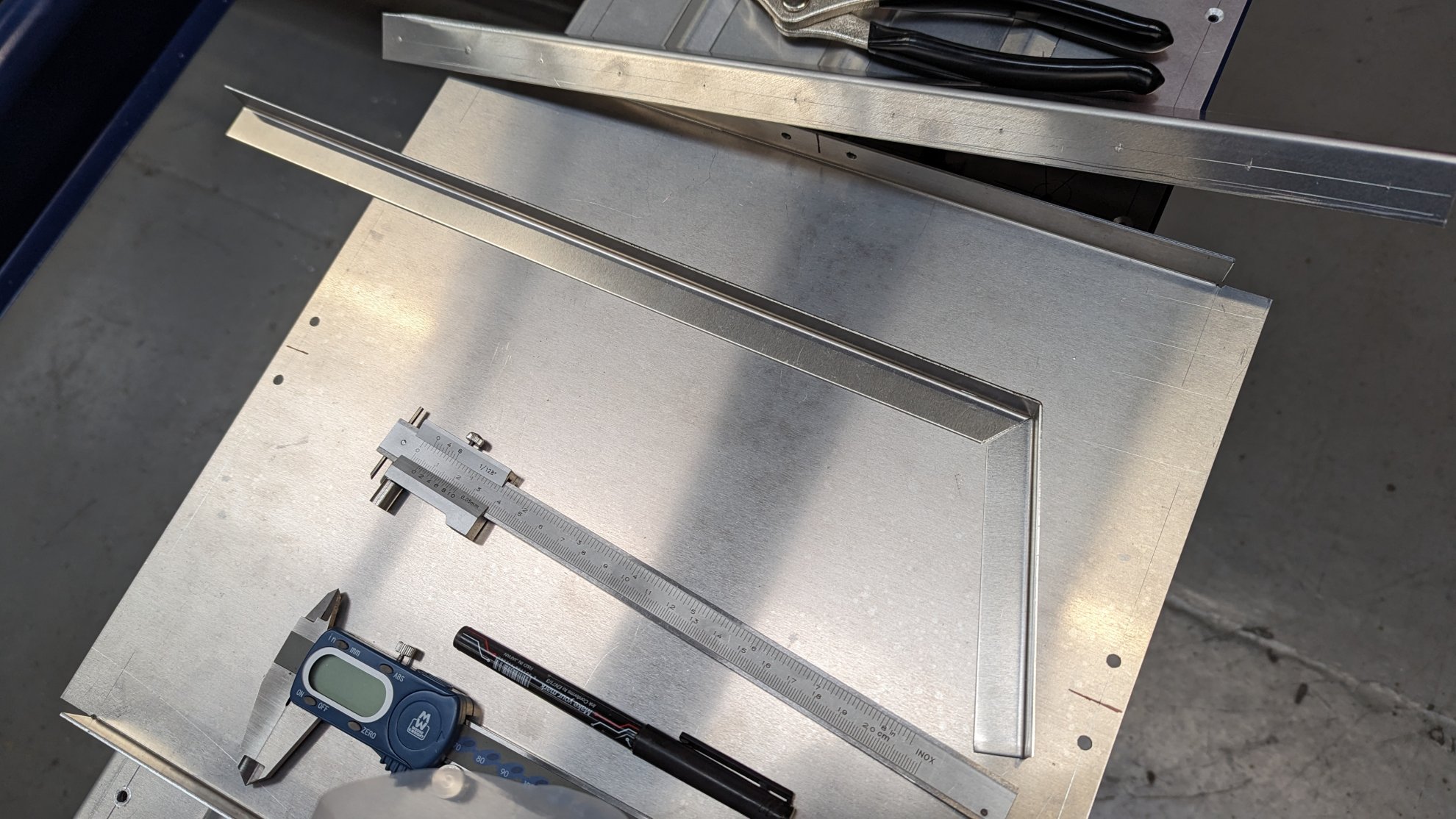

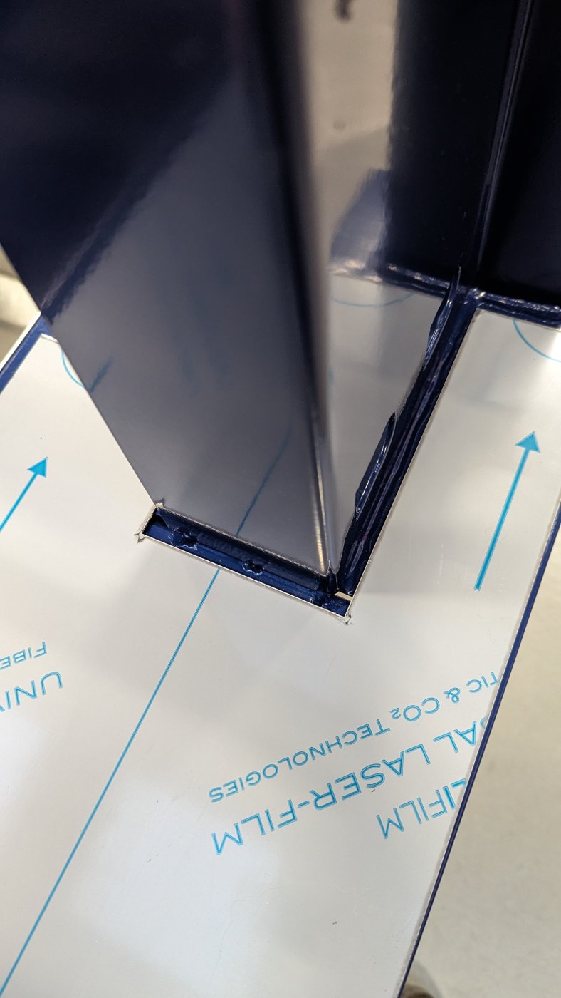

I decided to remake the triangles so the lip down the front lines up with the panel above, and settled on an infill strip rather than any potential panel gaps
