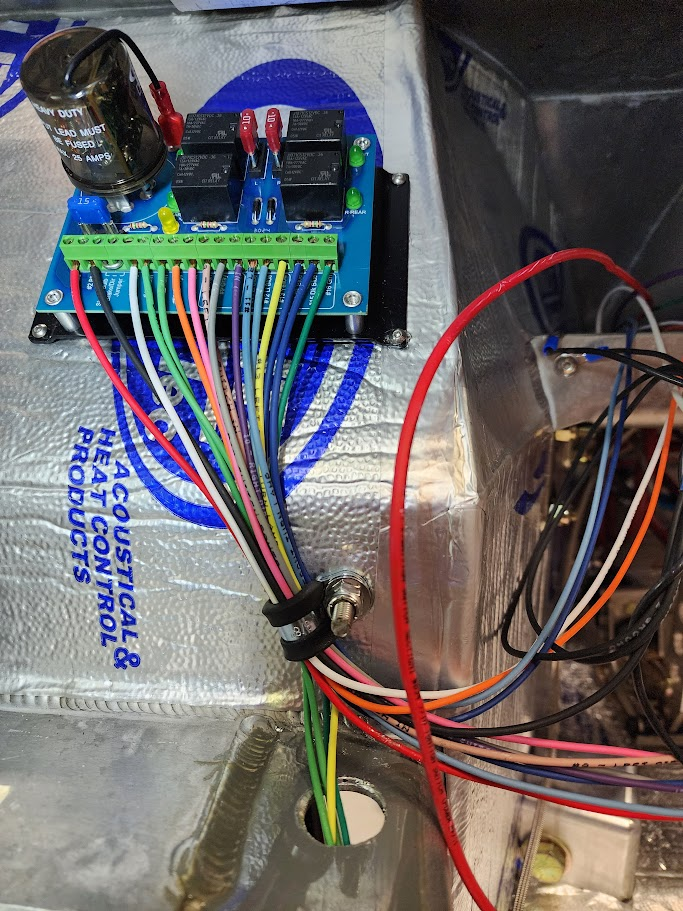

As for wiring "kit"... after being TREMENDOUSLY frustrated with Painless issues... I created my own from scratch.

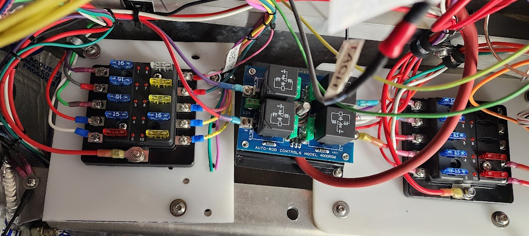

My fuseboxes were 2 blocks: 1-key-on and 1-always-on.
Then run the 'small voltage/amps" switch to a relay panel, and those relays are good for 30A. So the entire car runs 5A fuses EVERYWHERE, running wires end-to-end. Then, 30A short run wires with 10g to fuel pumps / headlights / fans...

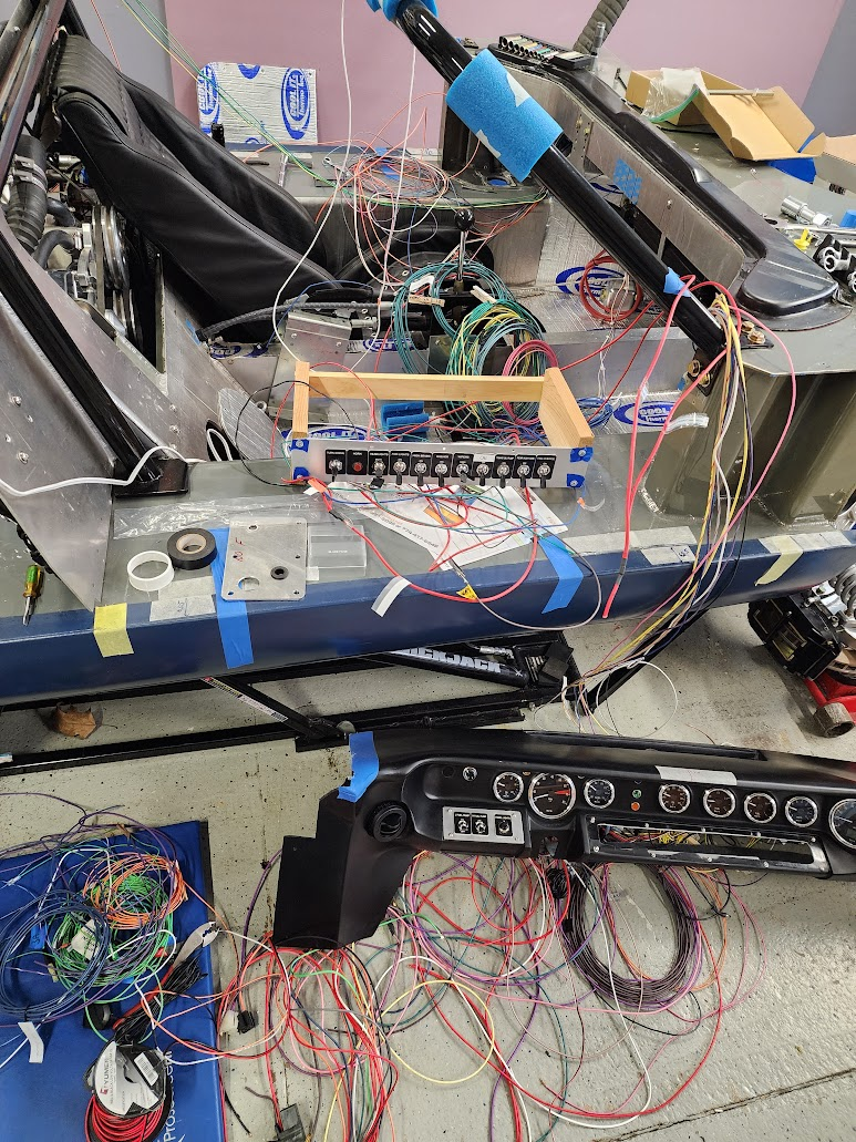

Temporary photo - fusebox setup (crimped wires are getting new heat-shrink fittings, and ALL the fuses will be 5A, when package arrives):
https://www.summitracing.com/parts/SUM-900357
(yes gromets to go thru firewall... I know)

Thanks Darius. That's a very interesting setup! I'm having similar issues trying to decipher the "EZ Wiring" kit that came from RCR. As I noticed in several posts on this forum there is nothing EZ or Painless about any of those kits;)
I really like the way you separated the "key-on" from the "always on" wiring into two separate fuse boxes. Makes perfect sense. Looks like you used the labeled wires from your "Painless" kit?

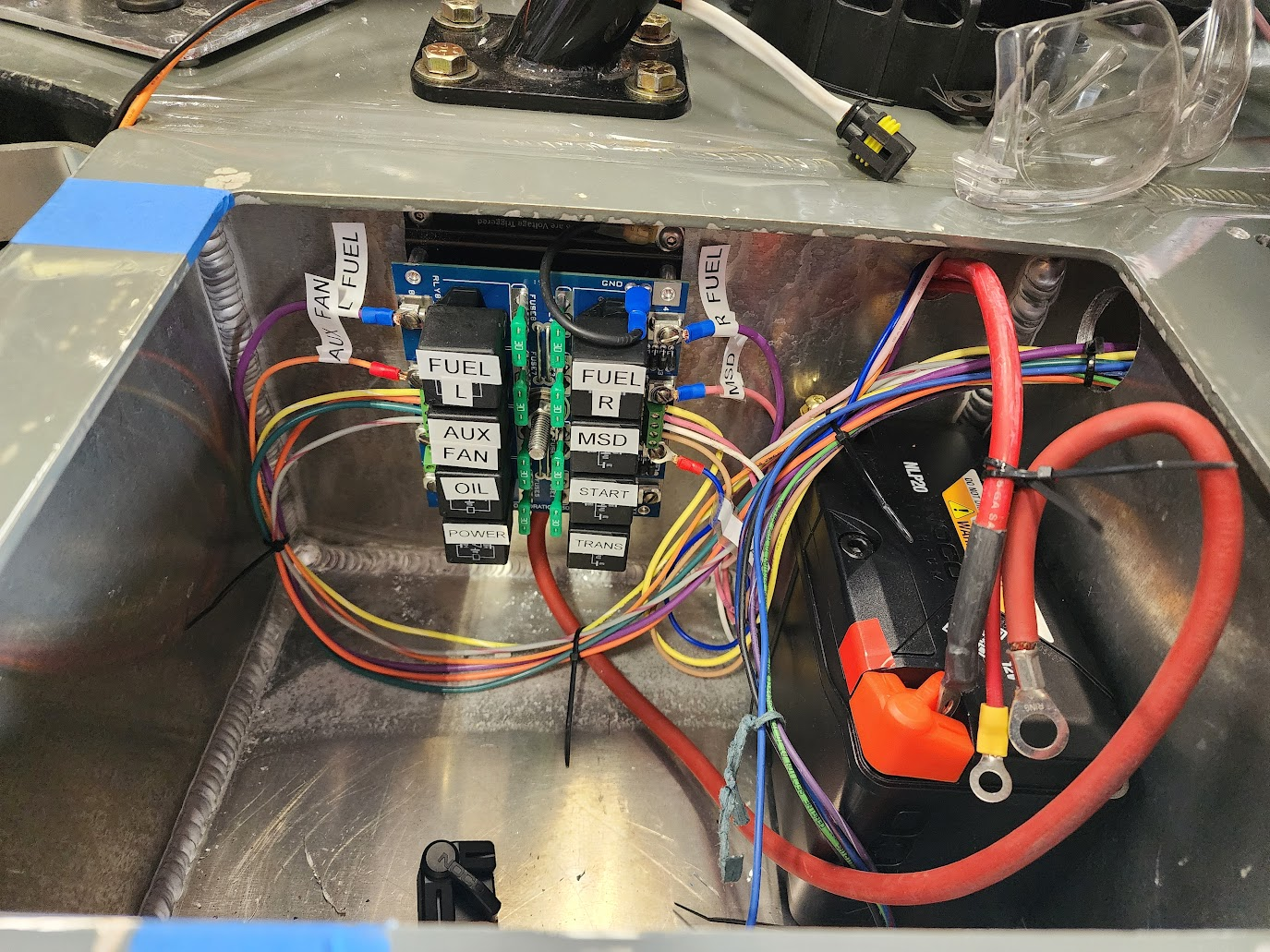

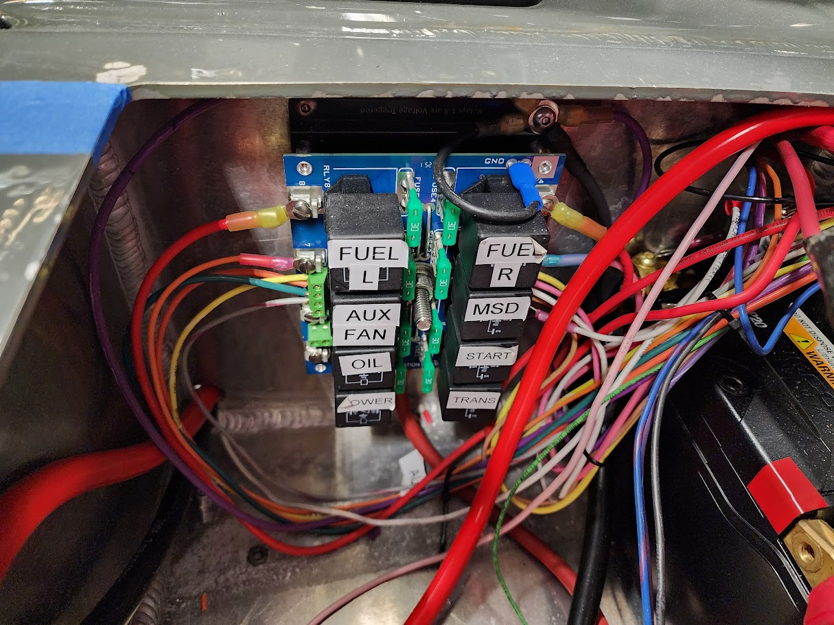

Is that 8 relay board mounted in the battery compartment on the right side of the motor? In an early picture of your cockpit I noted two relays mounted on the chassis in back of the dash. Were those eliminated by the two relay boards or did you still need them?
Chet
Darius Rudis
Chet
Tried both EZWiring and Painless kits, tried looking at both and NEITHER would do what I wanted...
So literallt just cut off all the wires from fuseblocks, and used all the pre-labeled wires.
The 8-relay in rear battery compartment is labeled for its purposes.
The 4-relay next to fuseblocks is for radiator/headlights/highbeams/foglights (could'a used a 5th for horn...).
The passenger dashboard relays are from Vintage Air kit, for the A/C & Heat.
Separating Hot & Cold fuseblocks - accomplished with ignition key. Since everything is < 5A fused, the key has almost no load.
The main 2G battery wires to/from starter, and 6G wires from battery to fuseblocks:

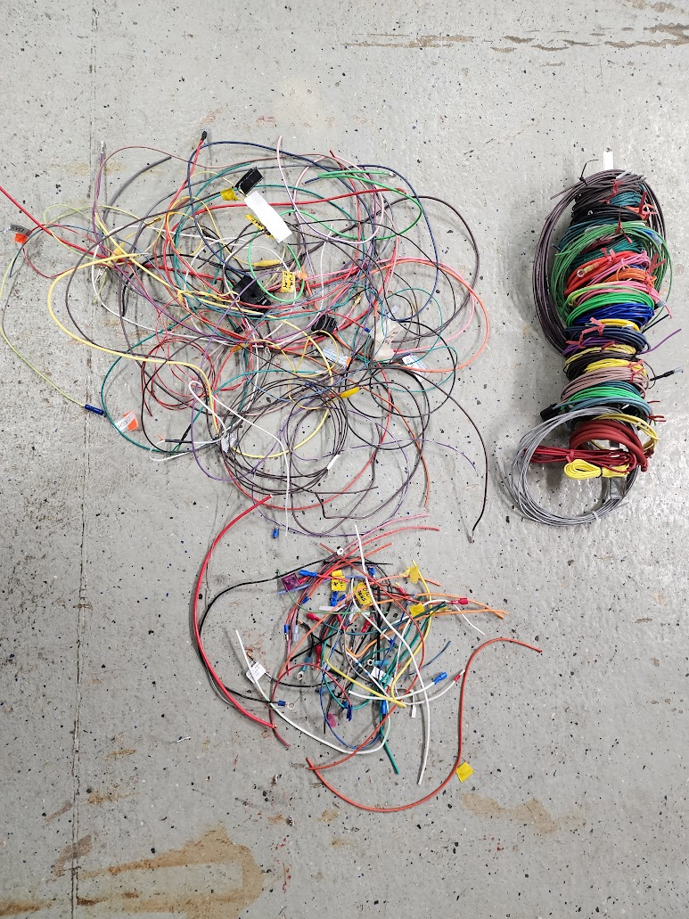

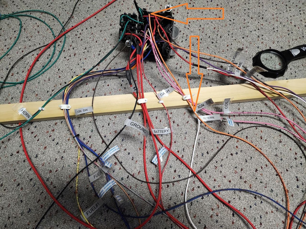

Trying to get the kits to work:
The nightmare:
Leftovers after all wiring completed:

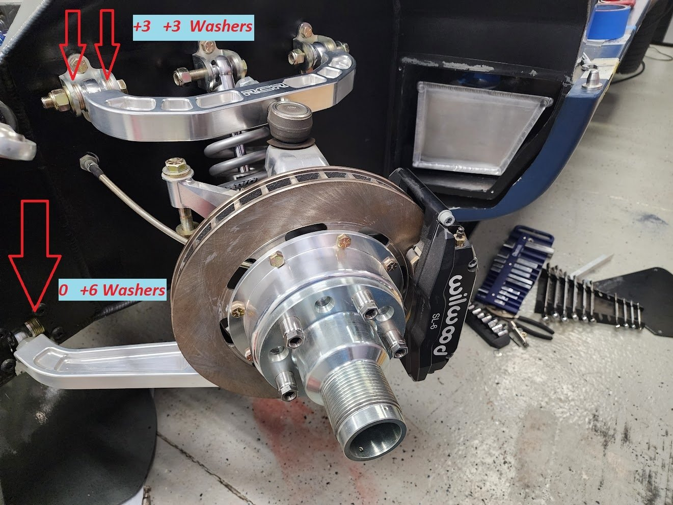

About to put the car on a rack, and get my first paid-for alignment.
Do these washers look correct (front castor)?
According to RCR Specs:

2,5 degrees? That looks like a very small amount of caster.
RCR40 I built had something like 5.5° positive caster with the lower control arms shimmed all the way forward and the upper control arms shimmed all the way rearward.

I think I’d probably weld up the holes that the upper brackets are bolted to and drill new holes about 1/4” further rearward. Perhaps find some heim joints with thinner balls?

My understanding is that if the car will be primarily street, then 5^, but if the priority is track performance, then 6^. RCR recommends a compromise of 5.5^. The more caster, the greater the steering wheel effort, especially at low speeds, i.e., parking. That extra effort can reduced with a power steering unit from Flaming River or similar. I settled on 5.3^, but that had more to do with getting the wheel base right and centering the tires in the fender arches.

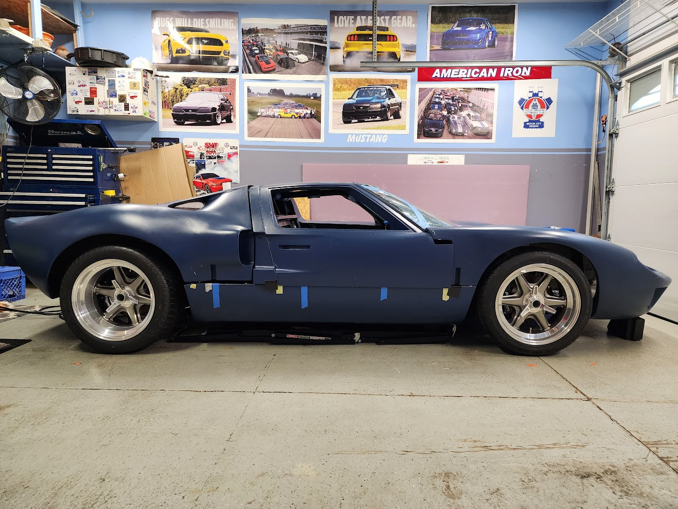

I am at the catch-22 point...
Setting the body alignment, and centering onto the wheels. Also setting the wheel alignment, to center the body...
Shooting at BOTH targets at same time.
+/- a few degrees of caster isnt going to move the wheel fore/aft very much, so I think I am close enough.

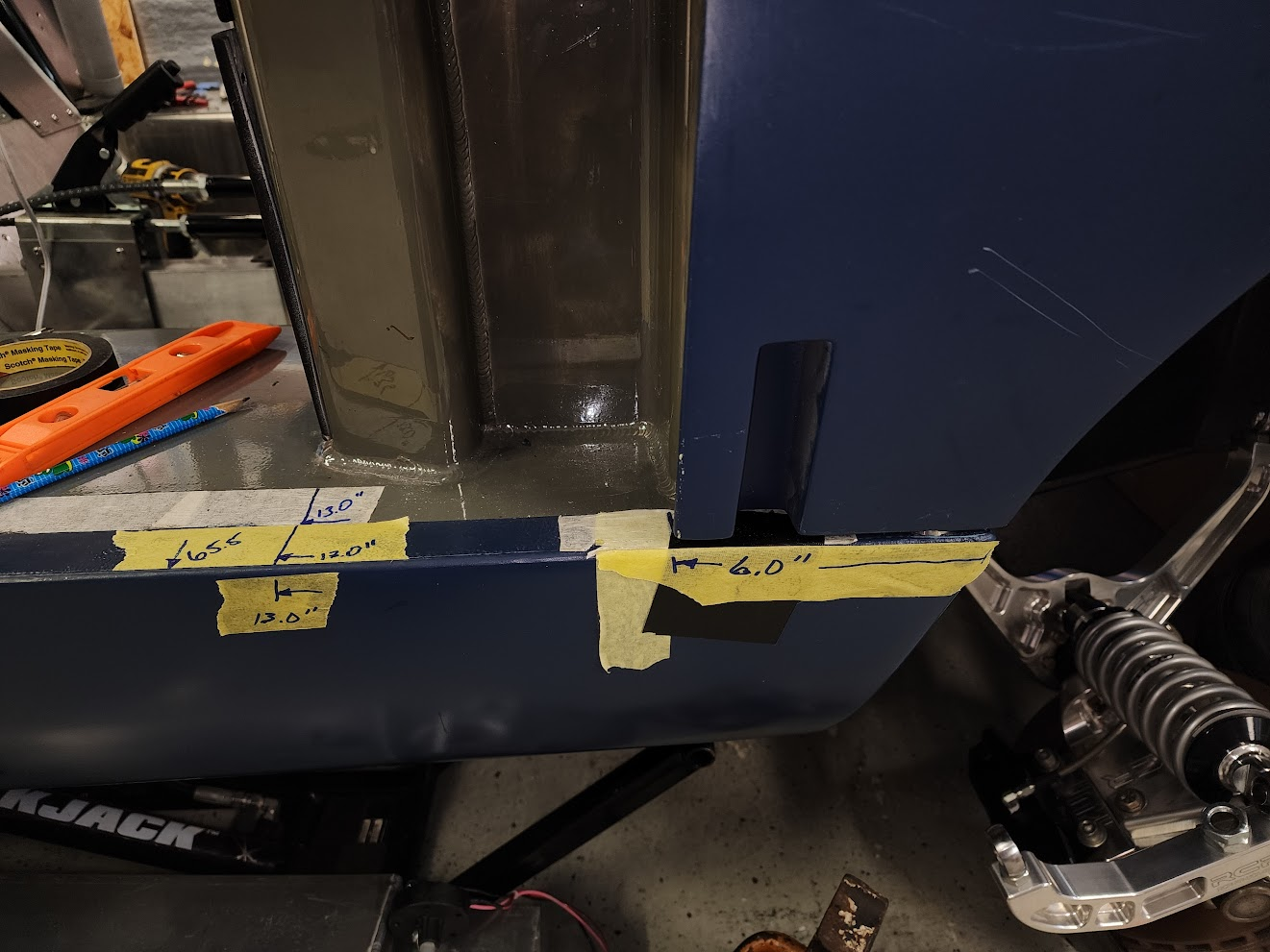

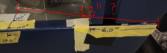

Here is my current point (doors literally set on, no hinges, just for photo. Hurry and take photo, before they fall off)

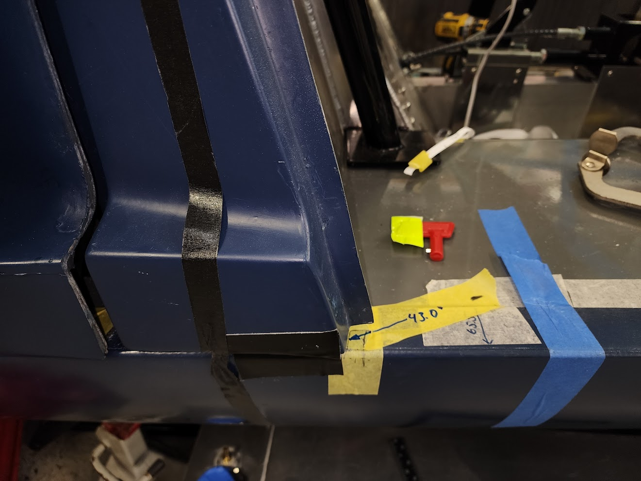

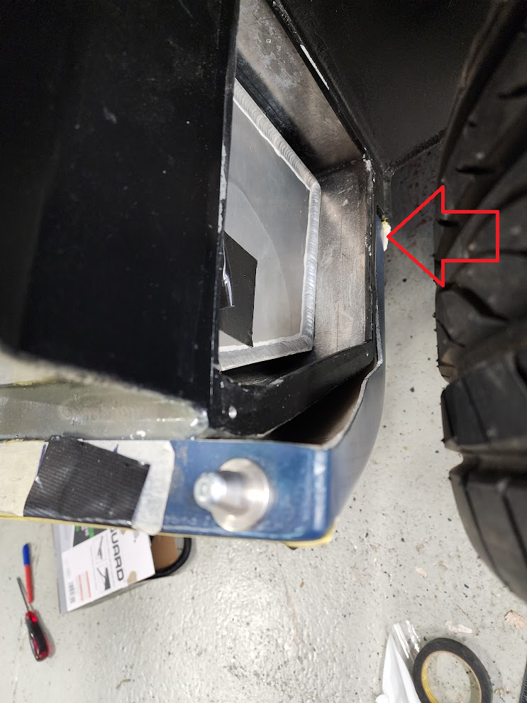

My sill covers needed to be shifted all the way rearward to start the body alignment process over again - once I had the front end rough-aligned. The positive caster shifts the spindle rearward a little ways.
Are they all the way up against the front edge of the alloy chassis? I couldn’t tell from your photos. My tires rubbed those sill covers when turning them, so that’s how I found out.

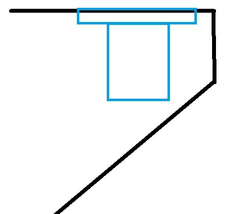

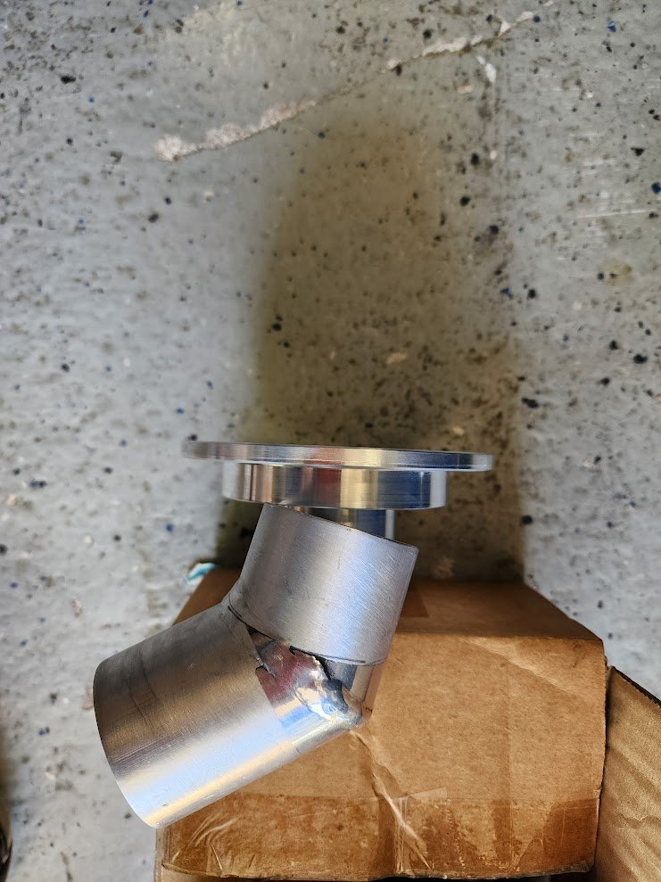

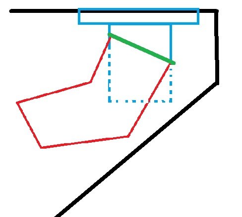

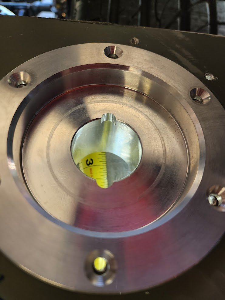

Need help with fuel filler cap to tank hose routing.
Mounted the filler cap onto the frame/body, but the hose has ZERO clearance to make the curve before wheel well (firewall).
Thinking of CUTTING the filler neck(blue), and WELDING(green) the provided 45' aluminum angle (red), at an offset-angle, to clear the wheel well (black).
How did you mount your 2" Marine hose to the gas filler cap and rout to the tank?

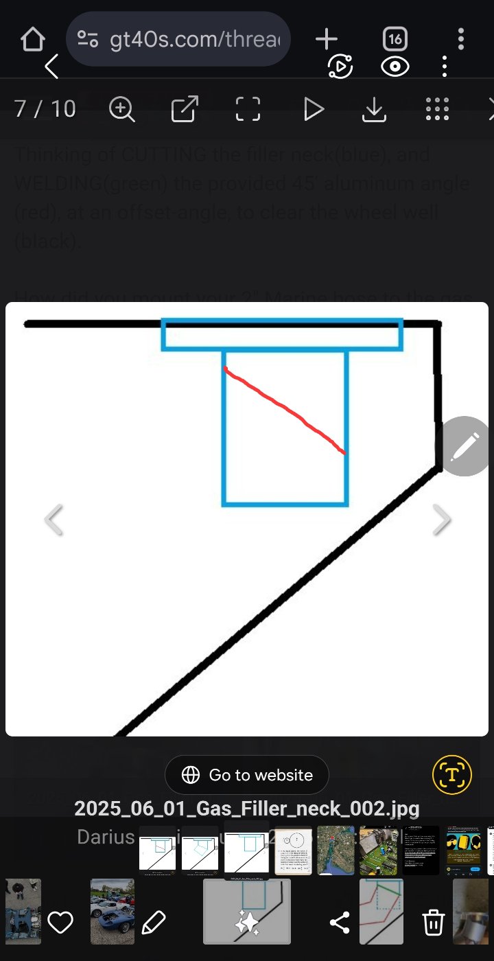

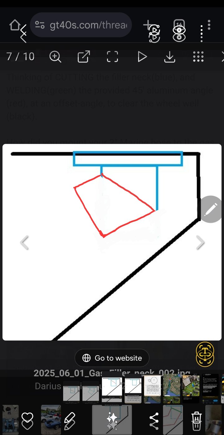

You can't cut the angle and weld on a round piece to it, if you cut an angle then the shape is now an oval. But you can cut the filler neck at an angle and weld the piece you cut off back on 180 degrees to what it was, which would give you the angle you are looking for without adding another piece. If you need it longer after then weld a straight piece on the end of it
