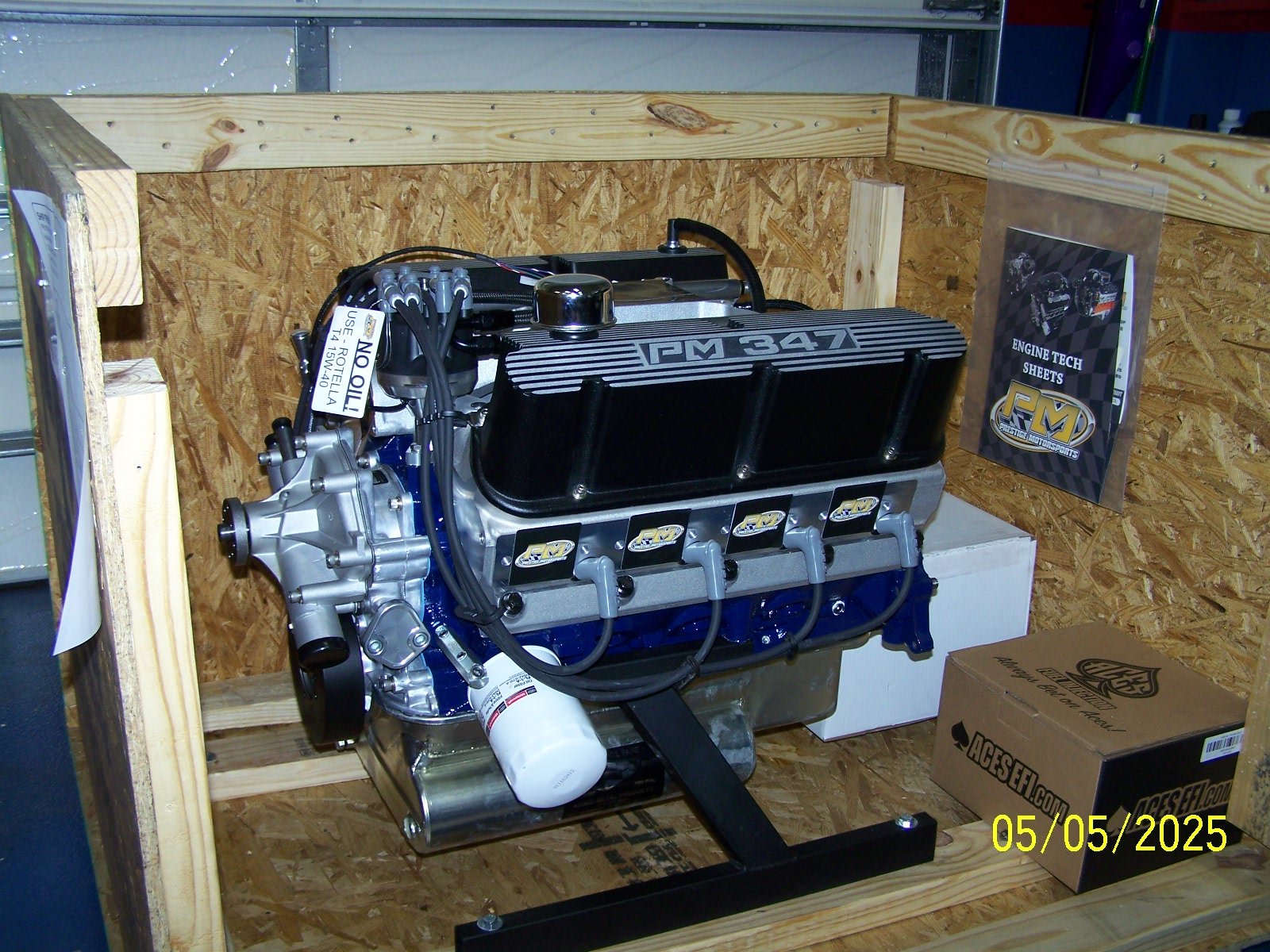

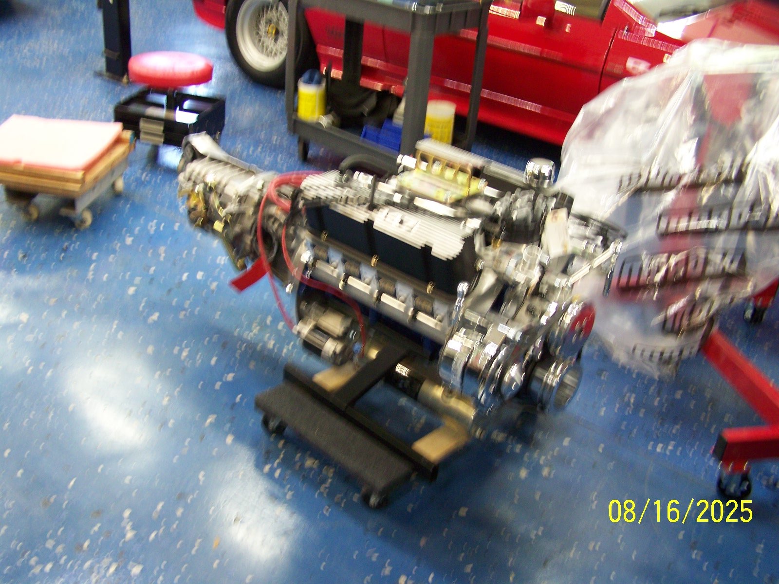

Motor delivered today from P.M. Ford small block, 347 C.I.D. , 460 H.P. @ 6500 R.P.M. on Dyno!
Just need the transaxle, and a car!

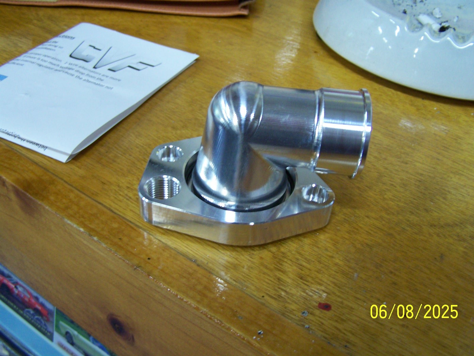

Question, I am installing the front accessory kit from CVF on my SBF 347, so far everything fits well. My question is does their water neck fit on the Edelbrock Victor Jr EFI manifold? I don't see how it does.
Jeff

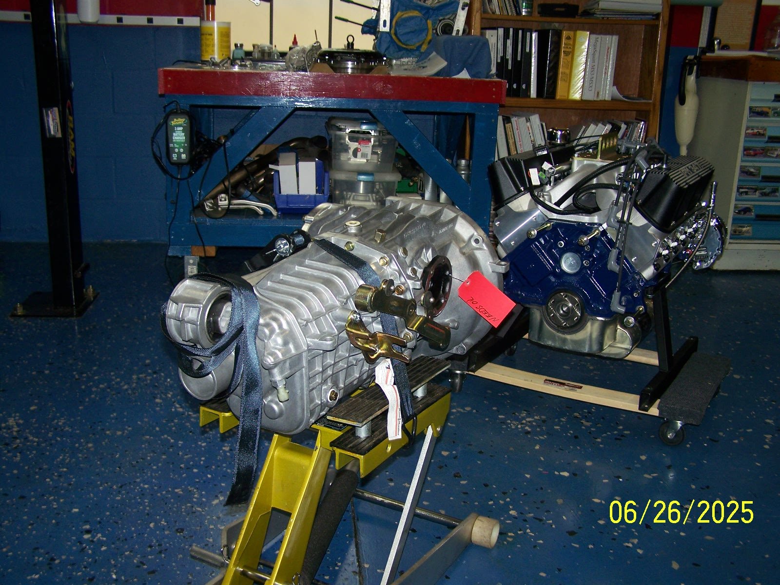

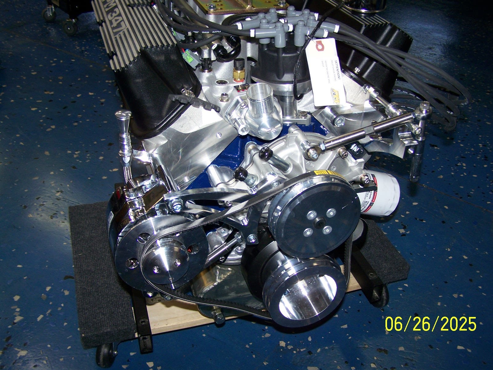

Trans showed up for CMS, along with CVF accessory kit.
Mocked up front end for now, and will do the same for trans. Kennedy kit looks great!
That waterneck housing came from CVF, no bleed port. It does fit the manifold, I am a retard.
Just need a car now, tried to contact Fran, and company twice for a build update, no response.
Regards
Jeff

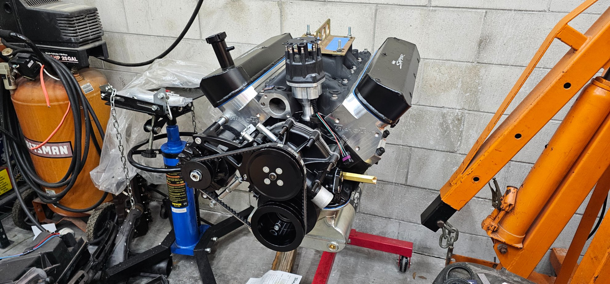

Looks similar to the setup I have. I was able to get a 37" belt on it, 15370. 15375 also worked but the 37" got the alternator very close to the cylinder head on the back side so I went with that one.
Not sure if you figured out belt size yet but it looks like the one you have is too long lol
I have the different alternator fan on it as well, not in this picture though

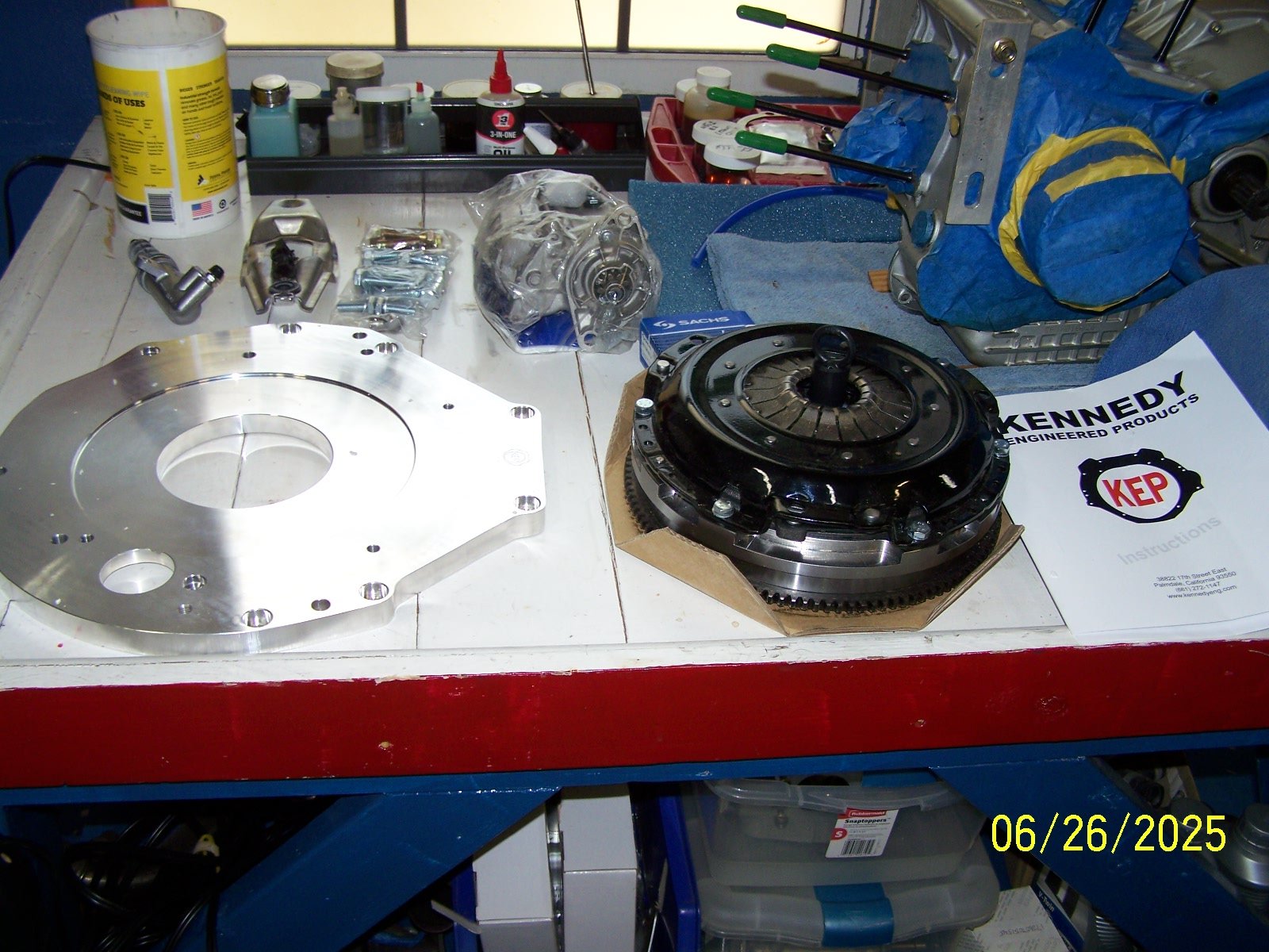

Hi all,

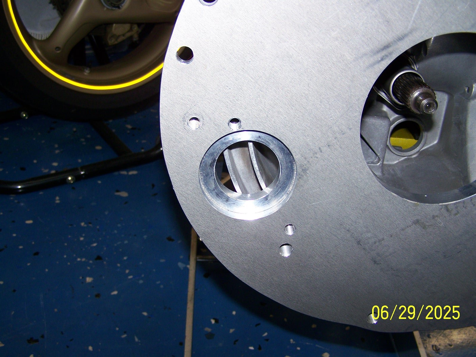

So test fitting my G96 to the 347, second item in the Kennedy instructions state to clearance the G96 case for the starter gear. Before I start hacking my $17K trans has anyone else done this?
Any input greatly appreciated.

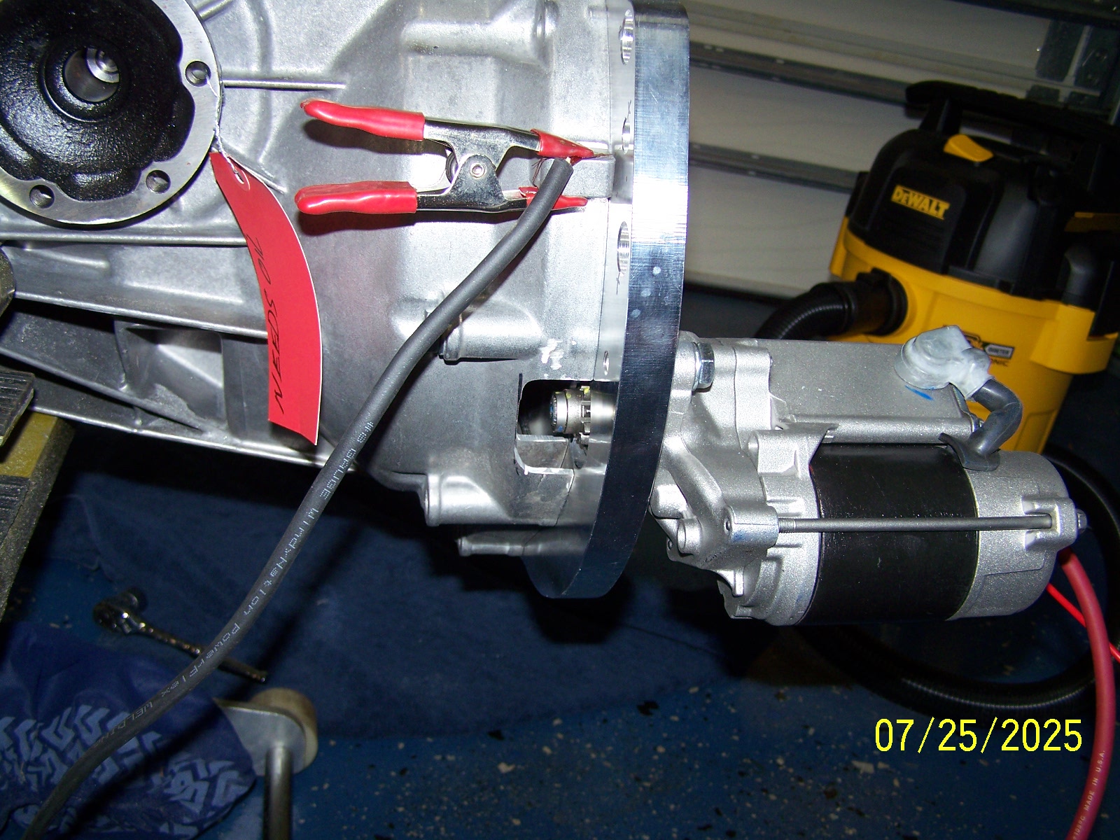

Got the trans installed, tested starter, no issues.

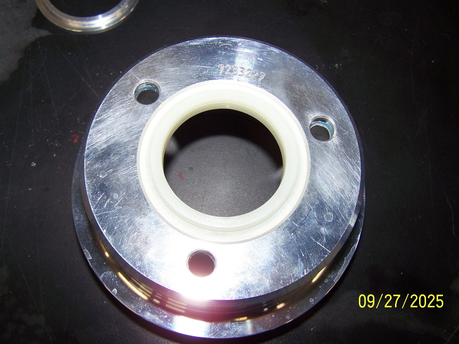

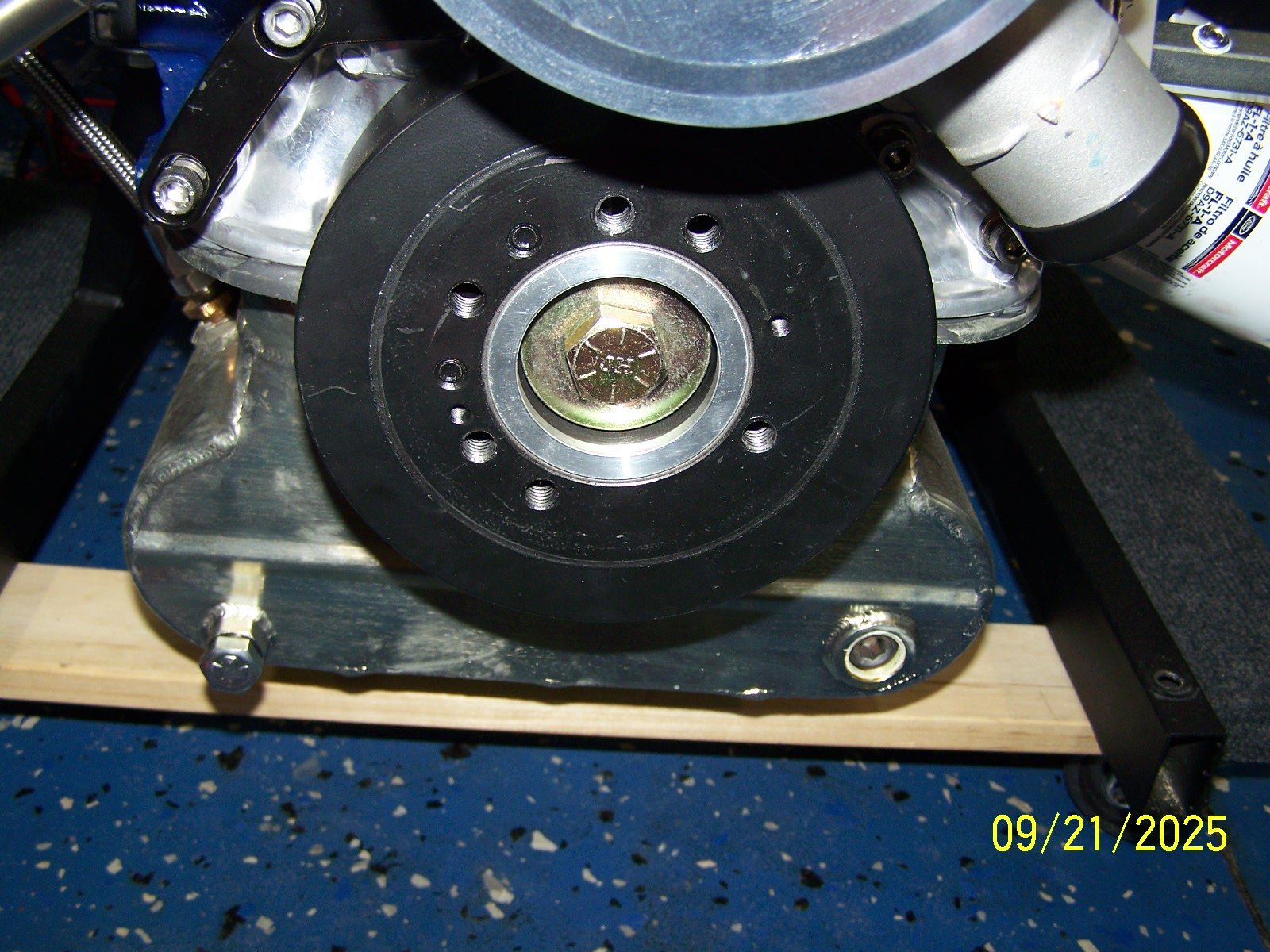

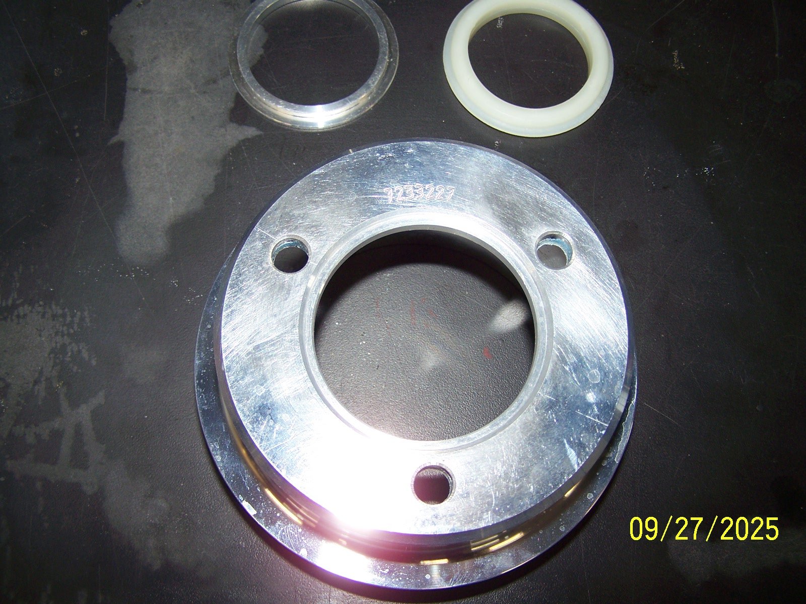

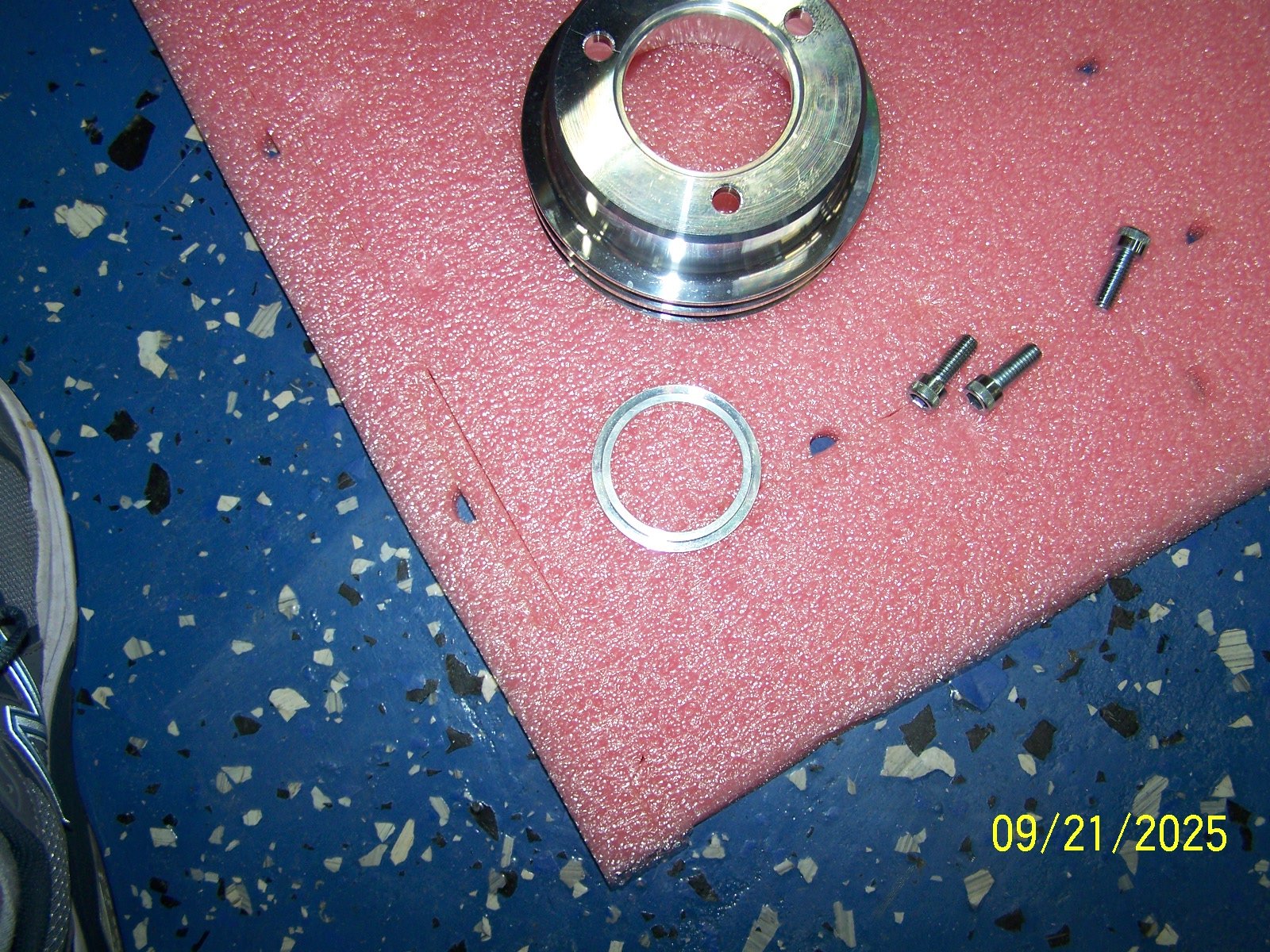

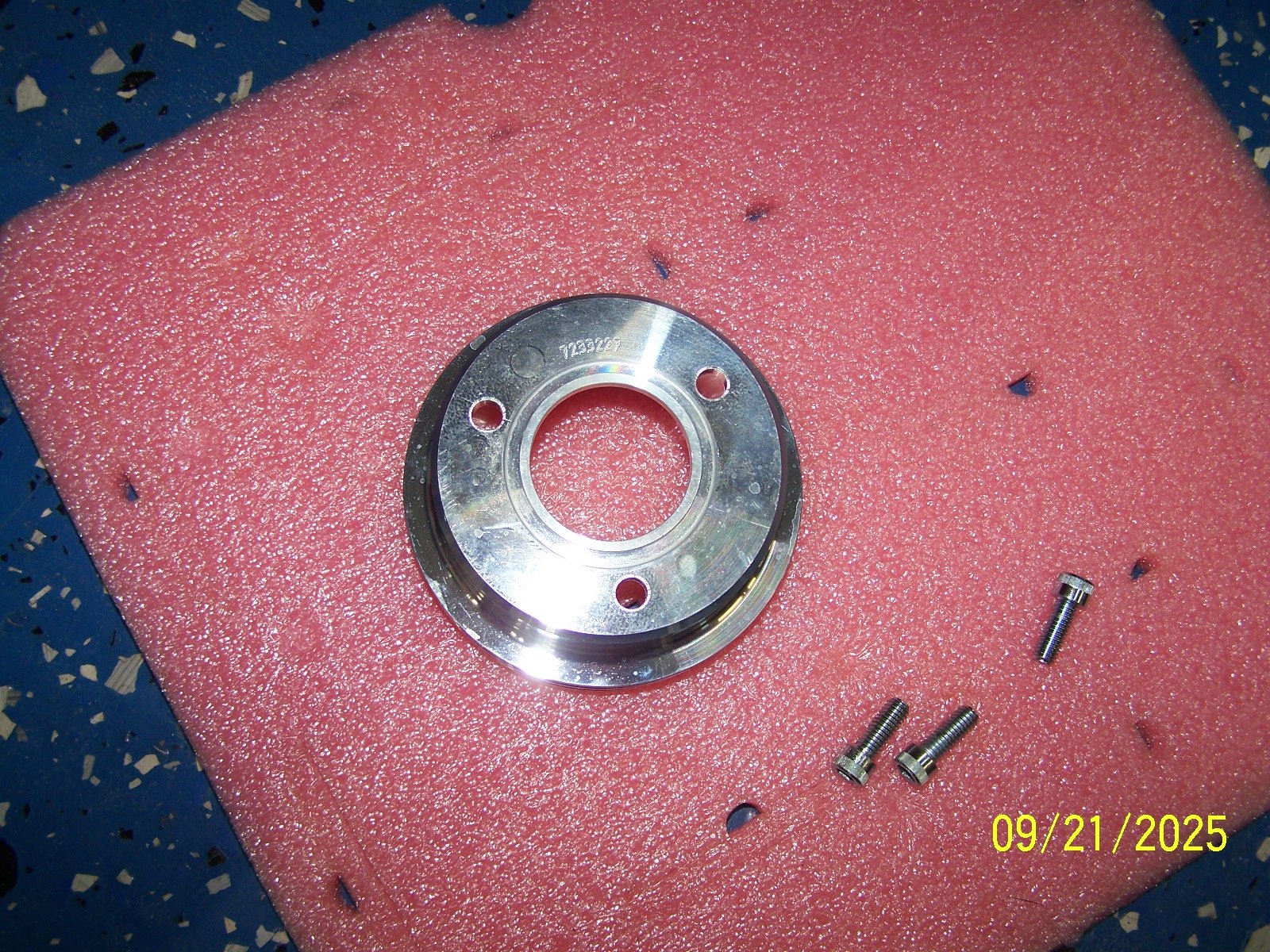

So concerning the CVF kit, I am stumped, regarding the circular bit that seems to go into the crank dampner/pulley. It fits nicely into the dampner, and the pulley, but when the pulley is tightened down, it is not tight in either, just floats around. Am I missing something?
Jeff
So just to put this issue to bed, I consulted with both CVF, and Prestige, the centering ring supplied with the CVF pulley is to be used with the stock crank damper. My damper is a March unit, and is supplied with a centering ring, which Prestige confirmed. For whatever reason my motor was shipped without the centering ring. Prestige overnited me the centering ring which works perfectly.
Hope this clears up any confusion.
