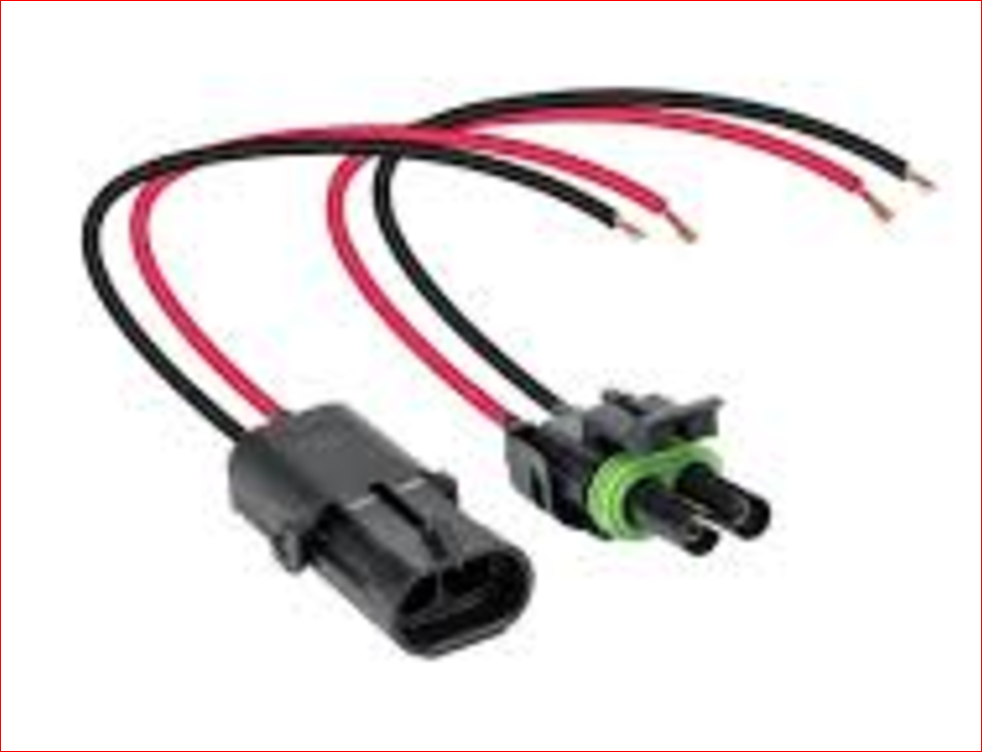

Tail light wiring: I ran my wiring from the rear bulkhead alongside the brake & clutch lines on the lower LH side of the chassis. Then across the rear pan to the back where it split Rt to Lft. I used Waytek Weatherpack Connectors for all my exterior connections.

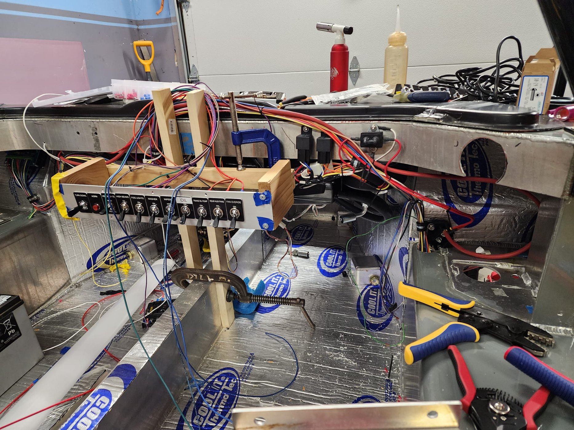

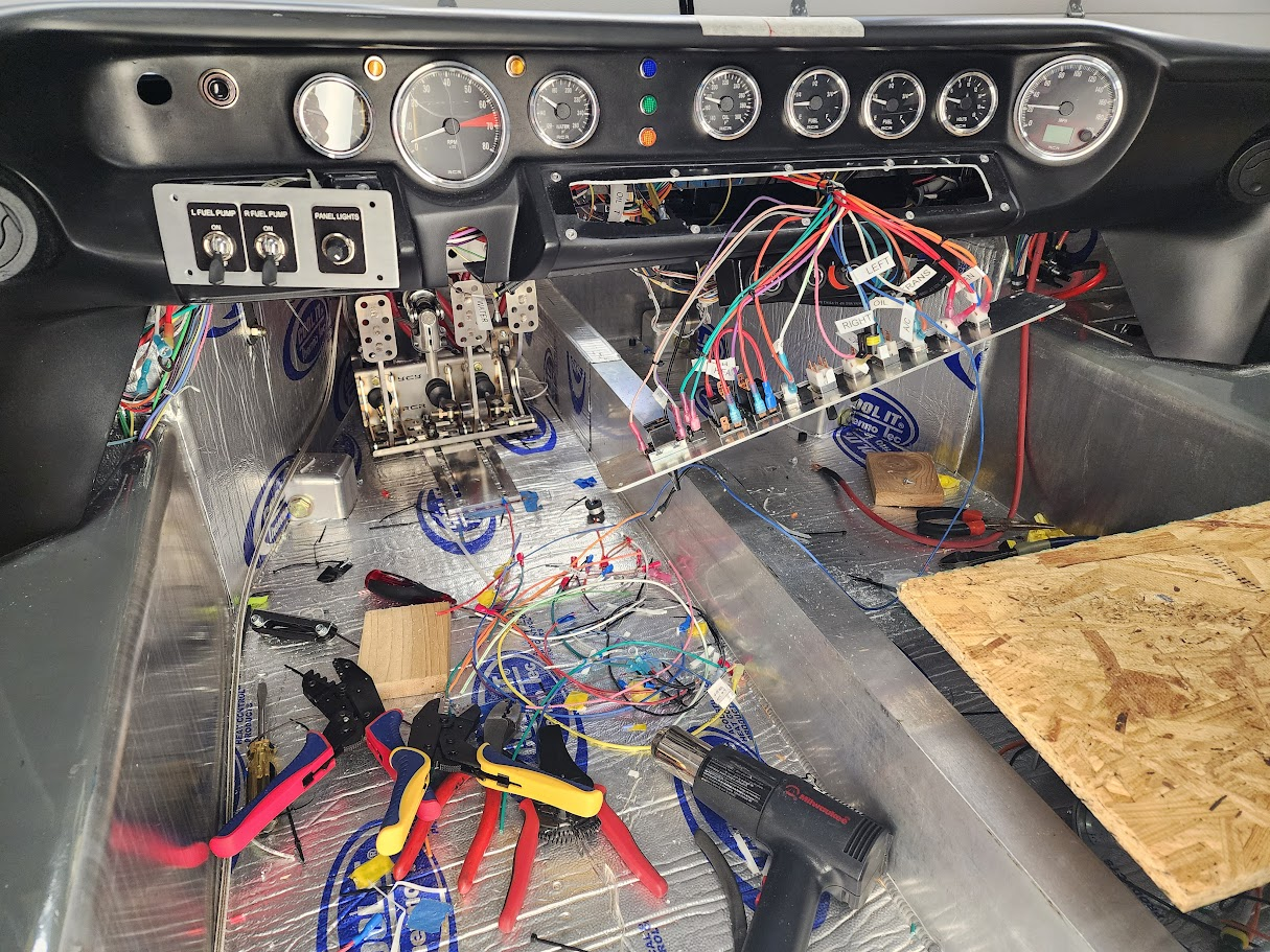

Question: When wiring your Switches (for dashboard removal) , how do you disconnect everything?
Example dash:
A. Remove crimp-connect of each wire from each individual switch? (many single loose wires)
B. Make a complete harness plug, removing ALL wires at same time? (splice in multi-terminal plug)
C. Splice in a Weatherpack, one for each switch (2-pin, 4-pin...), and remove many Weatherpack connections? (1 connector per circuit)
D. Remove each switch from dashboard, remove retaining collar, and leave wiring/switch connected, just remove dash-plate (not switches).
Darius Rudis

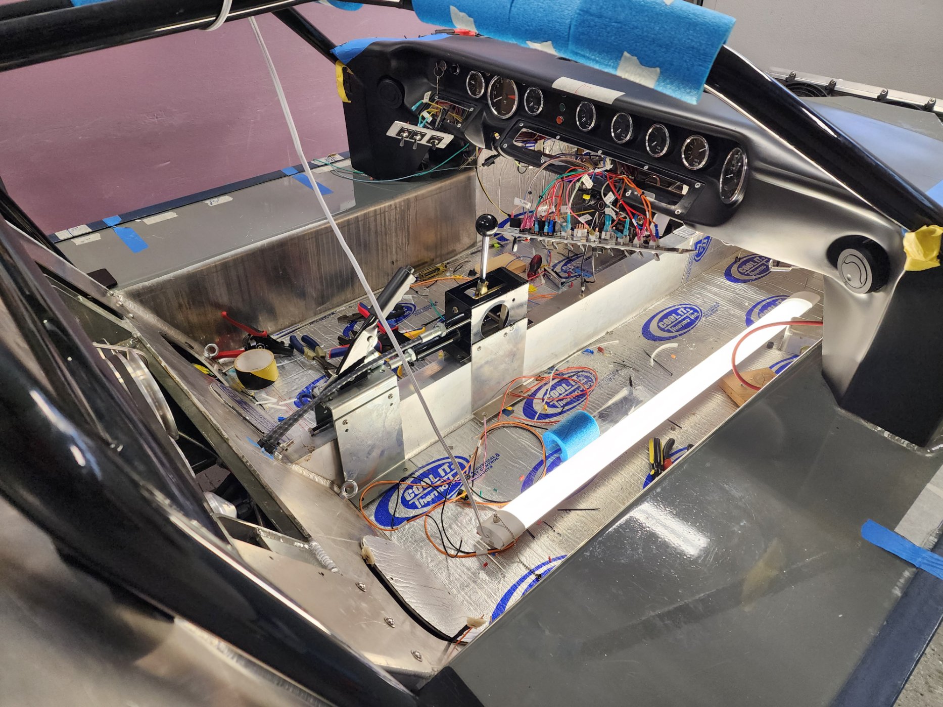

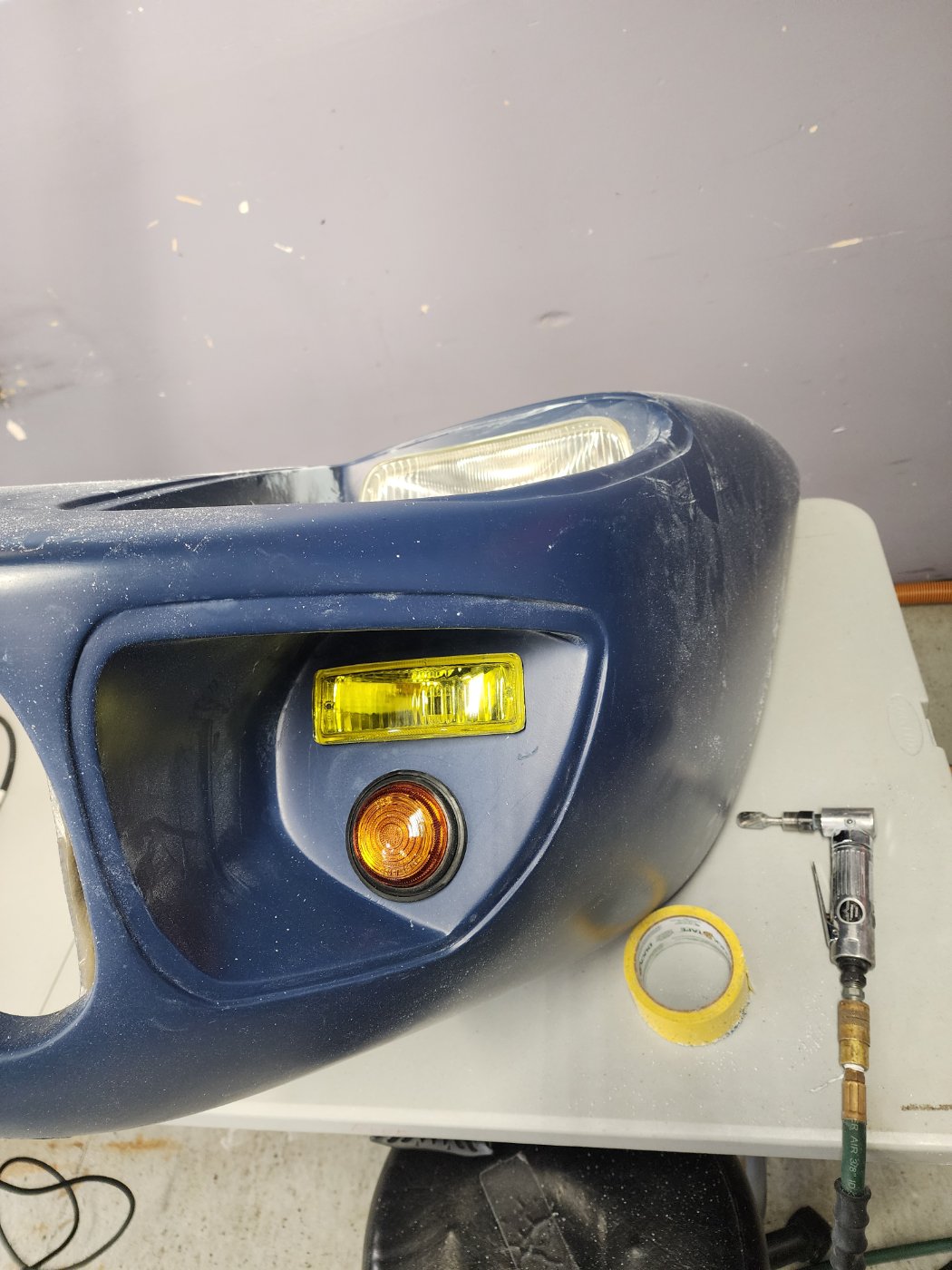

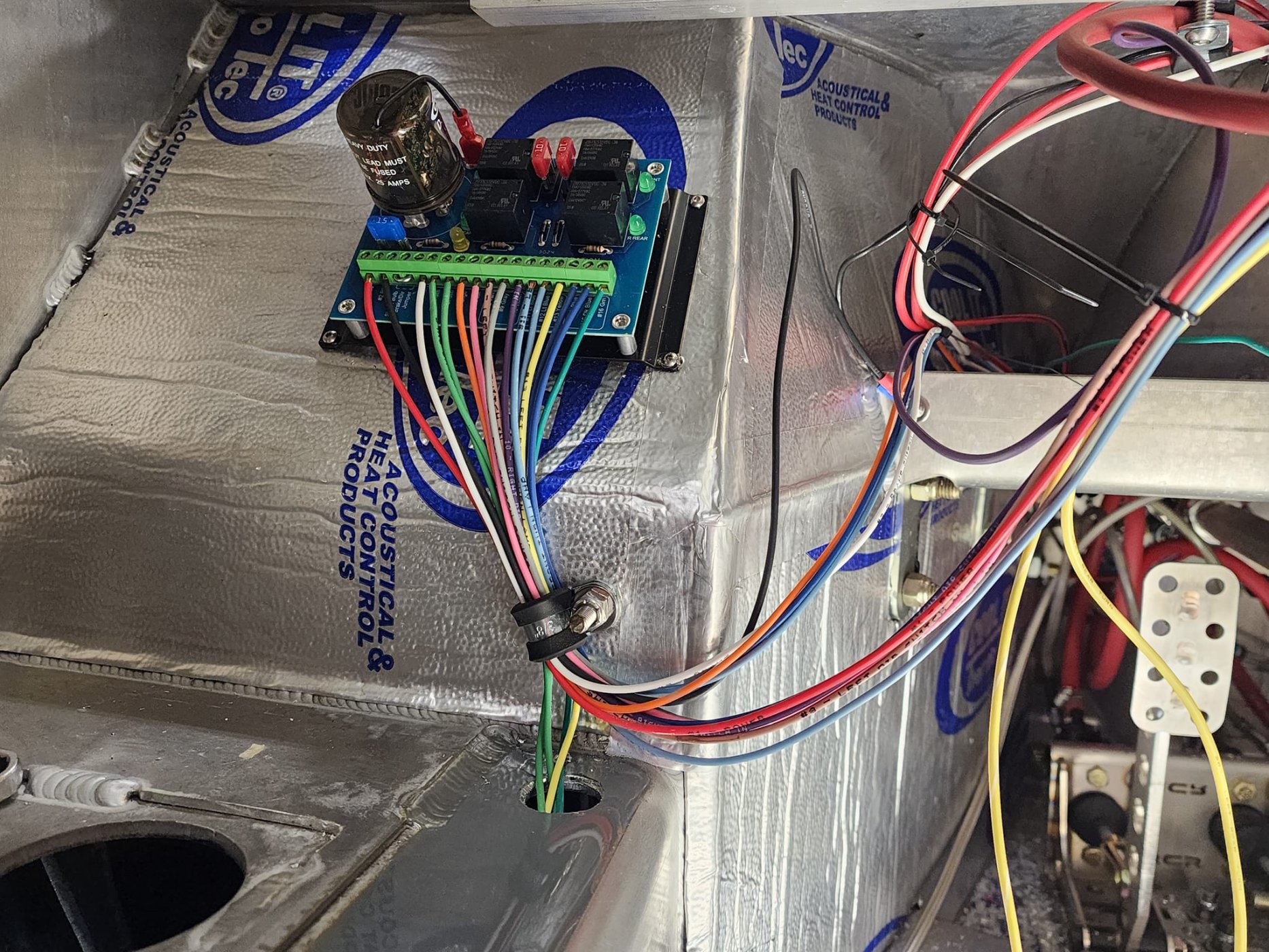

Thought I would be a little further along, but did make tremendous strides this Thanksgiving weekend. About 75% in completing Phase-1 (drill holes, run wires, and cut to length, and fast crimp fittings). Then moving to Phase-2 (remove wires, create harness, heat shrink connections, insulation shielding, and grommets for holes...). Content with work completed so far: radiator fans / lights / foglights / turn signals / brakelights / taillights / heat and A/C are done. Mostly about 50% of engine stuff to go...

Nice progress! I'd recommend a few multiple connectors for better organisation and easy servicing later on. Make sure you put the fuse box in a location which is easy to access once the car is completed. Happy building... Check for its location in the original cars.

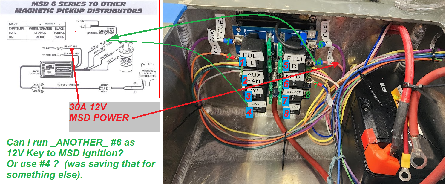

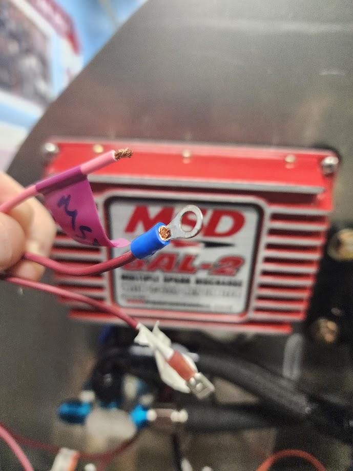

MSD Wiring question:
~ Can I run TWO wires from single source of 30A 12V relay (key-On) to Power _AND_ Run the MSD iginition (simultaneously, both red wires together). [Instructions say #6 Heavy-Red to Battery, and #4 12v Key Red].
-OR-
~ Must I run #6 30A 12V relay (key-On) to Power, and #4 separate 30A 12V relay (key-On) for Run?
Both wires are 12g (I believe) with distance of 5 feet from relay(s).
p.s. Ignore temporary quick crimp-connect (will redo with proper crimping/heat-shrink/wire-loom/grommets/supporting...)

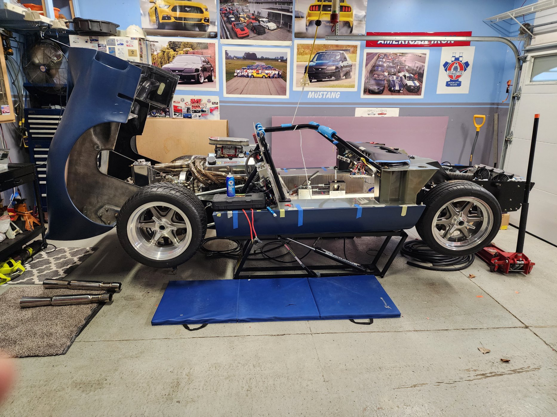

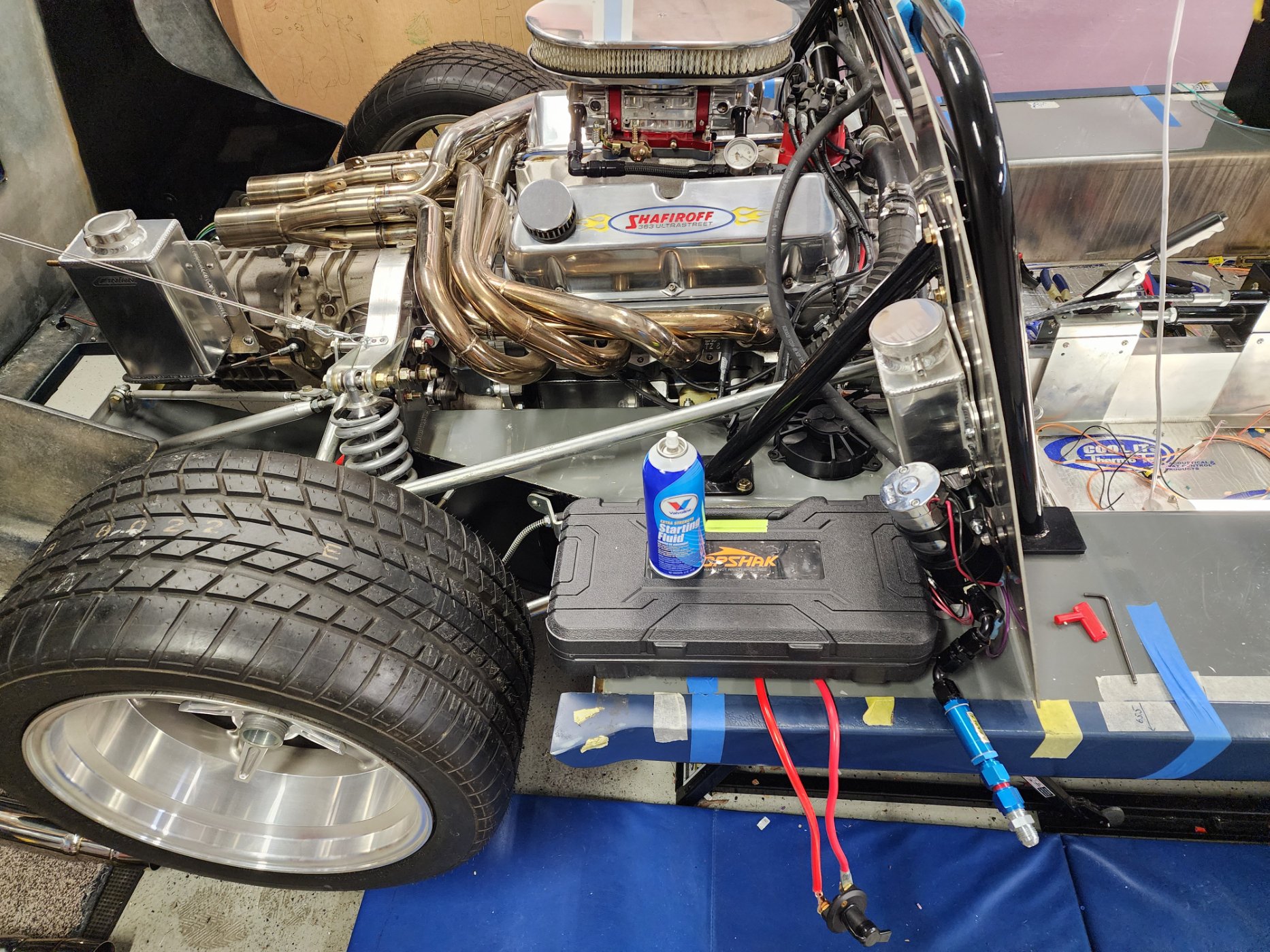

On Jan 01, 2025, to "start" a new year... I STARTED IT UP!!!
Yes, only on Starting Fluid, as I dont want the smelly gasoline odors from the gas tanks, while I start on the bodywork for the next few months.
No video, just photo (for now).
p.s. Yes, it was loud with mufflers sitting on the floor. ;)
