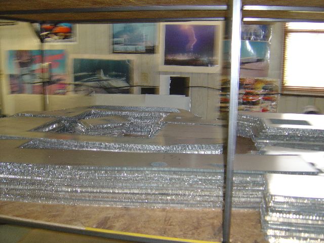

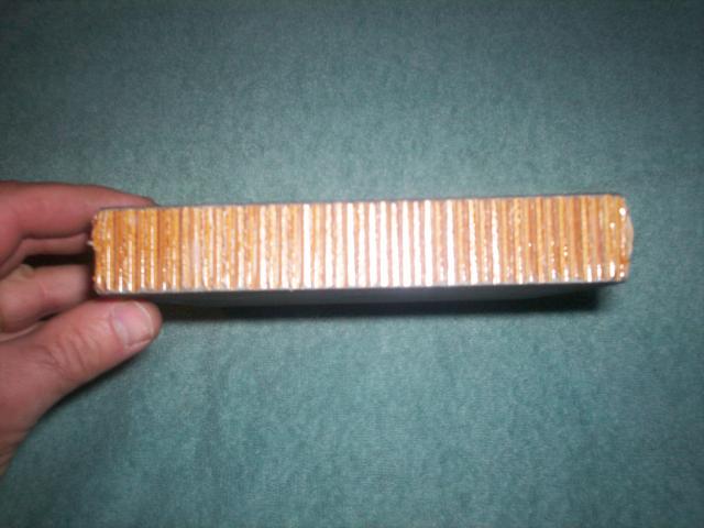

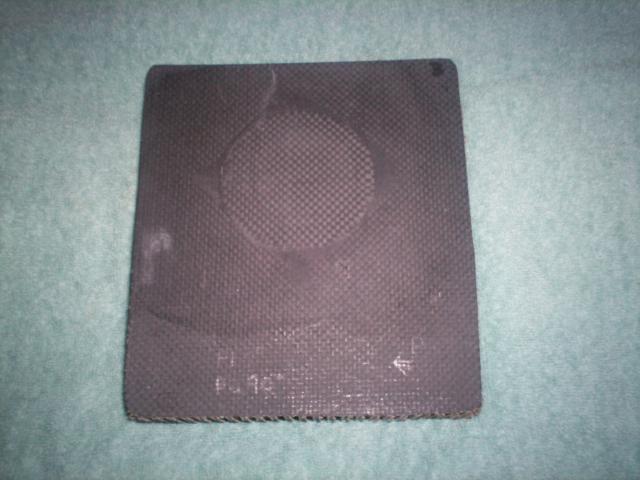

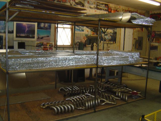

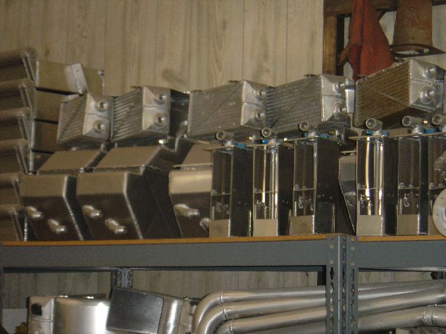

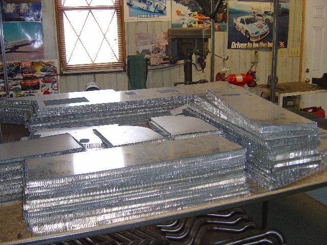

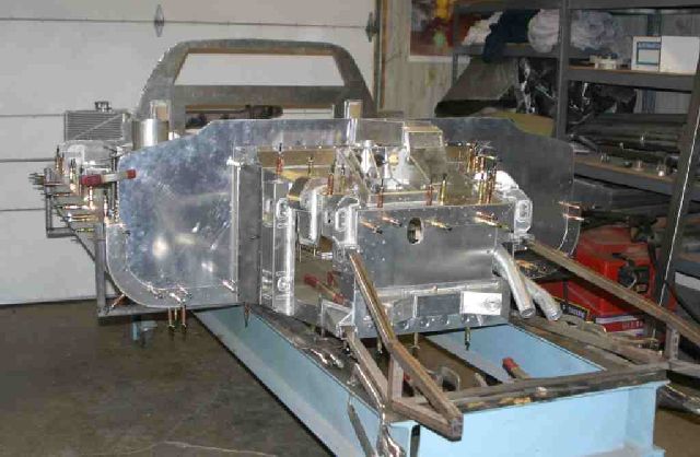

There are some very original MK4 honeycomb replicars being built right now. These cars are being built from original prints and take all original parts. Heres a pic or 2 that show whats available if your interested in authenic copies of those million dollar cars.

Looks familiar Jay :thumbsup:
Any weight numbers on those tubs yet?

They are very light. As the originals, most of the aluminum is .026 and .032 and once bonded together very strong. I think 2 small panels would hold a complete car up off the ground as jackstands. I have some scraps here and the stuff is amazing.

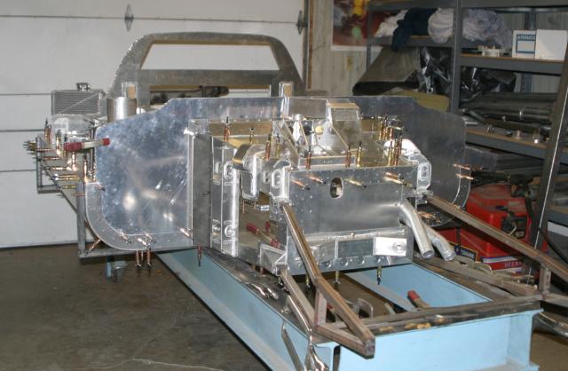

Are these photo's of Kenny's project?

Thanks Jim. I figured that it was a picture of Kenny's work. If I'm not mistaken, all tubs are spoken for at a price tag of $450k.
Yes they are Kennys project and the tubs are not for sale unless you buy the whole car. And 1 car might make it to Elkhart Lake this summer. And yes some of our parts are on those cars as well.
I am not sure how you could have recieved those pics in an email as I took all but 1 of them and have never emailed them to anybody
This is the picture Mr Tom Monroe send me yesterday. He had send me before some other pictures and James Holden had send me another bunch.

Just out of simple interest: What stuff are you using for bonding the panels?

This is not my project, my hands are full with the Mk1s and these cars are over my head. Kenny Thompson in Denver NC is building these cars.
