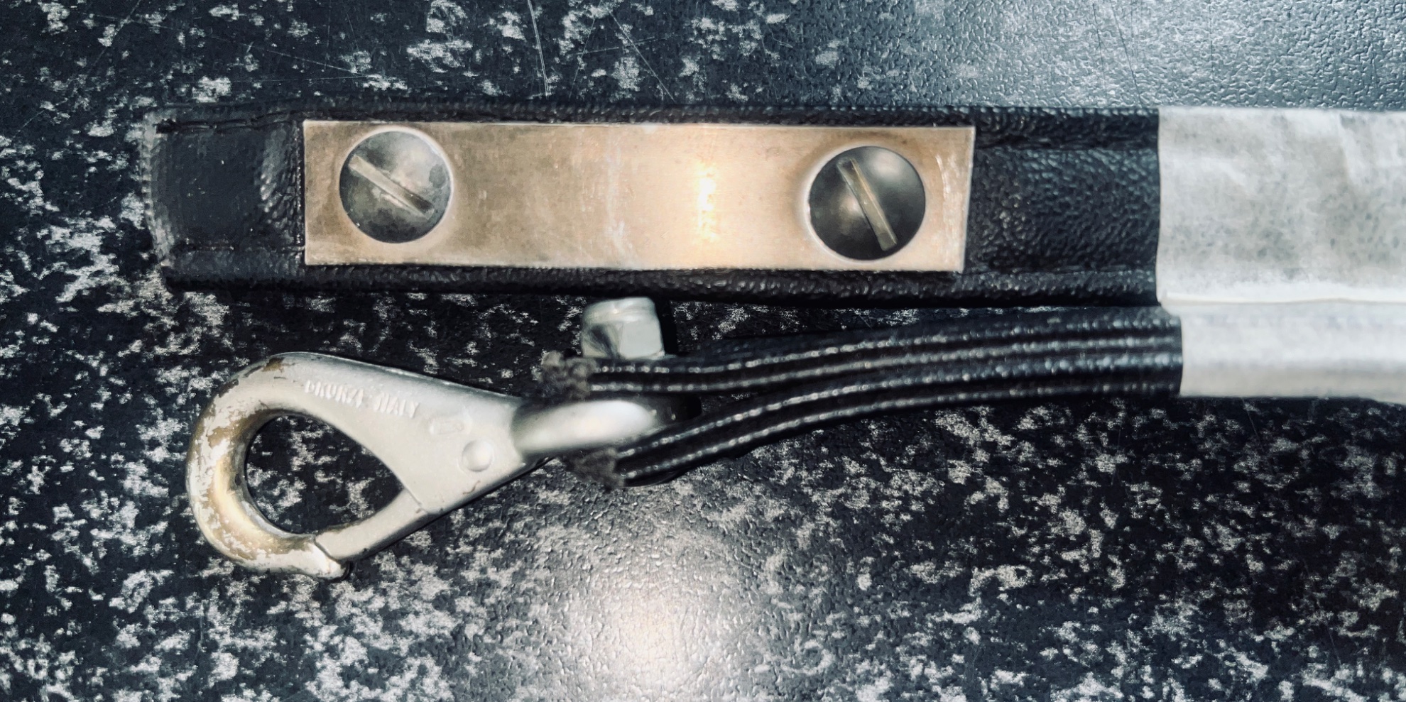

"straps" is part of it. I think it's normal just one. And it's a leather strap with a clip like you'd find on a dog leash, not a metal cable covered with a sleeve and a loop for a caribiner. (I wouldn't be surprised if the originals are leashes with the handle loop cut off).

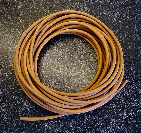

Orange spark plug wires are impossible to find, so I'm not going to fault them for that. (If I'm wrong, please point me to your source)

Just an FYI, you can not use vintage spark plug wires with a MSD box it has copper in the wires and this will blow the MSD box. Trust me I went through about 4 MSD boxes before we figured this out. The copper wire will create voltage spikes in the wiring loom.
It's out there if you look hard enough.
