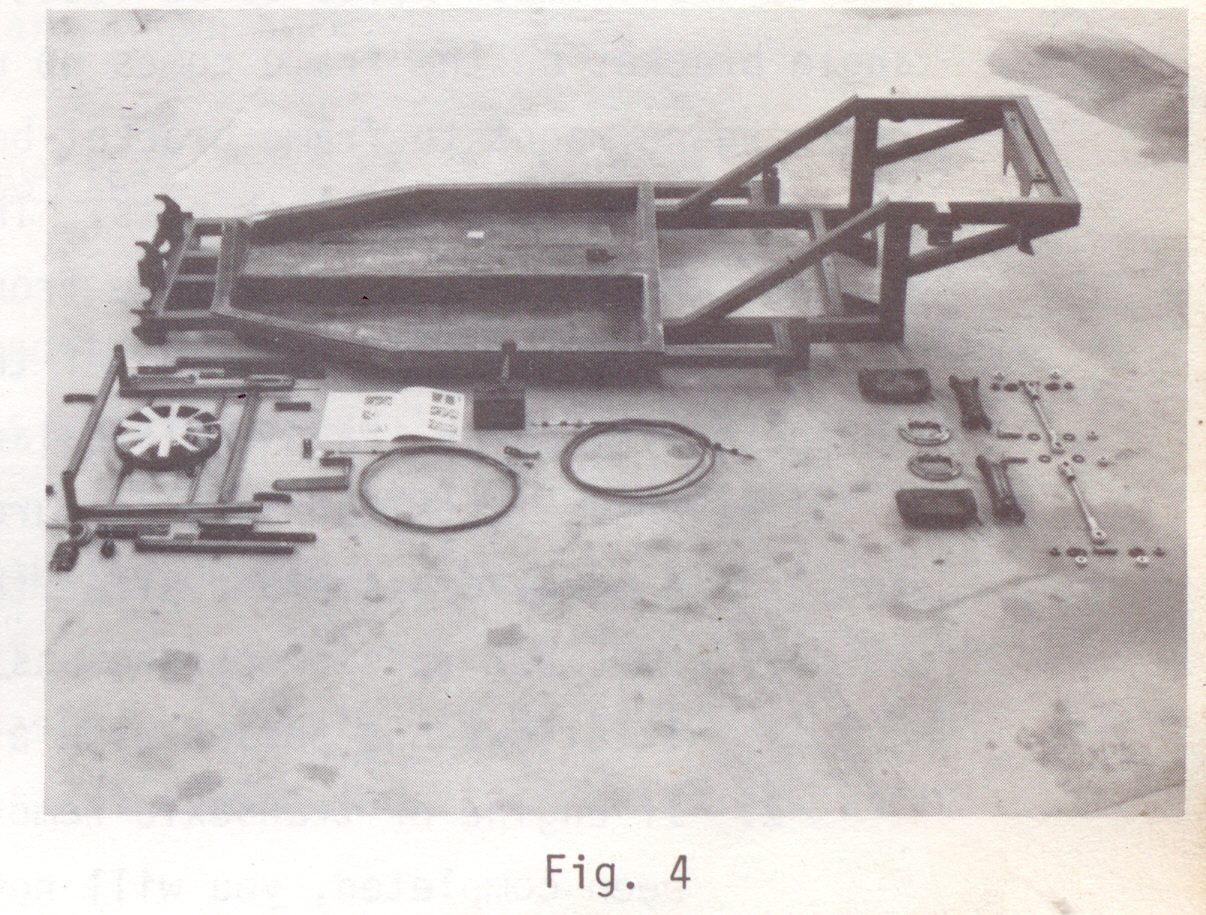

Here's a option that not many people consider. I started out with it. It uses a specifically designed frame which holds an Oldsmobile engine and transaxle. This engine combination is plentiful and cheap and powerful.
Attached are a few pictures. If you're interested, get back to me and I'll provide you with more info!

fiberfab co still exists and has a nice chassis already designed for that body and a v8 don't remember the site address but google it. Dan Richer is the owner and is easy to work with. I have one and put a Chrysler V6 in on a custom chassis. It works pretty good.
Richard

hmm.. a custom designed frame sounds alot harder unless i could find a used frame like the one your talking about in the area. I think i'm going to go with the fiero, mod it up, remount the rad and hopefully it works out.
