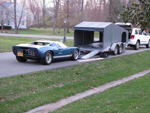

Attached is a pic of a Serpent Express. It is set up for both a Cobra and the GT. Opening were added to both sides so it can be either backed in or pulled in forward. It tows well. The GT is a tight fit on the 14' trailer, but it does fit.

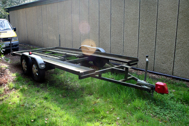

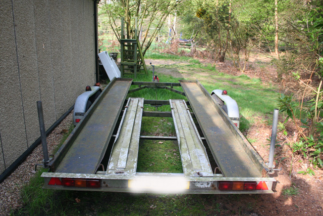

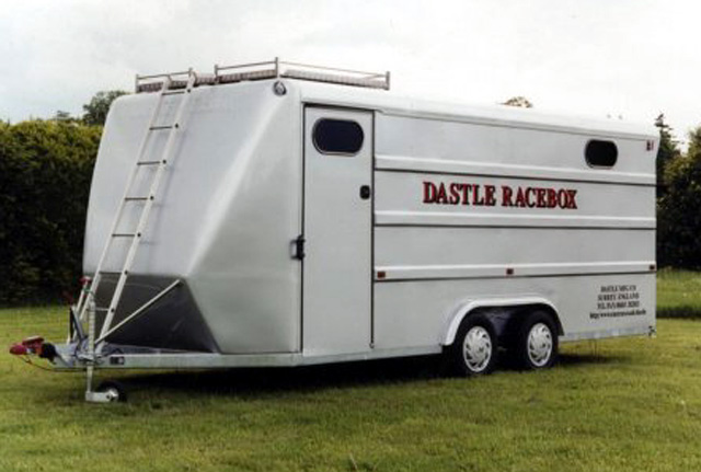

I am now on my third trailer in 20 years! Pictures below....
1st couple of p[ictures are of a trailer I made myself. Didn't save much money as I used good new parts but the design is of a slanted bed and long ali ramps so there is no beaver tail angle to speak of. It only weighs 512 kg so also easy to move about by hand. I also used the CoG of the 40 to design the axle positions so it tows like a dream. Can load this one in 10 minutes as I can reverse on. I still have this trailer as it is the most versatile and easy to use one I have ever had.
The enclosed trailer pic is not of my trailer but is of the same model. Agree with comments above about access issues. It was very tight for a 40, super easy for an open car and for the ProSport 3000 I had to dismantle the car and rebuild it in the trailer. A bit of a faff and you needed a second pair of hands to help. This trailer weighs 900kg and was not really very easy to move about by hand. I used my garden tractor to pull it about. when towing an enclosed trailer versus an open trailer side winds really do become more noticeable. Maybe non UK regulation allows for wider trailers than we can have here. Certainly seeing the rigs used at VIR, they just wouldn't work in the UK both legally or practically. Just way too big for our roads. So I sold this trailer and got my latest trailer.

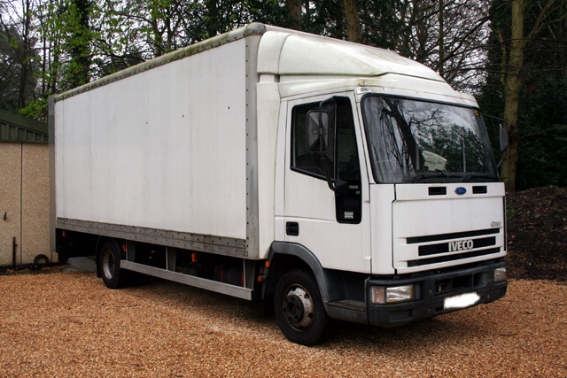

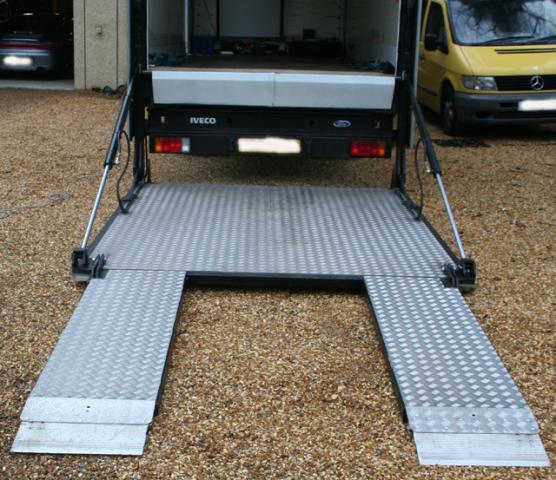

This one is brilliant. Easy to load and you can still walk about the car inside the back no problem. This one weighs 5500 kgs empty but is self propelled. Very pleased with it indeed.

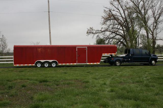

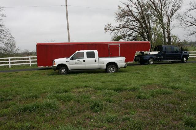

I just bought this trailer 2 weeks ago, its 49 foot long, can put two cars in it easy, also just got home with this GMC5500 Topkick, it has 135 gallon of fuel capacity so I can go 1350 + miles towing without fuel stop, and almost 2000 without the trailer. Leaving this morning for Big Bend Open Road Race in south west Texas. This is the first time I have ever driven a truck trailer combo that is 63 feet long. :) My friend Mike Trusty and I have been doing events for the last 20 years and its great when we can travel together with both cars and wives and there 1000 lbs of luggage. :) Oh by the way I am selling my F350 dually I had since new, just put 1000 bucks of tires on it, its a perfect truck for a single car trailer if you know of anyone who wants one for a good deal. Its a 2001 with the 7.3 liter diesel, which is a little short on HP for pulling this big trailer.

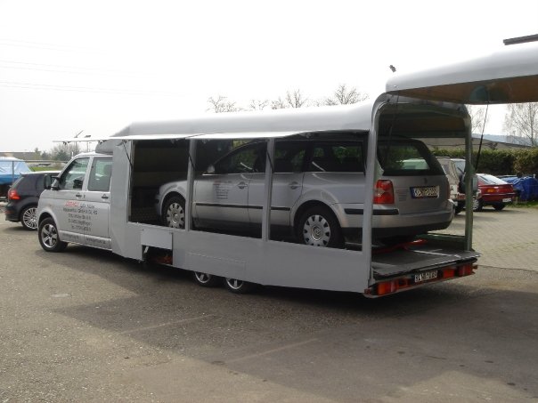

Urs

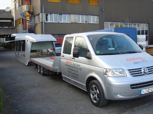

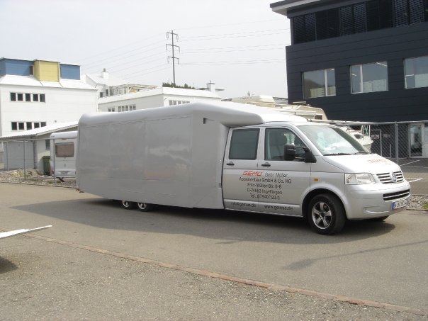

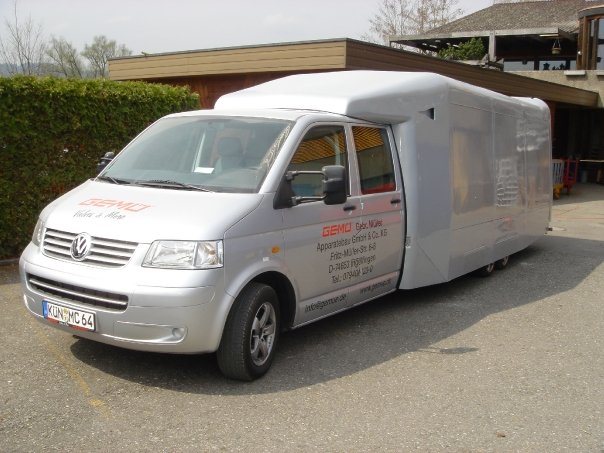

Hello together
we also builded a trailer ing GFK for a customer.
It s around 230kg

The Serpent Express that Chuck posted an image of above:
attachment.php
is an all-aluminum and comes in 14, 15, 16, or 18 feet deck length.
65 Serpent Expresses are successfully in service.
Advantages:
- Lightweight (only 1100-1800 lbs
- Easy to tow: Explorer class is acceptable (big F-Rig not needed)
- Aerodynamic - easy on fuel, keep up w traffic.
- Small, easy to park and store
- Custom made for your car.
- Top and frame removable for multi-purpose use of open trailer.
The soft top keeps your car clean and dry on a trip.
Security is better in a hard side but we use alarms for peace of mind at motels, resturants, etc.
6-8 week delivery; Lower Michican FOB point on all-aluminum. Steel in various locations.
A new "Retro Kit" is available for converting existing open car haulers to add the soft top.
