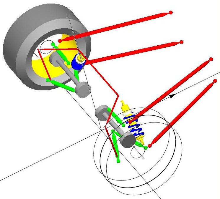

I remember a discussion regarding a computer program that has the capability to enter a twin trailing arm suspension like ours. We have been fudging the figures for a double a-arm but that uses a single point for the upper and lower ball joint.Help?
J What,
The program you are looking for is Susprog3D. You can buy or go and get a trial download from www.susprog.com
Here's the example they give:
Brett
