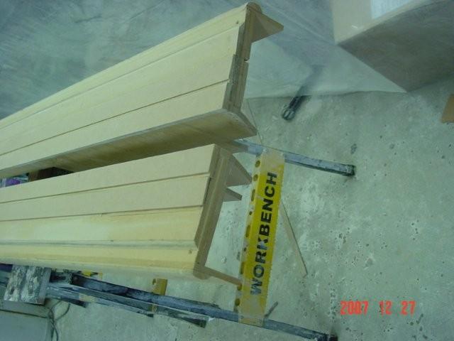

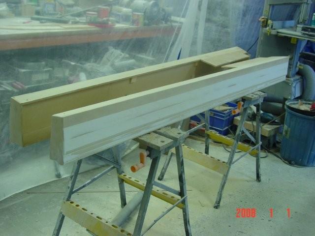

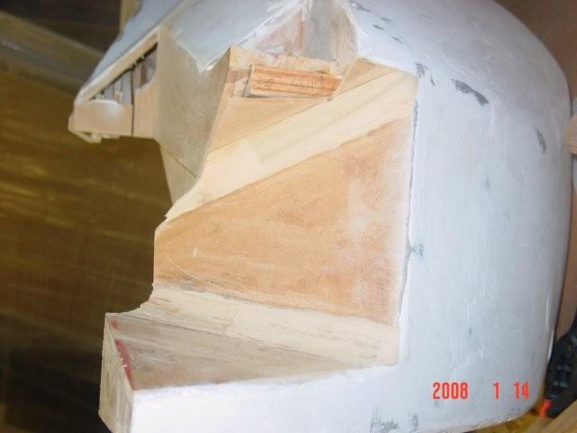

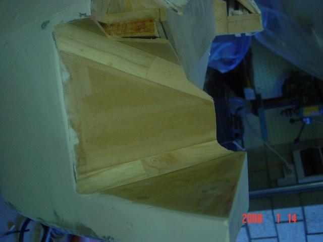

finally some pics
digressed from main body filling and sanding for a while.
sills needed to be widened to match body, closed and rough shaped at each end
projections on top faces are the sections in doorway
roughed in the top and bottom radii on either side of front air intake
thanks for comments and info
Des
