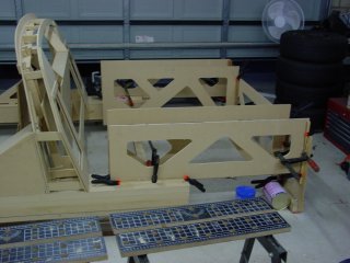

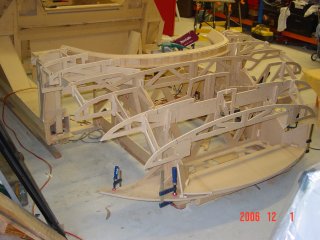

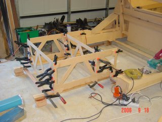

We are building a replica GT90, and yes kits will be available subject to interest level.
Chassis is aluminium (no not space frame), engine at this point is Supercharged Ford Modular V8 with Porche G50/52 transaxle.
Of course if your funds permit there is nothing stopping you fitting the 2005GT motor and transaxle.
Current status is as per attached pics, skin is about to be added as soon as the doors are done.
For those that know him, the project is being overseen by Denis Bedford.
Regards Des

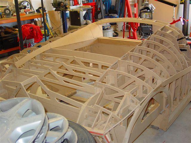

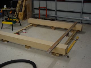

I'll add some more pics as we go, maybe some older ones if there is interest.
Des, That looks like a ton of work. You must be an aircraft builder. What are you going to skin it over with?
FRPGuy
The aircraft builders will be cringing, no I am not one.
Skin will be mesh and GRP

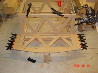

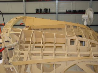

Some more progress pics, doors are coming along nicely. pics will follow in due course.
The stacking up to the right is my Opera browser it autoloads the attachments, so ignore the question.
Fantastic work, Des. Please tell me it was done with CNC and not a jigsaw!
I too would like to see as many build photos as you care to show us.
-Please tell me it was done with CNC and not a jigsaw
I could do that, but try a bandsaw, jigsaw and matching on a linisher.
-Where did you get your drawings
Hard work.....some smoke and mirrors, more hard work.

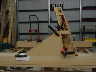

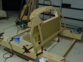

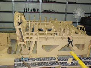

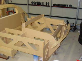

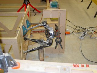

Anyway some more for you

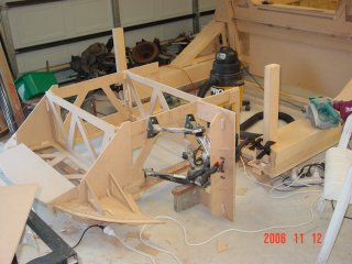

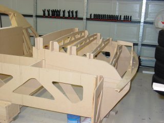

Leaving rear and moving onto front end.
Starting on base of nose section, main air intake and stations (ribs) added for upper surface of guards, nostrils and bonnet (hood or radiator cover)
Door pillars and windsscreen front edge added as well
More to come.

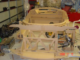

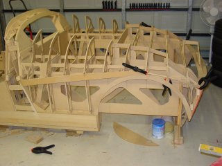

Snowy glad to be of assistance, amazing how far a dozen or so sheets of mdf will go.
Scary bit now is I can see the light at the end of the tunnel with the wood work.

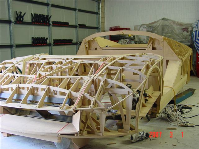

Started in Aug 2005 with pics, models and rough ideas
first cut wood in Dec 2005.
It's a full time obsession, at least as far as work and council noise laws will permit.
Weekends and wherever possible most afternoons.
