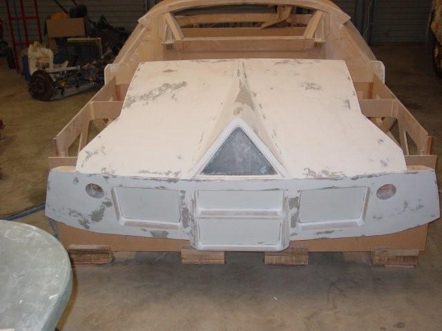

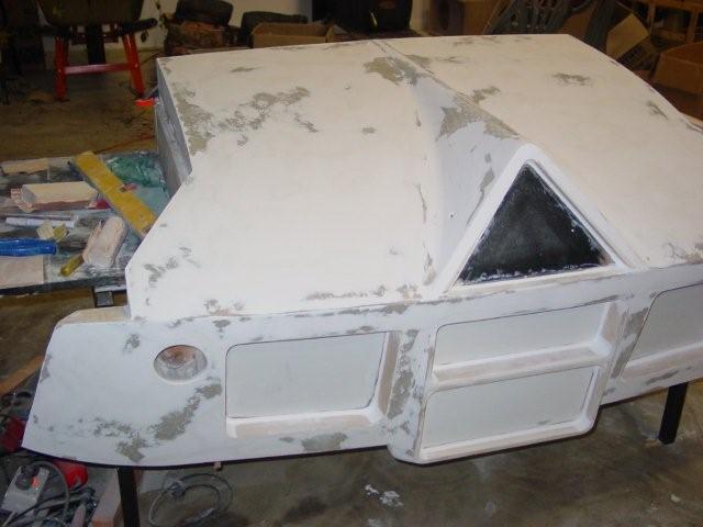

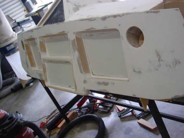

GT90 from ground up

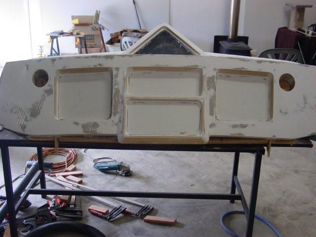

redid corners of number plate recess (top center one) smaller to allow deeper recess and better accomodation of plate light
rear infills now glued in place and corners filled
what a time consuming process this has been.
currently working on top of deck
Des

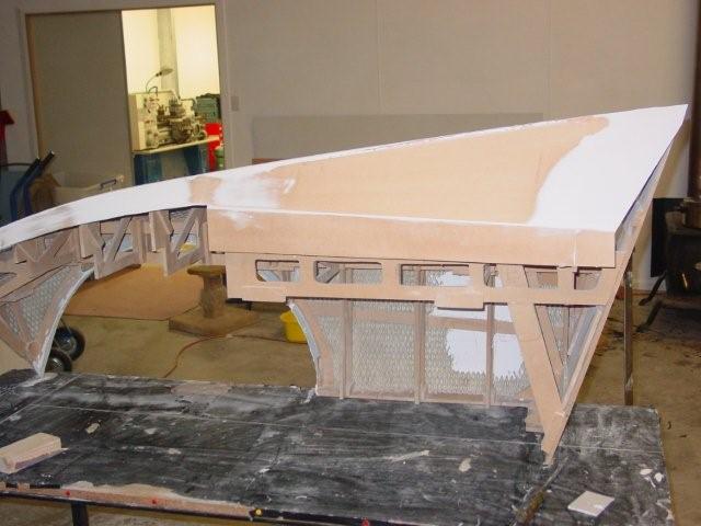

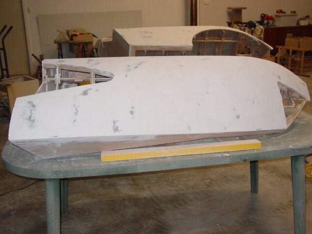

thanks guys

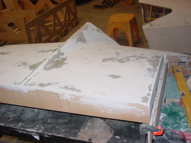

still chipping away

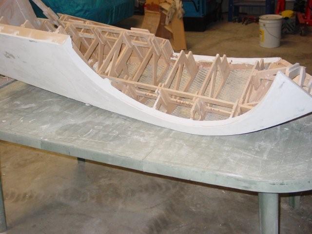

top of deck has been interesting, fine tuning surface curvature.
was not happy with overall ridge shape, spent last few days fixing it
almost finished this bit
Des

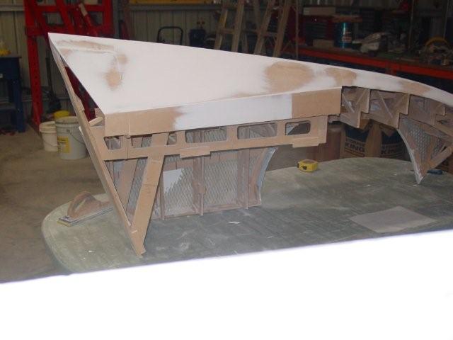

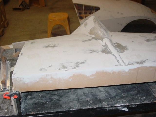

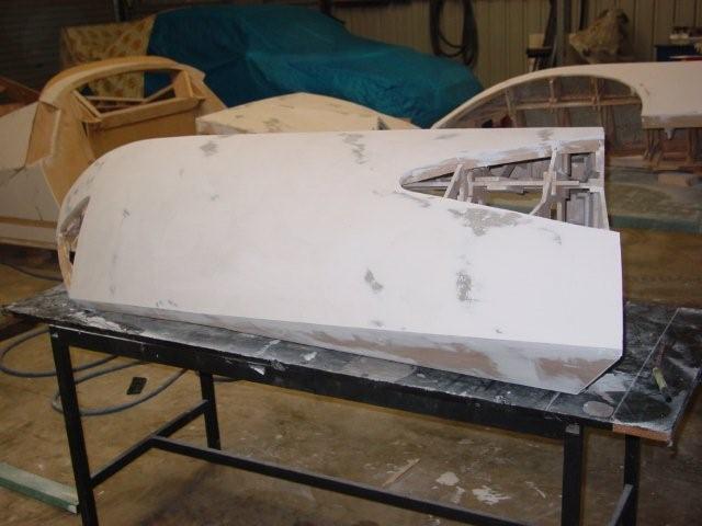

deck "finished", well this stage anyway and back on car.
rear guards underway and starting to look reasonable
Des

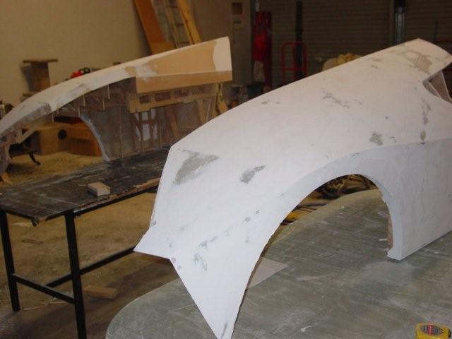

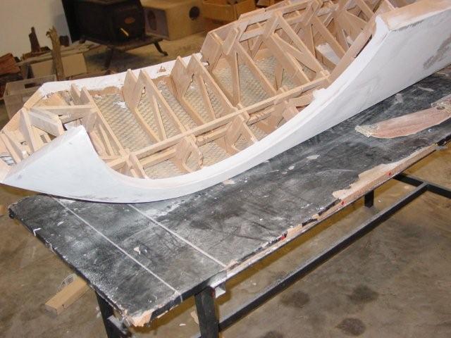

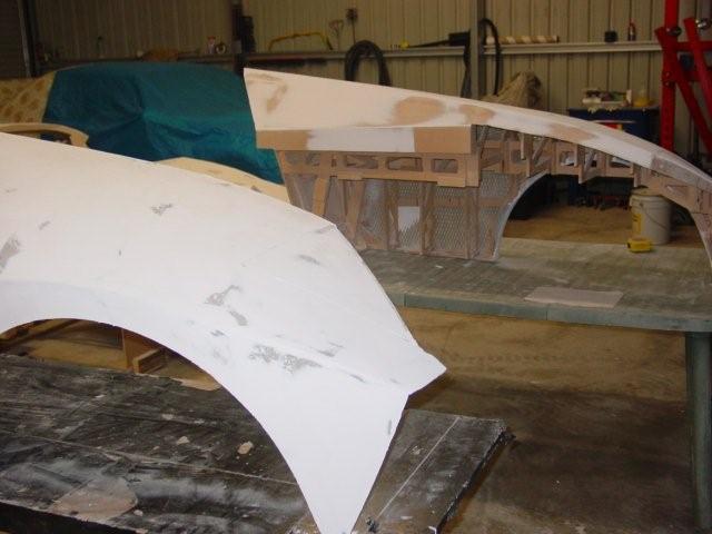

some more progress
rear wheel arches built up depth wise and curve finished prior to edge being radiused and infill being added.
tail lights were placed in holes and puttied over for contour
one has been shaped and cut out, other almost finished and ready to be cut out.
engine bay sides straightened up
front tops of guards have been fitted to arch
front lower edges are yet to be matched to arch or "triangles" and lower edge to sill yet to be matched
lines on top are starting to straighten up nicely
