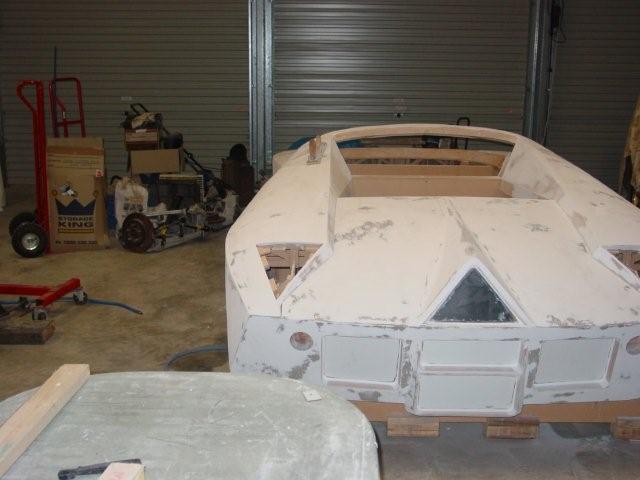

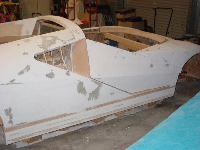

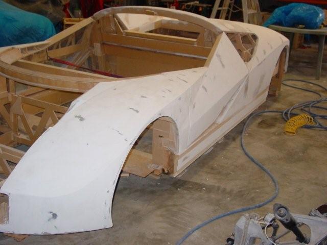

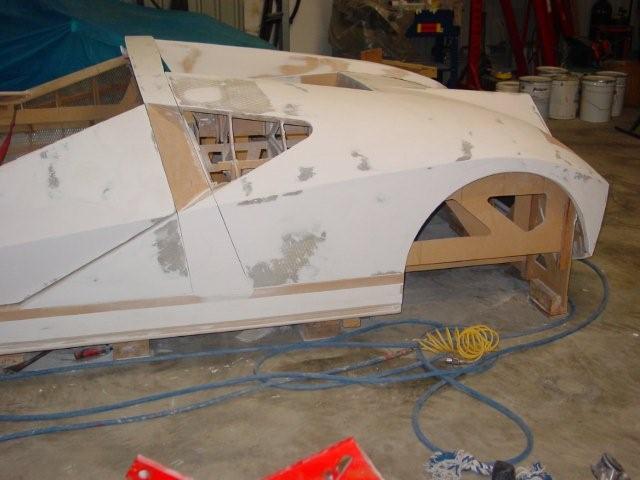

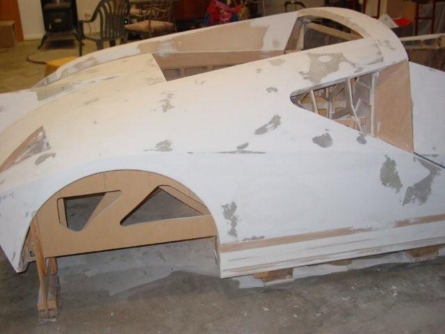

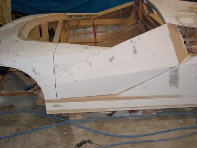

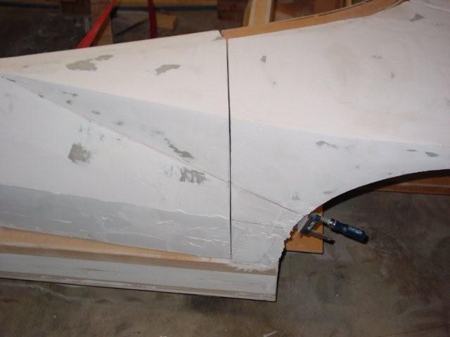

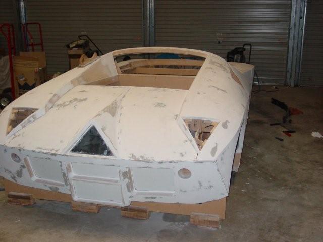

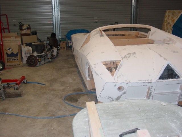

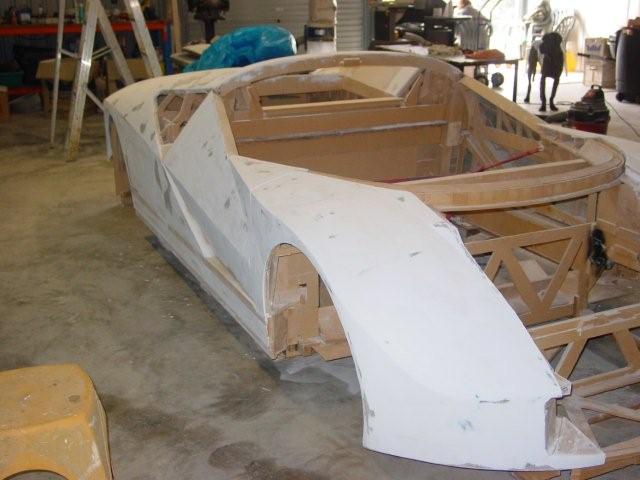

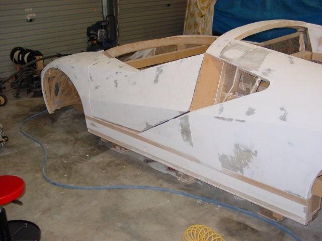

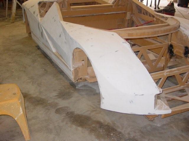

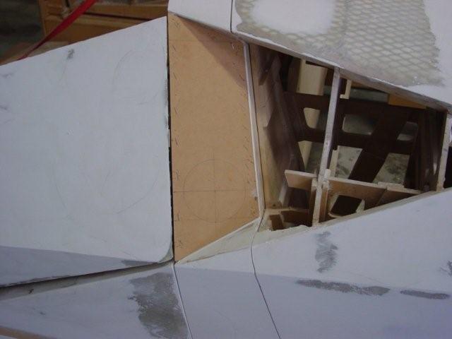

some pics finally
fine tuned door closing positions and working on blending rear guards to arch to triangles and sills
slow going during this stage chasing line flow from rear guards through doors to front
lunatics
you still have a fair bit to go yourself, should be a looker when finished.
Des

Still looking great Des, so keep it up.

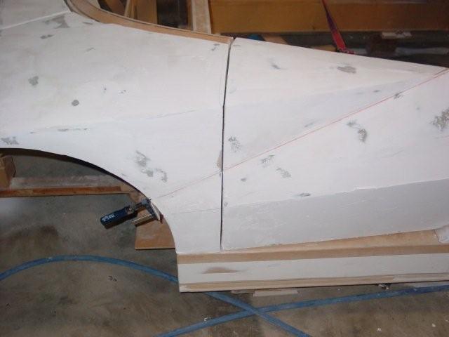

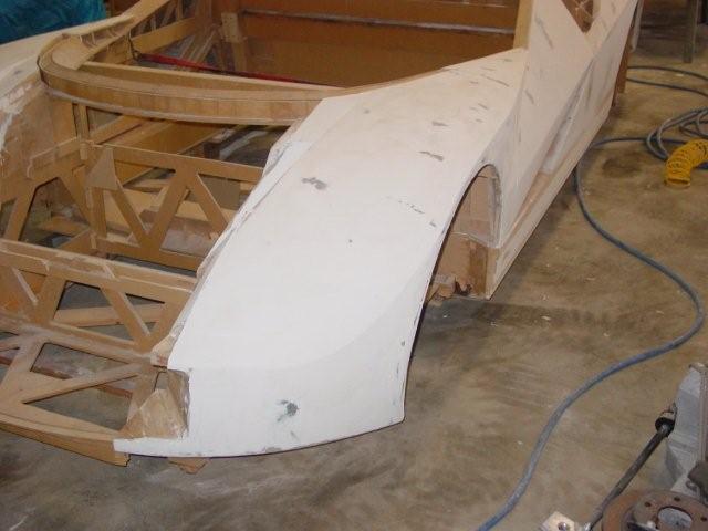

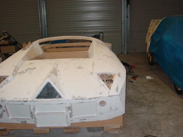

sides of rear guards, arches and triangles are finally playing nice and are all on the same plane.
lines are now close to final
I have started on doors and front guards to continue the lines through to front arch.
door to guard edges and gaps coming along as well in process.
Des

Fantastic work there! When you work out the parting lines for the mold try to get them in an easily post finished location. Really an awsome job you've done. I did a Maserati A6G-CS body using the same method. Took me the better part of a year working alone.

yes it sure is, once this pass is done I still need to go over all panels one more time then the top coat.

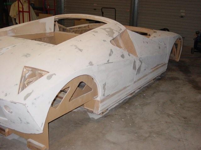

some pics
doors are almost done and front guards are coming along
lines to front park lights are on track (at least to where they will be)
redid the left fuel filler panel to better fit door edge/surface
(staples are just till glue dries and then it will be puttied in)
Des

Des, in the close up picture you can see all of the different angles that you have created from wood, I am glad that you have chosen this project because of your amazing attention to detail and dedication. I am just as hooked on this project as I was when I first seen it. Great job Des. :)
