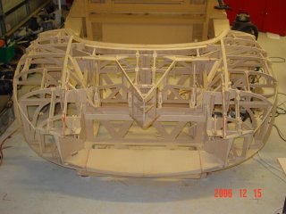

Some more pics and very brief descriptions

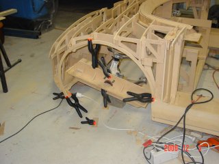

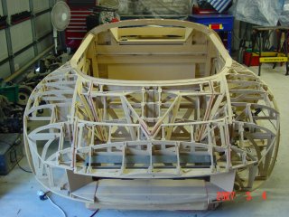

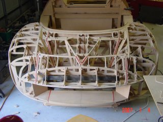

Front wheel arches added suspension/steering geometry and clearances checked
Nostrils and front cover cut free from stations
A lot of cleanups and edges added in prep for mesh
"radiator" inplace for sizing, clearances and airflow.
At this point each small step was taking days, lots of fiddly stuff
Starting to look like the real thing.
This concludes the history, doors next.

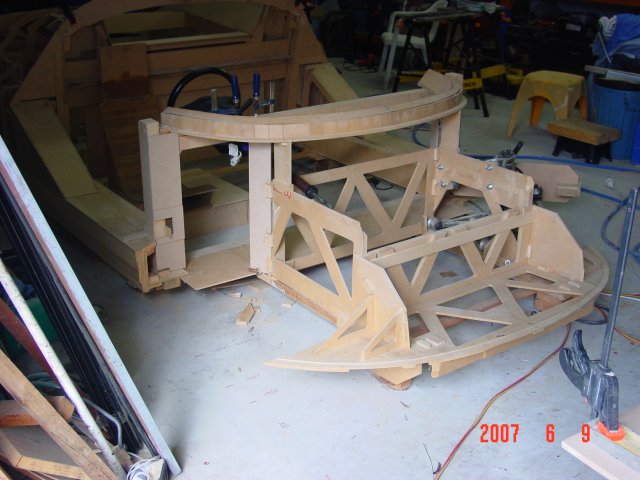

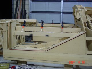

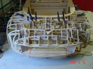

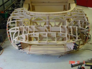

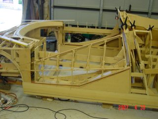

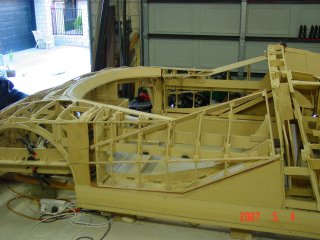

Door frames added
hinged and pivot points tested for swing clearance
stations (ribs) added
guards extended back into doors
A couple of shots of front.
ready for skinning

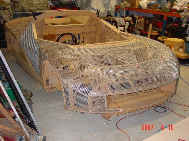

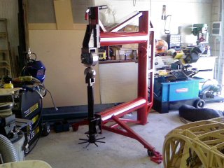

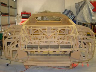

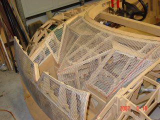

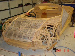

mesh skinning started

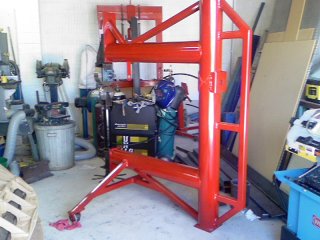

a couple of pics of an english wheel I built to assist in forming the mesh (yep glutton for punishment)

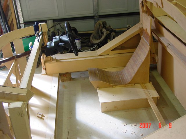

before I skin it completely a few things to fine tune on chassis dimensions while I can still get easy access

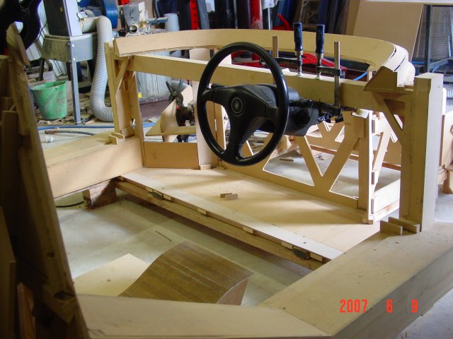

drawings are great but you can't beat actually sitting in it full scale and getting all touchy feely
(suggest not doing this in sight of neighbours or with engine noises)
I am 6'1" so space is important
steering column roughly in place
seat height and position using a roughup on correct height "floor"
checking cabin space for pedals to see if firewall needs to be moved fwd etc

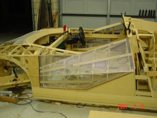

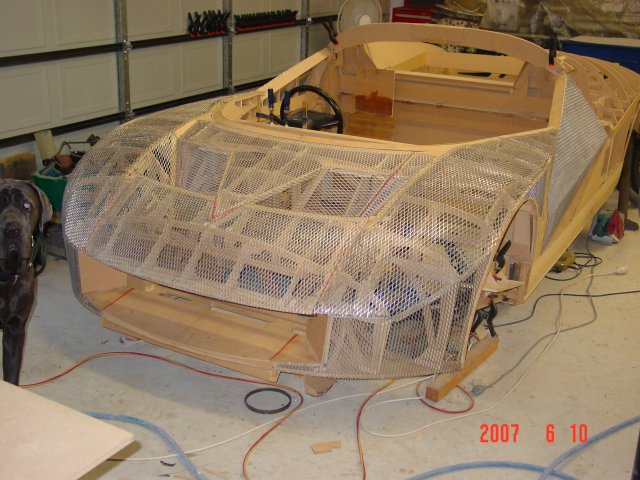

Some more pics finally.
a couple showing "seat" and "floor"
floor and "kickplates" with new firewall position.
"chassis" with guards etc removed, yes the "panels" all lift off so they can be worked on or give access.
Even the front section/cross piece (radiator etc section) of the chassis comes off.
mesh added to top and sides of guards.
my respect for sheetmetal workers that shape it by hand has gone through the roof.
Complex curves are a pain, even in mesh.
Door inner panels next
I increased res/size of pics, if these are too big for the guys on dialup, let me know and I will reduce them again from here on.
Des
