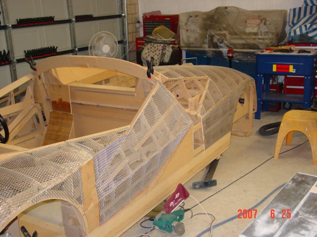

did you use any computer programs to get the rib mesurments correct? or did you just put a ruler on a picture and hope for the best??
also, is the mesh/ribs lying flat enouph that you can just lay the fiberglass right on it? or will you need to putty it up and smooth out all the little edges from the ribs. (I have never seen this method, usually people use foam it seems instead of wire mesh) Are you planning on building a mold off this and hten a body? or the body directly on this, and then removing the wood from underneath it? So many questions! keep us posted.

This will be glassed, then bogged and sanded(many times)
Moulds will then be taken from this plug/body buck/pattern, which will then go into storage.

Yes and No, I did not measure pics and hope for the best. Pics were used to double check how things should look.

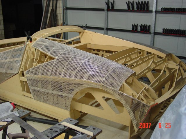

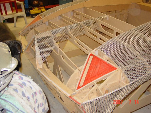

Got some time on the beast over the last couple of days.
Meshed on top of rear guards as far as tail lights and down sides around rear wheel arch.
Now we see if Murphy says I need to buy another sheet or not.....
Des

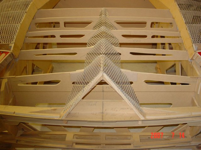

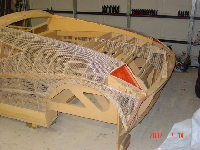

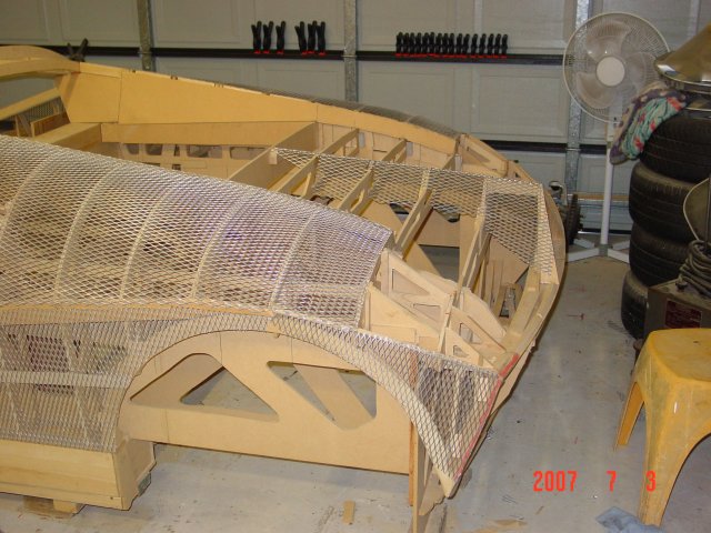

Finally some more pics
meshed "V" recut the stations under the guards to fit chassis and added "tail lights" in prep for meshing
extended slope on inner edge of guards to rear alongside tail lghts(roughed at this point)
meshing the valley/rear deck next
Des

damn it man you almost killed me !
i was drinking my coffee when i saw the thread had an update, i choked !
shit, this thing looks awesome especially the "brake lights" it just looks awesome AWESOME ! AWESOME !
