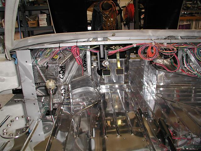

I have a Tilton hanging box with no servos and the installation required no fabrication. Malcolm found my pedal box mount in the UK and unfortunately I do not know the source.
Brian.

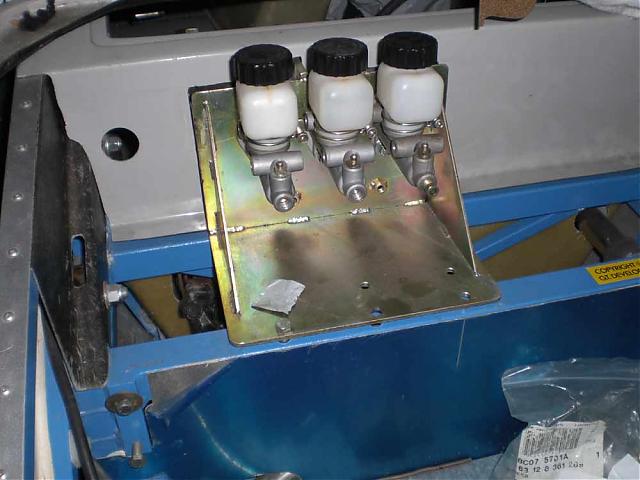

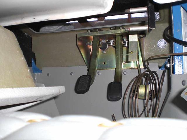

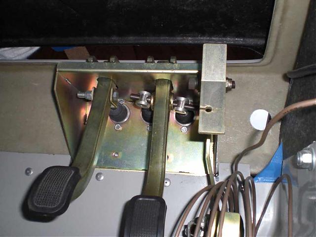

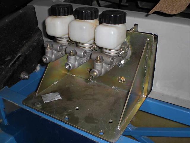

some pics of my pedal box. seems to be a perfect fit.
