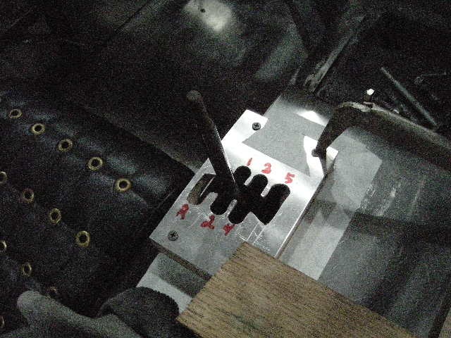

I have seen on bobs gtd post that he has the same shifter linkage as me .
But inside his car the shifter is reverse compare to mine ( on mone rear and second gear are up) .
The second think and that I want to have a more precise system .
There is some space between the axle and the hole in the master piece .
Do you now if I can buy somewhere this masterpiece new ?

I was talking about the pieces were cable are connected on the box .
What I don't understand is that on the picture that are attached it is the Renault gearbox , same connexion on the box but on my car the shifter is reverse compare to the other picture I attach .

Salut Manu
Effectivement la sélection est inversée entre ces deux montages... Sais pas pourquoi, mais ça doit venir de la configuration du levier de vitesse qui doit être différente.
Je te conseille aussi de suivre l'avis de Mike ou Malcom, j'ai moi aussi sur ma GTD une sélection par tringlerie, et c'est un autre monde par rapport aux cables du montage GTD de base. Ca en vaut vraiment le coût qui reste raisonnable. Tu retrouve du feeling et une meilleure précision...
En plus, mon mécanisme de levier est très inspiré de celui des GT40 originales et c'est vraiment beaucoup plus joli (mais première en bas...).

Hi Manu
Actually the selection is reversed between these two fixtures ... Not know why, but it must come from the configuration of the gear lever to be different.
I also advise you to follow the advice of Mike and Malcolm, I also have on my GTD selection by linkage, and it is another world compared to cable assembly GTD base. It is well worth the cost is reasonable. You find the feel and accuracy ...
In addition, my lever mechanism is inspired by the original GT40 and it's really much nicer (but first down ...).
