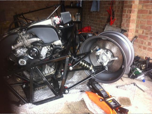

Just to add to this, Mike was explaining the ackerman.
My up rights I made so I can change steering arms.
I made a set of major anti ackerman arms ,F1 style toe in on turn and it turned in very very good.
Its a bitch to get in the garage though.
