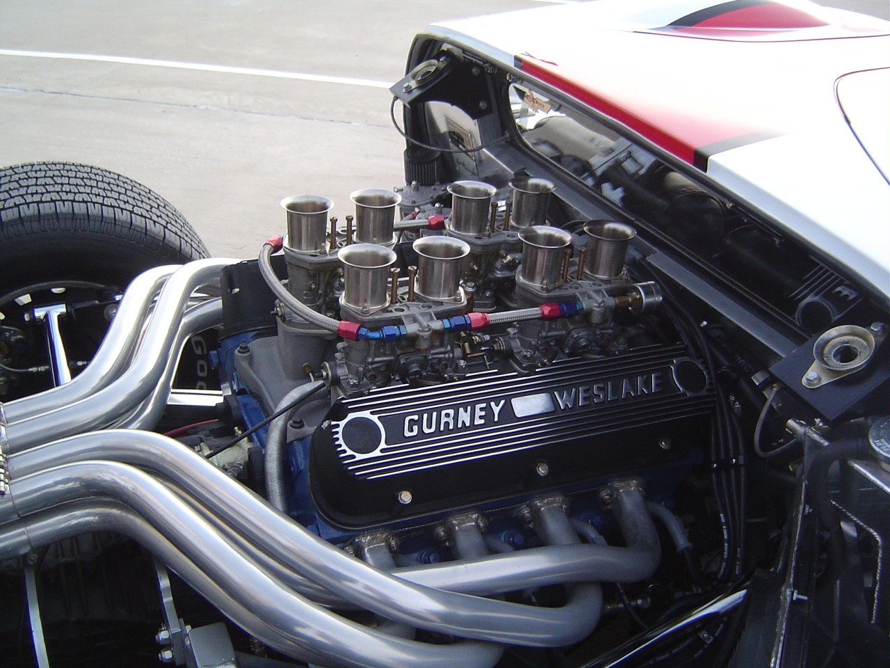

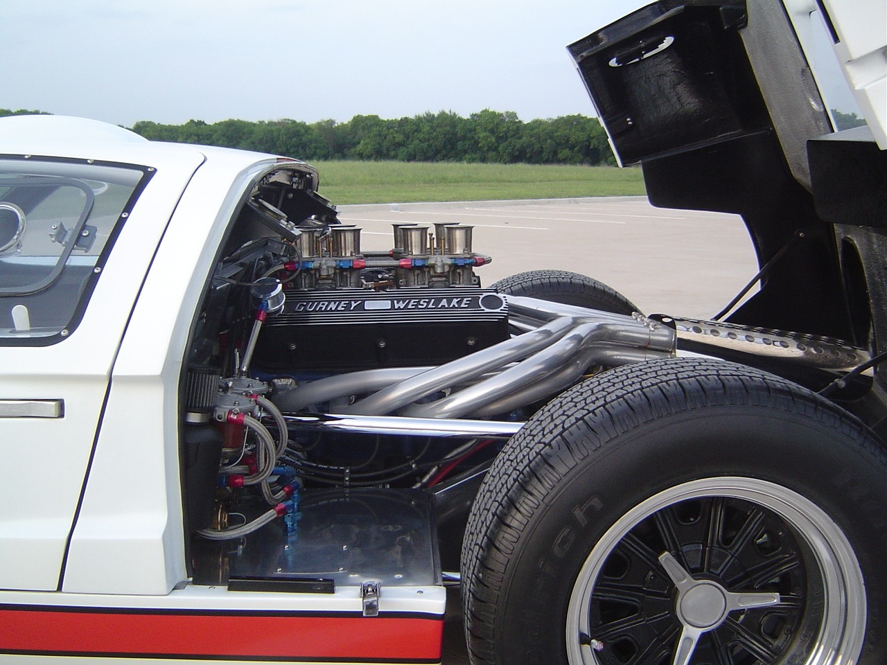

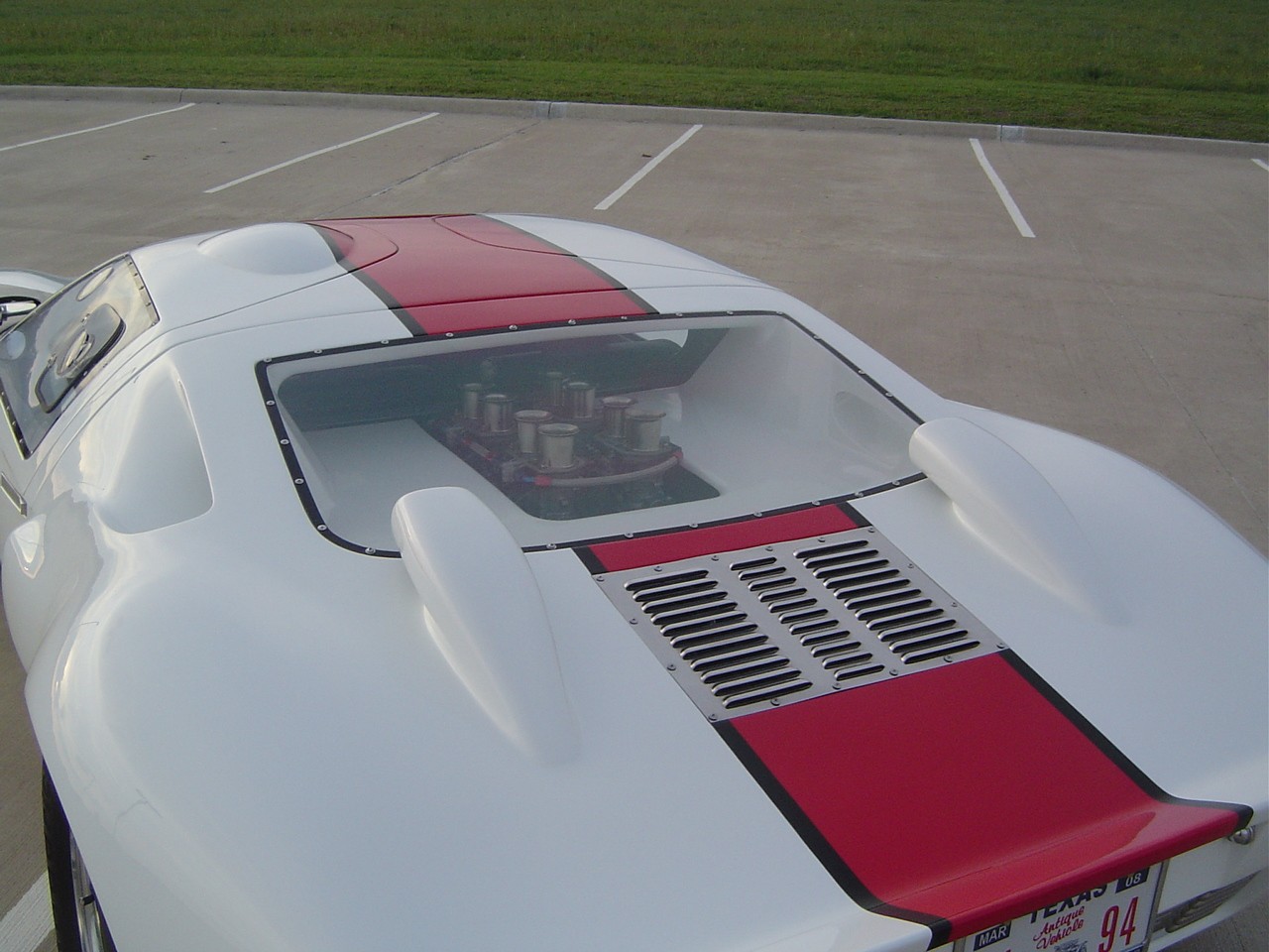

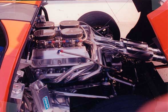

Hey Robert,
I had a GTD GT40 back in 2005 and had the UN1 transaxle with 289 and 44 IDA webers. No issues with clearance see attached pics. By the way I now have a CAV GT40 and Sam Watson in McKinney has new CAV also so we should get together some time.
Tim Kay
The pics above are IDF not IDA, quite different. In addition, looking at gary's engine position, it appears to be mounted more forward than usual, at least in my very similar Tornado tube chassis. notice the 'relieved' tube under rear cabin window, dizzy clearance. Also, in the pic of the rear clip closed you'll see the carbs appear more forward therefore more clearance of the flat deck fiberglass, under the the plexi, to the rear carbs (more plexi clearance as well)

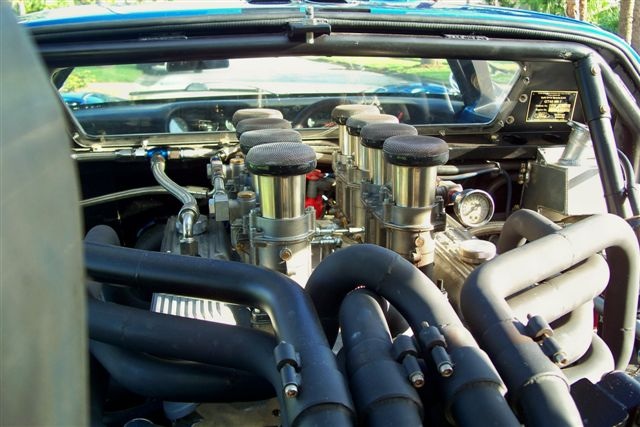

Here's a pic of IDA's in my SPF, even with the bodies (without air horns) being taller than IDF's you'll see they don't exceed the bottom of the cabin window.
