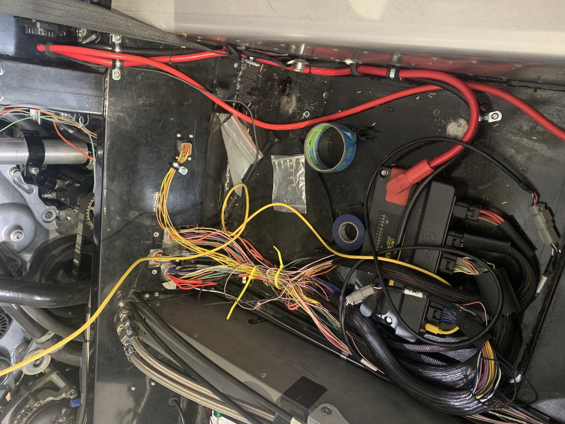

Currently working on the wiring on my build, and have chosen to use the Nexus R5, as with all Haltech the quality and software is excellent, but these units have a lot of wiring to take care of, i used the terminated harness for car and engine, it’s has a huge amount of features, i also incorporated a PD16 module to take care of the extra electrical items up front. It probably has more functions that I will use at first but will add more as I go, Traction control is an easy set up and I will definitely incorporate it. I am using cannon plugs from cabin to rear, so if the engine comes out, all I need to do is disconnect 3 plugs.
