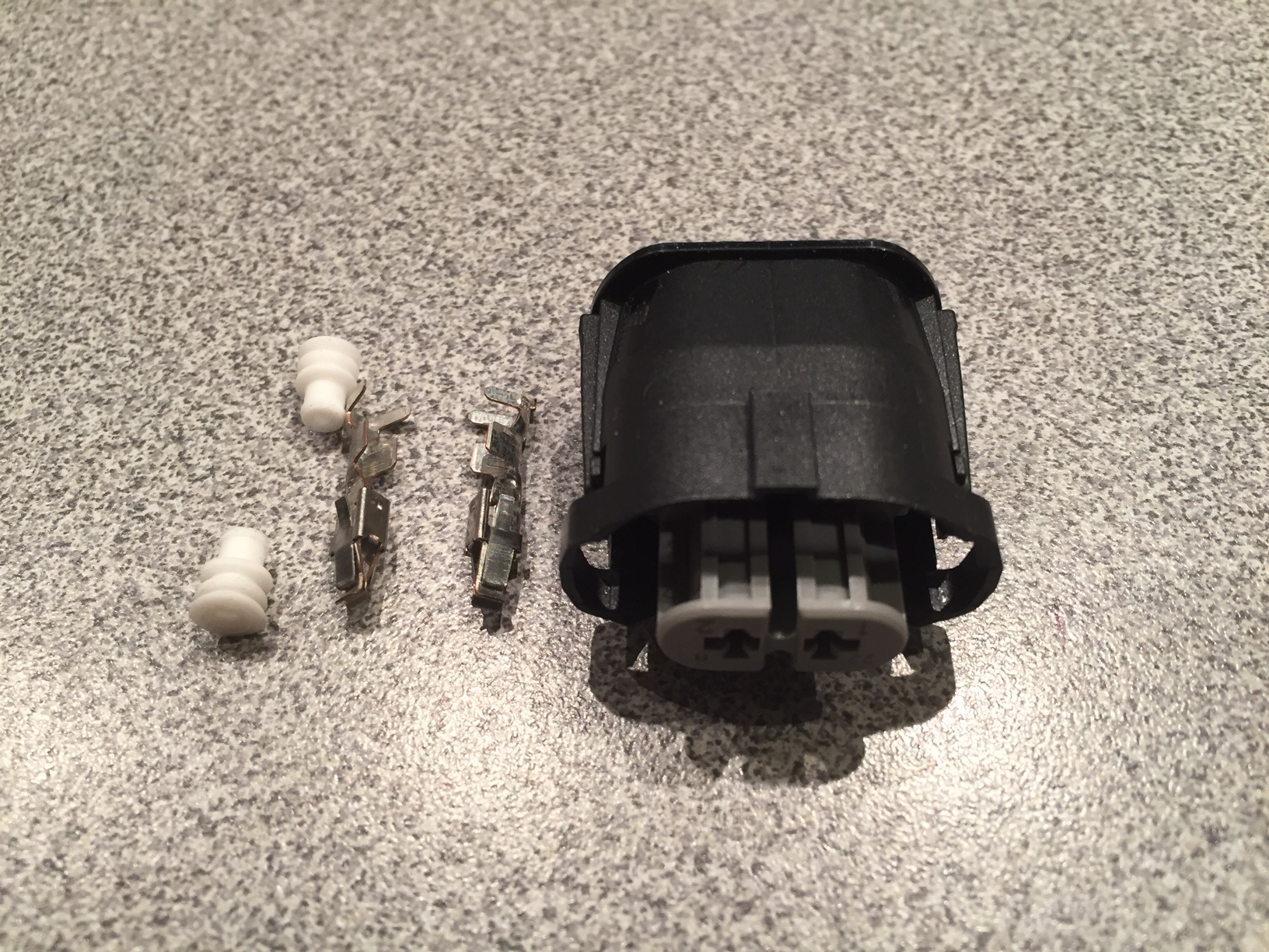

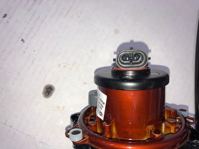

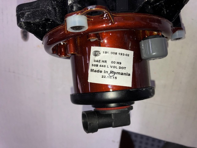

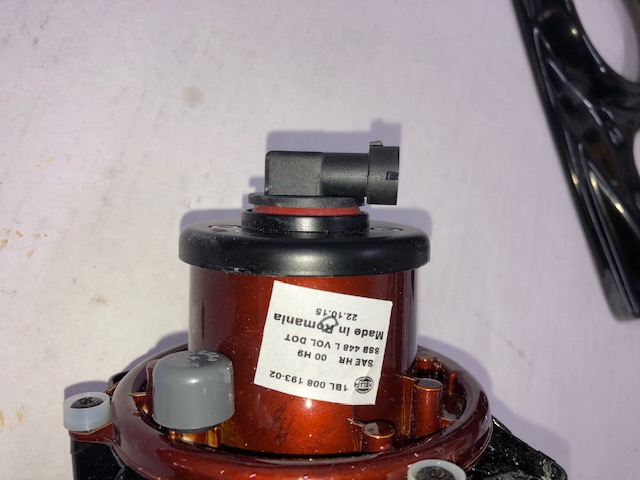

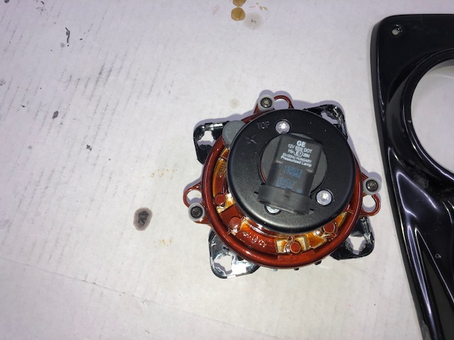

M Mark Setter Dec 12, 2018 #1 I am ready to make the wiring harness for the headlight of my GT-R, but don't know the connector that I need. Does anyone know the part number and where to order the connector for the Hella headlights? Attachments IMG_6357.jpg 73.3 KB · Views: 309 IMG_6358.jpg 67.2 KB · Views: 347 IMG_6359.jpg 64.9 KB · Views: 299 IMG_6360.jpg 69.3 KB · Views: 348

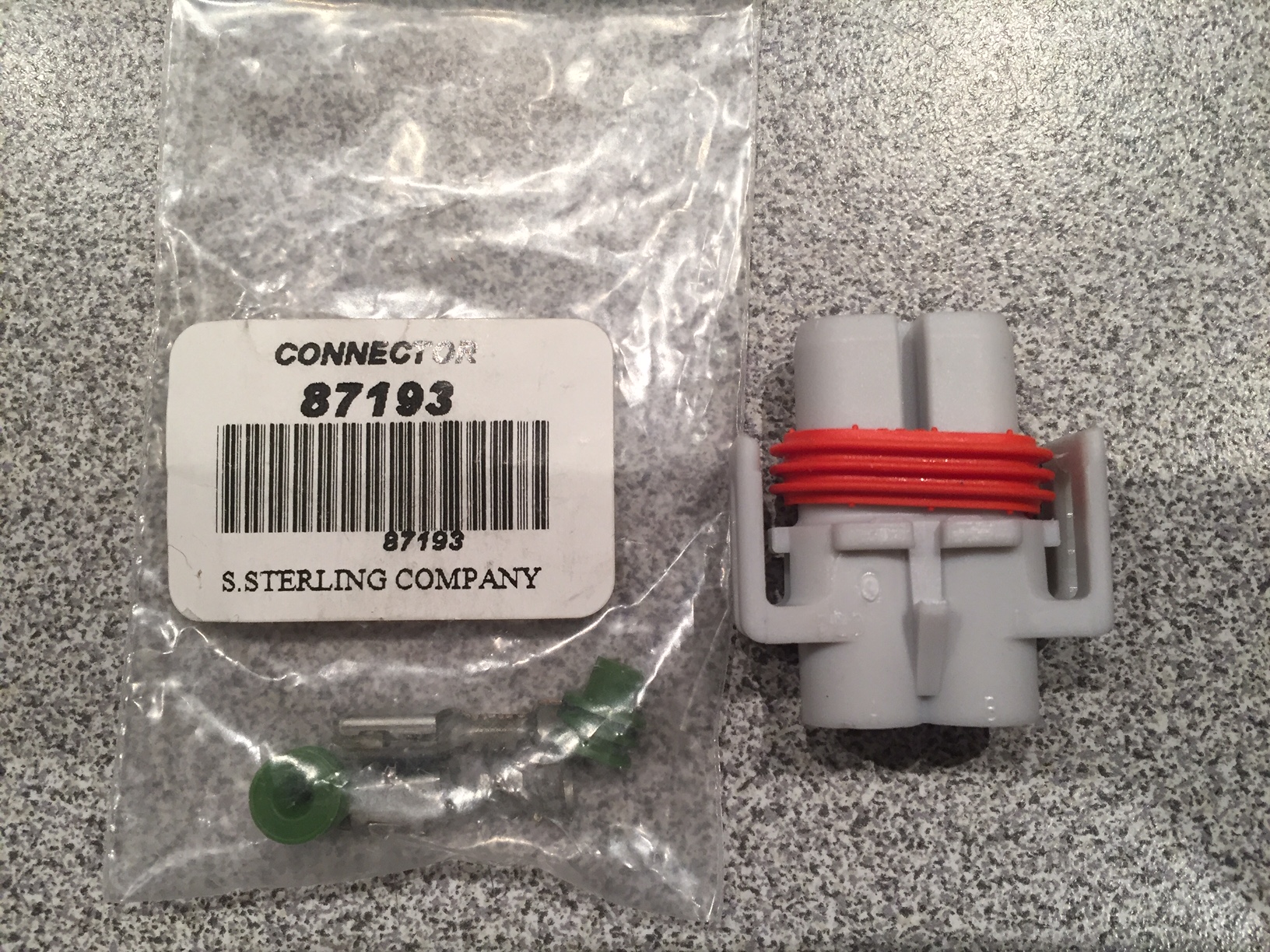

Ken Roberts Supporter Dec 12, 2018 #4 Here is the connector that came with my Hella lamps. Part number is #87193 Can be bought here http://www.partshubdirect.com/products/hella-90mm-h9-connector-87193 Here is a picture of mine. Attachments IMG_2298.JPG 912.7 KB · Views: 316
Ken Roberts Supporter Dec 12, 2018 #5 Here is the deluxe version of the above connector. This type came with my Hella Bi-Halogen headlights I use instead of the factory supplied headlight. The part number is #2-1355668-2. Mouser sells them (Pins and silicone seals are to be ordered as well). https://www.mouser.com/ProductDetail/TE-Connectivity-AMP/2-1355668-2?qs=ZjcfeKH2FJMp%2bKoXo1O1jg==&gclid=Cj0KCQiAgMPgBRDDARIsAOh3uyIC3z7_ts0DDhQbklzBRXPPQd2iF0m_qxGN_1H7-XHKpYxsL-X35mcaAuH0EALw_wcB Here is a picture of mine. I can confirm that both styles work. I just tried them. Attachments IMG_2299.JPG 879 KB · Views: 362 Last edited: Dec 13, 2018
