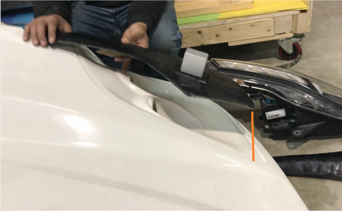

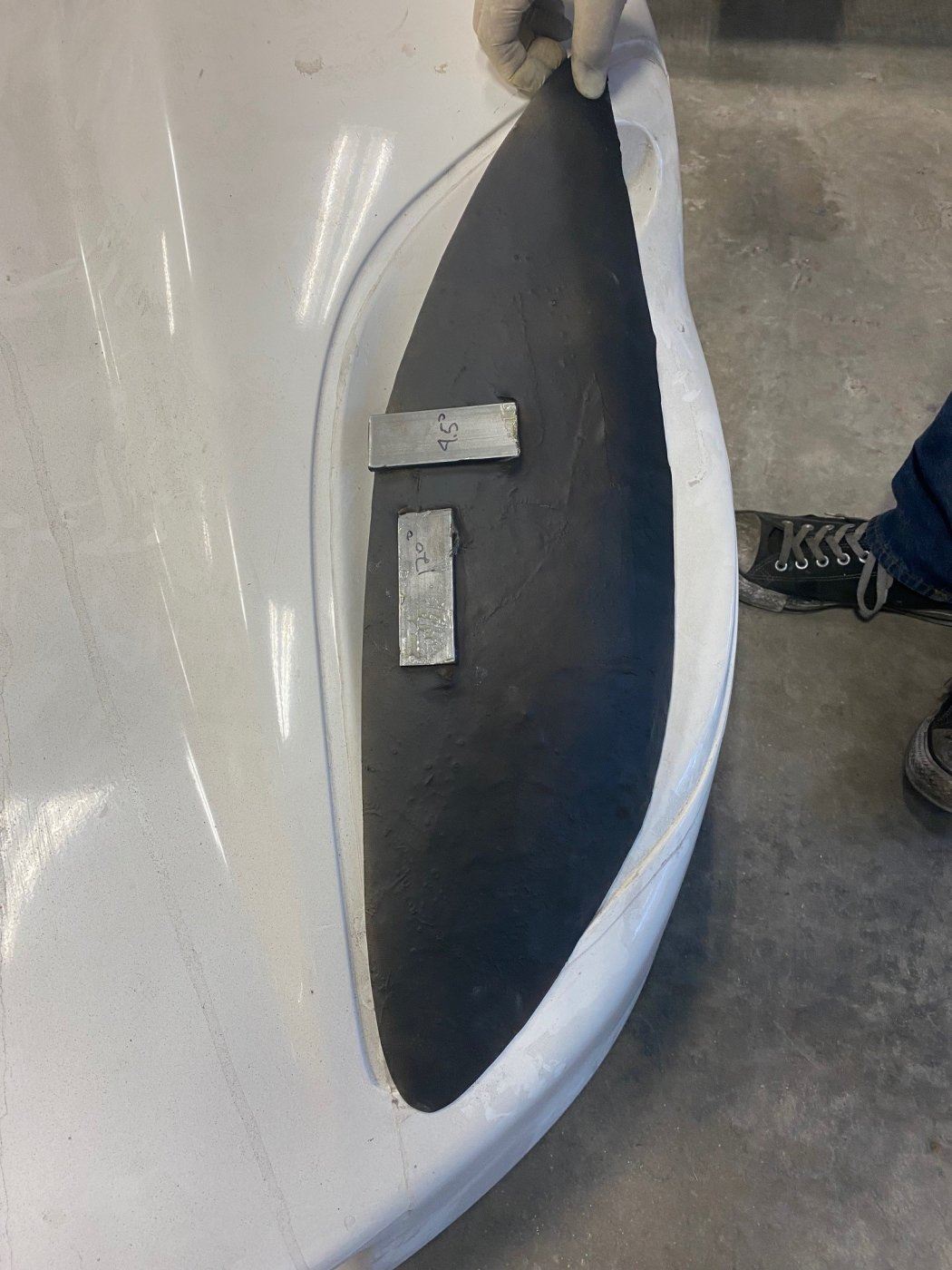

I've bought a bunch of headlights on eBay. To check the fit, I cover the lens with packing tape, wax it and then do a thin fiberglass layup. I had high hopes with several when I laid the shell on the body because the fit was good. However, I bonded two steel plates on top of the shell so that I could use a magnetic digital level to ensure that the orientation was correct.

However, when the correct orientated, the fit is a disaster as you can see from the orange line below.
It now occurs to me that a much easier way to check fit would be to bond two plates to one of the RCR polycarbonate lenes, place it on the car and record the pitch and yaw angles. It would then be a simple matter to bring that to any car and check fitment. No need to purchase the light and make a custom shell just to do a basic check. You could lay some cloth down if the owner were paranoid about a scratch. My guess is that I'd need to trim the part of the lens that wraps around the side of the car in case we find something that actually fits. I might have an extra lens laying around....
Thanks for showing me how you went about trying to see what fit. I may still just grab some cheap junkyard parts to see what will fit, I'm going to try to keep the factory stuff close to it's current shape and not redo the entire fender, but that may be what happens in the end.
