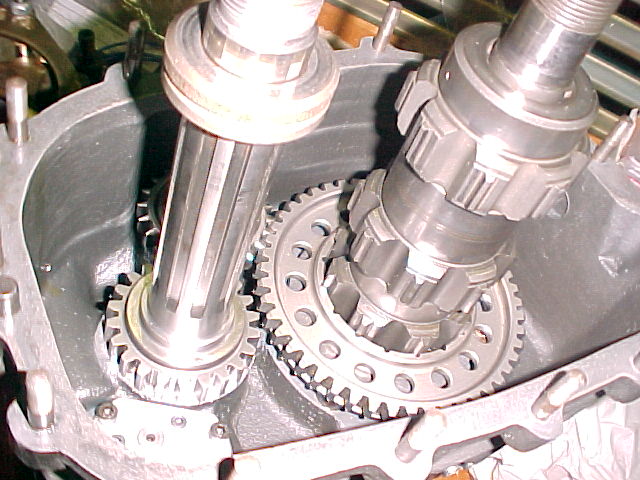

More pic!

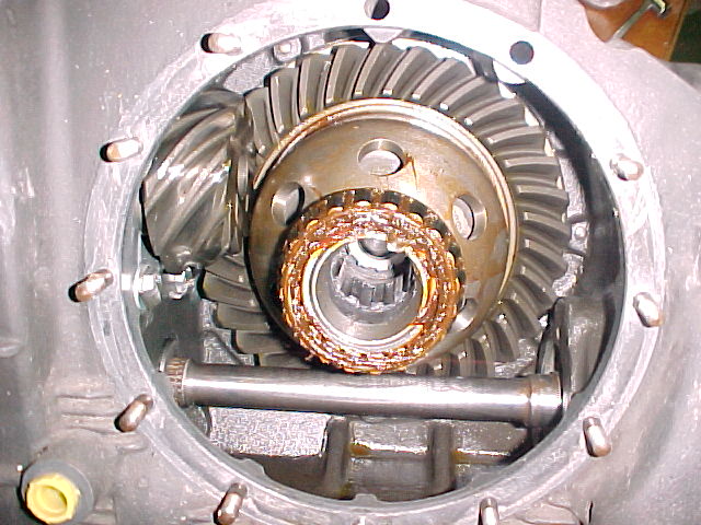

More pic! I found some old pic of inside an LG 500 just the difference is that the hub that carries the dogrings is gearcut to reduce some weight.
