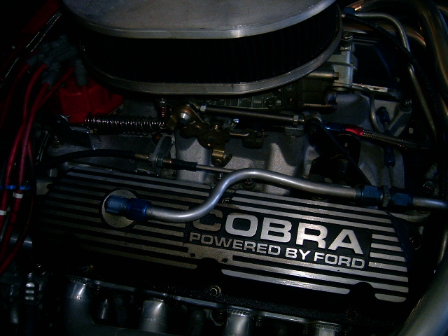

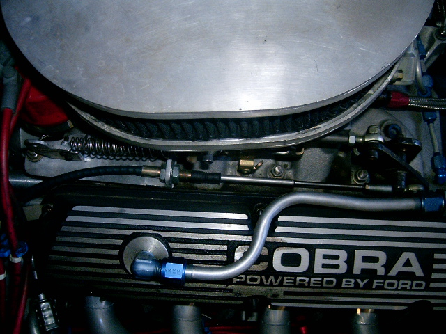

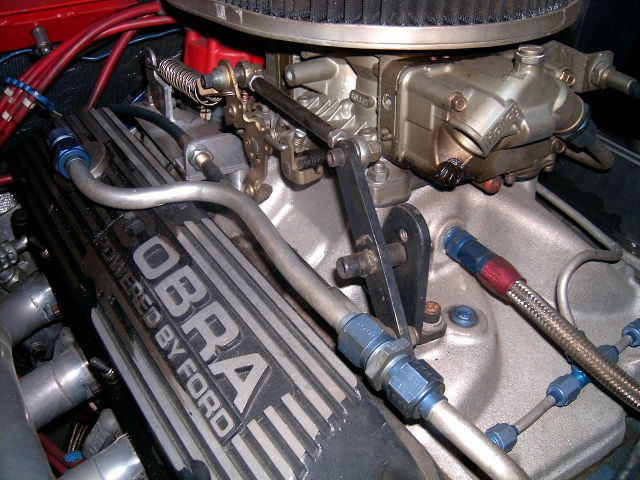

Here's mine on Betty. It's got about 20,000 miles on it, of which 3-4K is on the track. Never a problem. If you do something like this use the highest quality push pull cable you can fine.

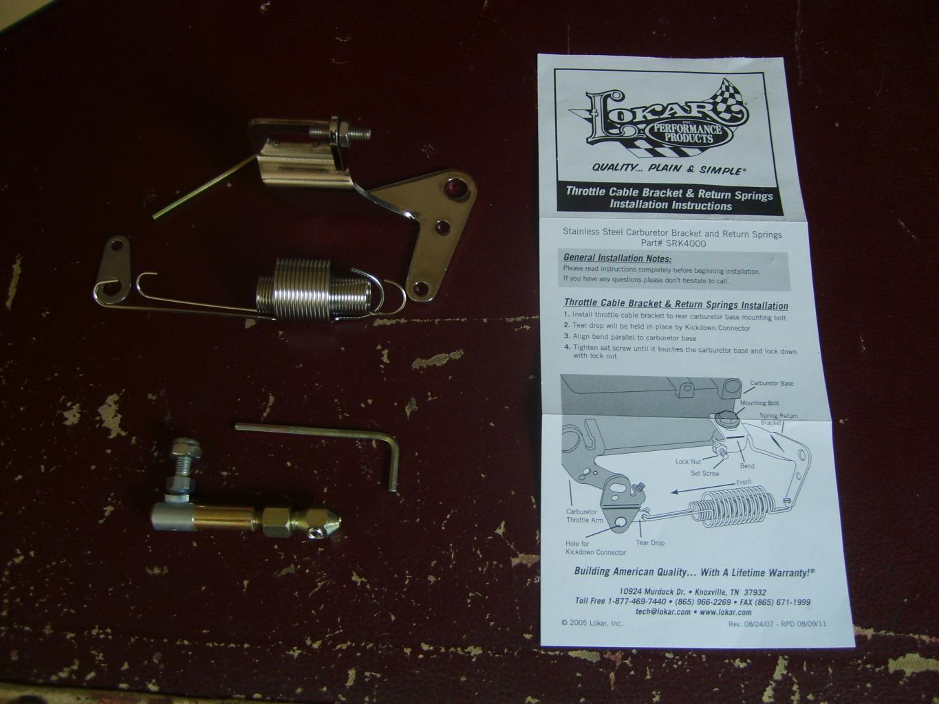

A big thank you for everyone's advice on this subject. I am currently in the process of going the Lokar route. The bits have arrived from USA, and am currently waiting for a new cable from the UK. This route seems straightforward and hopefully well within my capabilities. The quality of the parts looks good.

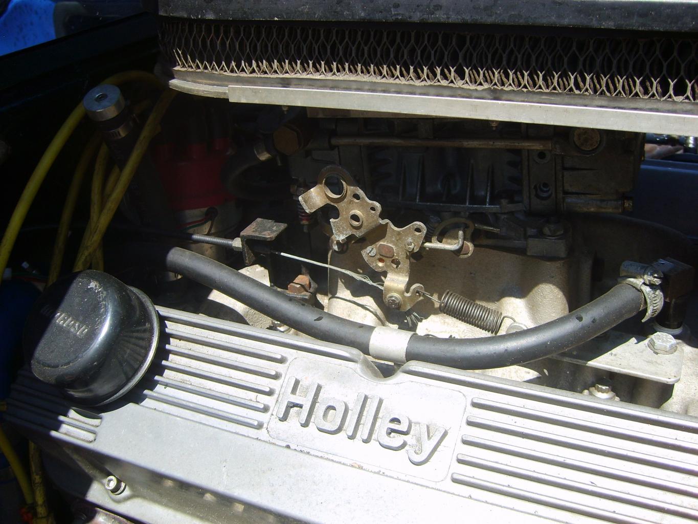

Attached photos show the current setup and the new bits. I know its pretty awful, but its been in place since I got the car on the road in 1994, with very little problems.
I will tackle the job after the Le Mans Classic, as I don't want to tempt fate beforehand.
Stephen
