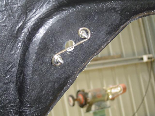

I have yet to master posting photos but i'll get some for you ASAP. On an RF car the dzus fastner retainers are held onto the rear side of the front clip with small counter sunk stainless screws with nylocks on the underside. Will post photo soon?

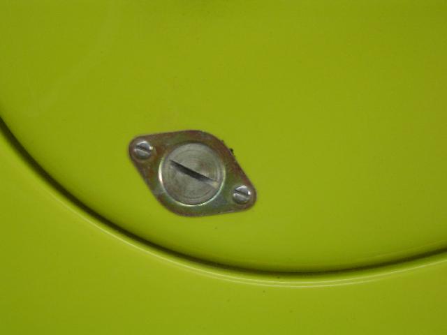

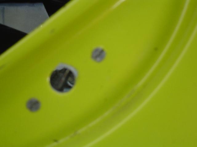

Ron Here are some photos. Hope these help!
First One: Outside of front clip

Thanks Andrew! That's just what I wanted to see!

Am I seeing something everyone else is missing? Looking at the final picture from Andrew up above - I'd recommend the following. Don't remount the whole assembly which require re-drilling, filling holes, etc), why not just re-bend the "S" shaped wire element to have the segment that goes across the hole in the correct orientation to align the external screw slot (so your tab is aerodynamically directed).
If you can't re-bend the existing 'wire', then buy some stainless wire of the appropriate diameter and make your own to suit.

Like Andrew, I had some reservations about the security of the 1/4 turn Dzus jobs. I had mounted them all & was a bit surprised at how easily they popped up. All the talk of high pressure under the front clip had me worried, so I changed them all so that the original Dzus mount plate was retained, but the core fastener was replaced by a simple 6mm c/s s/s socket drive bolt.
These run into nutserts/rivnuts in aly brackets under the clip & have proven to be rock solid (with the advantage that you can just wind them in as required so that you can align the nostril/clip & clip / windscreen frame surfaces perfectly).
Not 100% original to look at with the socket drives, but you could use straight slotted bolts (maybe 8mm) & nobody would know.
