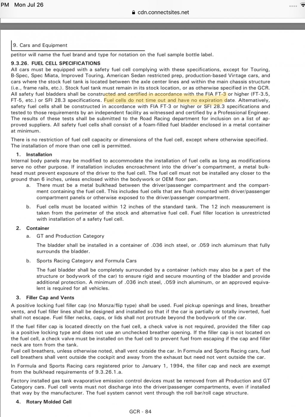

The SCCA has abandoned any notion of fuel cell expirations. While one could say that it falls back to the FIA Standard, the sanctioning body’s scrutineers only rule on the content within the GCR and Class rules as published by the SCCA.

On cars like these, many expiration dates are compromised by the length of time from the point in time when manufactured to the time of first implementation. Harnesses are another. If they sit in the cold dark box for 5 years, then installed - you could consider the count-down clock starting at that time - however - you’ll never get a tech inspector / scrutineer to look the other way and accept that..
