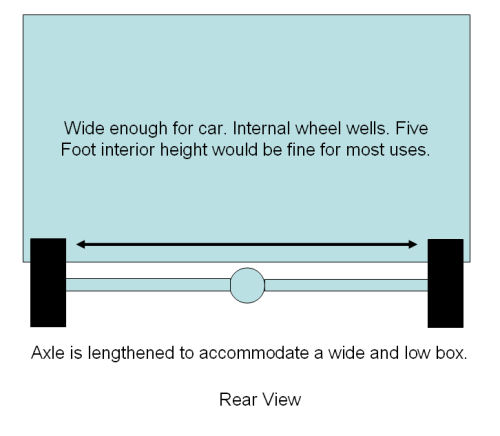

Here is what we need, built on a van frame, with a wide axle. The simple way to build these things is to elevate the entire box above the rolling diamter of the wheels, but that makes the damn box 3 feet off the ground. If we widened the axle and set the box down between the wheels, used some internal wheel wells, we could get 6 ft of width low to the ground to load a car. I bet we'd have a load height of 18 inches or so, which is useable with some real world ramps. That 3 ft height is not usable with real world stuff.
If built on a van frame or van cockpit design the box could go into the cockpit which would be useful for moving around, AC, music, etc.
I wonder if I could find a used F250 van and get an axle widened, then try this at home? 17 ft would be a mimimal length I think, based on the fact Jeff just bought a 18ft enclosed and it is tight in there. I could still build a bunk, tool box, and other stuff in the space though with careful attention to detail. I like this project. Will somebody fund it?:)

Thanks for the link but that one is not different from about everything else on the thread - the platform for the box would be 3ft off the ground and just about impossible to load a race car on without 25 ft long ramps. Of course that one down rollback and off load so could use short ramps, but it'd offload everything in the box too!!!!
What we need is like what is in the drawn picture, a box sitting the box down inbetween the tires to get the box floor low.
3600# would be enough for load I think since the cars are about 2200lbs. And those loads are recommendations, not points where things break if you go a pound over. My Lightning is only good for towing 5000 lbs. But don't tell it since we tow about 7200-8000 lbs around all the time.
hmmm 77.7" is center of wheel? Is that what DRW means? That would mean less than 6ft between the wheels then and not enough to load some cars for sure. Axles get widened all the time at various places though. I should measure the road and see how car we can open it up.

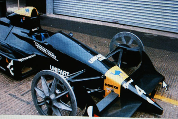

Ron,
One thing you might think about is some transport wheels and tires like the one below.
I know it would be a pain, but the car would then fit between the wheel wells. If you run pin drives it would be a lot faster to change out.
Just a thought.

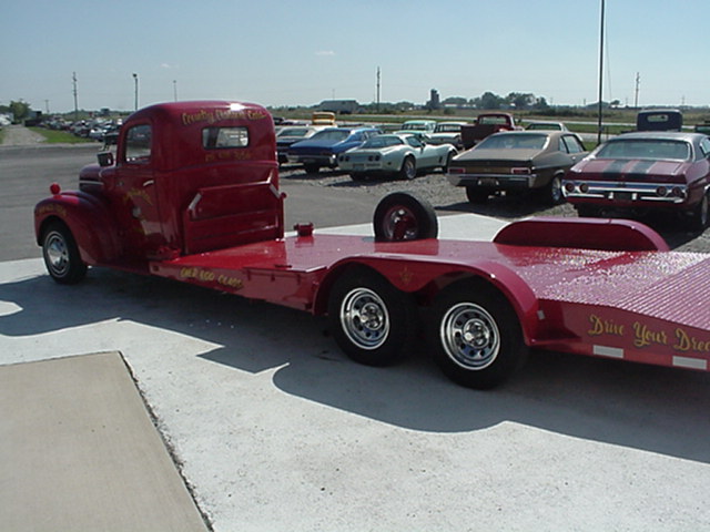

Ron, the only truck that I've seen that you can drive between the wheels is one of these. There was a company doing Toronado/ Cadilac front wheel drive conversions on later model Chevy/ Ford but I can't seem to be able to find them now.
Simon, that would be perfect! Put a low box on it, about 5ft high, and I'm looking for something similar. Is that one front wheel drive? Looks like it'd have to be.

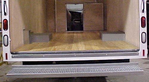

Ron,
Keep in mind you cannot exceed 102" overall width without requiring a permit. Yes, the 77" is the center of the dual rear wheels so add 12-14" each way to allow for the wheel/tire and clearance.
A cube van will have a deck height of about 28-32" with a low floor/wheelbox setup. That means you need to get the car over the wheelboxes where the angled interior ramp setup I referred to comes in. Or you could just race a first generation Mini and carry it in a long bed pickup! I do see guys with Legends cars in pickups.
All we need is 6.5ft between the wheel wheels and we can carry dang near anything. I think this completely doable without a 102" overage.
Those cube trucks, vans, straight trucks, box truck are all out - just too high.
Not only am I trying to get one that has a low floor, around 20 inches, I also don't want the truck to be over 7.5 ft tall overall or thereabouts.
Picky, I know, but I'm not the only one who thinks this is a useful piece of tool.
Ron

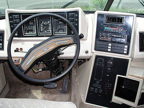

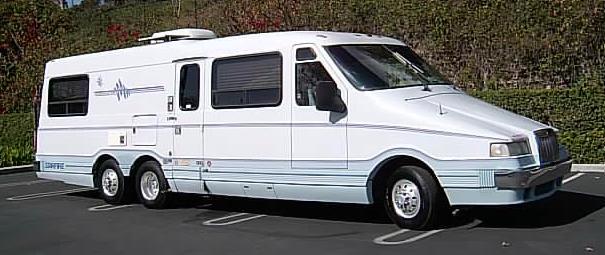

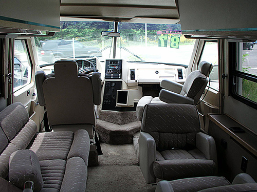

How about......I used one of these to tow P1116 to the 1989 GT40 reunion at the Glen.
Built on a Ford E350 stripped chassis, 460 V8 and C6 trans. Has an air spring tag axle for additional load capacity. You cut the rear open and either install a roll up door or hinge the end cap, install ramps and a bulkhead to close off the cargo area from the living room and VIOLA! Instant transporter.
Have the unit I used for sale (I don't own it) but it needs a full refitting, has not moved since 1997. Stored outside a restaurant so has a few rodents, etc. Generato (mounted up front in the extended nose) needs work but could probably be bought cheap enough to make rework worthwhile.
Rick
