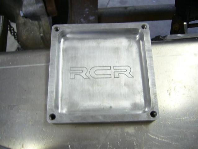

Sorry Ron. Here is what I am looking for. I need the measurements of this piece so it can be bolted in later.
Sorry Dean, I'd not seen that piece before - no wonder I couldn't figure out what was going on! Looks like it might make a cool ashtray too. :)

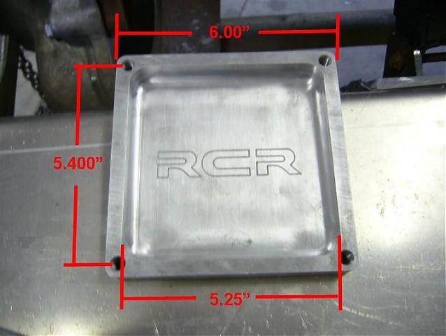

Dean,
In addition to Fran's remarks, see pic below:
