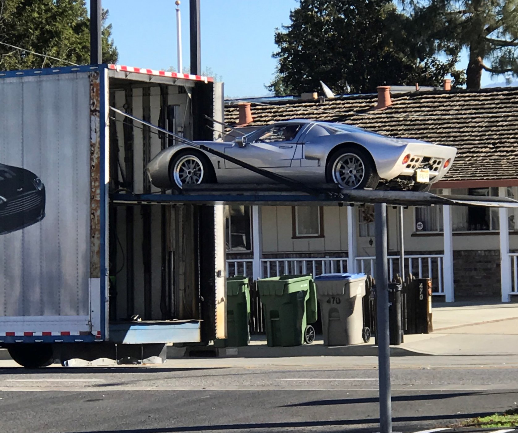

The car was loaded today in San Jose heading to Seattle, just in time for a major snow event. I was fortunate to have a phone conversation with Elliott Franklin of the Mustang Corral this morning. Elliott built the car for the original owner in 2007 and had a pretty good recollection of what was done. I had found an add for the car from 2 years ago that indicated Elliott built the engine and that it required race fuel. I was relieved that Elliott said it was a pump gas engine (10-1). My plans are to get the car fully inspected including fuel tanks, suspension and the rest of the important bits and drive it to local car events. Once Fall comes around I'm going to upgrade the brakes, stack injection and possibly ignition system. I plan on using the car for HPDE track days. My last car was an AMG GT R which handled great on the track but I was always jealous of the Porsches being able to brake so much later being so much lighter. I'd love to hear others thoughts on brake recommendations and suggestions for what my planned use is. I'll update this thread as it progresses.

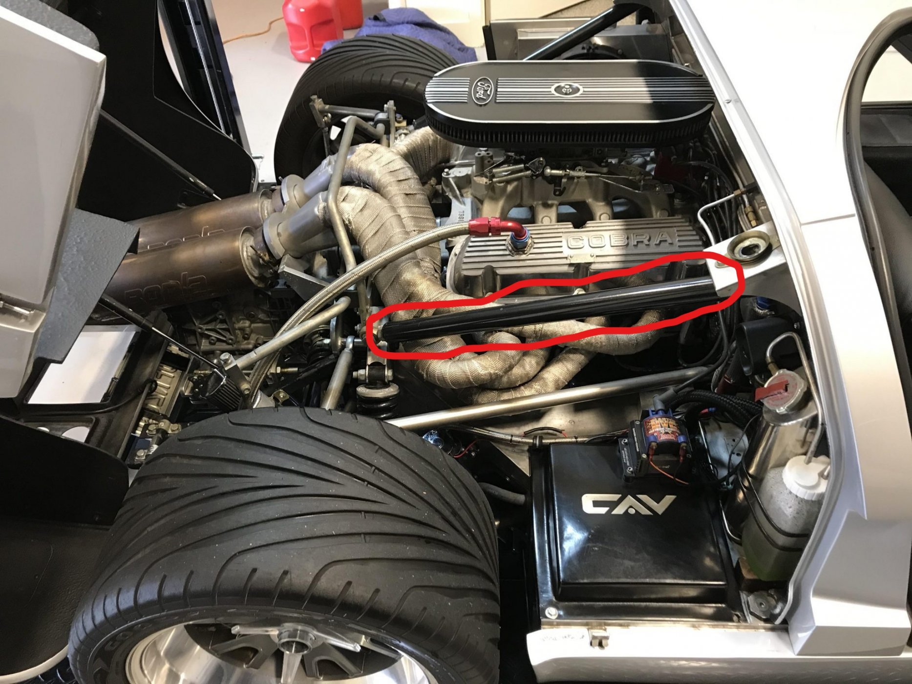

In the attached picture, note the bar in the red circle. I have not seen this on other CAV cars, anyone know its purpose? I assume its to stiffen the chassis or brace the shock mount?

About the bars in the photo, haven't seen them before but they do look braces of some kind. The CAV monocoque chassis is extremely strong, no additional bracing is required to stiffen it up.
However, on a real bad day, those bars might offer increased roll over protection by triangulating the tubular steel roll hoop built into the CAV GT40 firewall / bulkhead. Keeping the car sunny side up is always recommended
